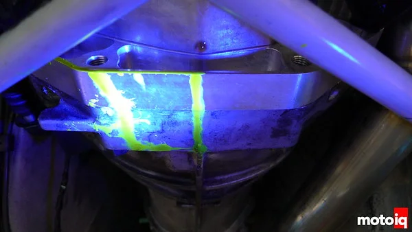

- go to home depot buy purple power degrease gallon and 2 spray bottles
- also , the most LUMENS and compact par 6 BLACK / UV light bulb u can possinly affford or find ?
- a drop light housing w/ cage , a trouble lamp for it if u don't have , or a stand alone Black / UV flash light type thing , and no skinny pencil one like a full size max lumens type please
- next up , find a specialty auto parts store who selld UV DYE packs for ENGINE oil , buy 3 small packs , there like ketchup size
- we need a HOT water garden hose tap ? utility sink or washer machine bib in mud room , must be a FULL ON HOT source no luke warm here ..
- nice garden hose and most important a quality spray nozzle w/ a jet feature
- first warm up engine only a TAD , NOT full operation temp to be clear ,
- turn off fj60
- FULL strength spray purple power all over any suspect rear engine areas from BOTTOM first , then from top to be clear or u will get in your eys and be hurtin hard
- let sit for say 10-14 minutes only
- get hose bled super hot water
- fully de greaser off / rinse all traces of engine oil off 100% ! , if your not sure here , do a 2nd round of above to be certain
- next up blow dart compressed air dry all the affected area of rear of engine dry dry as a bone ..........
- this is crucial step !
- now the PHUN part ...........
- install all 3 UV OIL DYE packets to a confirmed full 8.5qts crank case of oil ,
- why 3 u ask ?
-n because the uv oil dye is for a small 4cy engine 3-4 qts only , we need full strength results H55F FAST !
- now drive your truck normally maybe a tad hard to make it drip oil like all your above well documented tech outlines //////////
- at the First sines of a seap drip or leak , stop and get back to shop ,
- plug in the MAX lumens UV black light , preferibally in shop with all shop lights OUT dark !
or
at night time . / dusk .....
- your mystery leak will revile itself if you follow the INDIGLOW trail to the source
- oh i forgot , buy a professional 3 pc mirrors on a telescope stick kit from advance or crap-boys , the tools asile will have lisle or the pre brands
- u WILL need these i guarantee it
u will see this : or the like may be lumenesant yellow or day glow green u know like a PHISH concert on fall tour ........
this short tech video peter , sorta best relates to your symptoms
my prescribed steps by steps are exactly how i smoke out pesky oil leaks like u have going on , i have a 100% Success arte using this T-TEN Methods i learned in tech training years ago
- oh i never wore UV rated safety glasses , but u should , i will now that i know ? :cool: :beer:
i hope you find it
