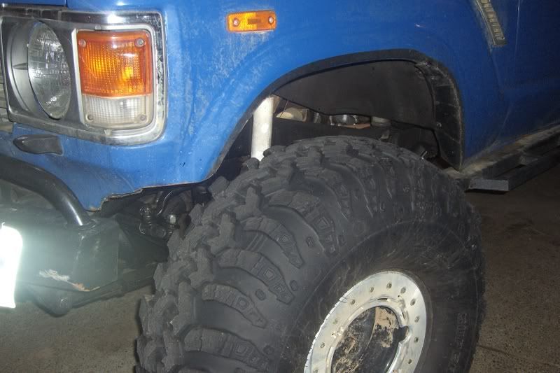

Edit: Broken, you have any close-up pics of the cutting you did to clear your Iroks? I need to do some of my own when I go with the 38's or 39's.

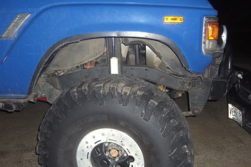

Front cut although I need to do more that the stock springs settled. This was before the settled about 3"
back when it was SUA and 35s but the cut was similar:
lemme see if I can run outside right now and snap a pic with the springs settled.
yeah I wanna see how you did the perches onto the frame....
mo' pics although the recent "trimming" was done on the trail with a set of dull ass tin snips.... havent washed poor Petra since then either. I plan on cleaning up the cuts (and wash it) when it gets a little less rainy and cold and I finish a couple other things first.

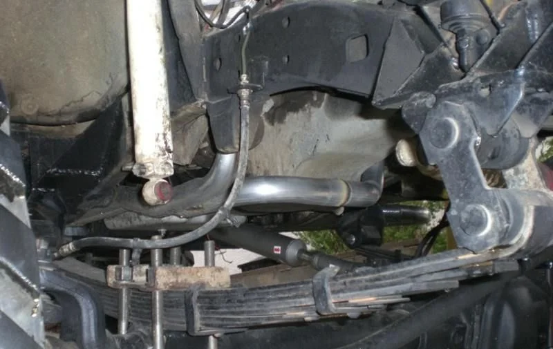

I'll snap some more pics tonight. In this pic, you will see that the outboarding was triangulated to the frame (I used all 1/4" plate "borrowed" from Mace). I did this to spread the torsion load out along the frame. With the Dodge front I think you will only be outboarding about 3" so you probably won't need to go as far as I did. Let me know what other pics you want. There are some pretty clear pics on the first page of the back of the spring.
I think a linked front would be nicer, but I did not want to drop another $1k+ on this thing for links, shocks etc..
