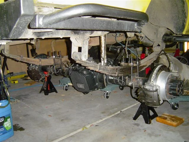

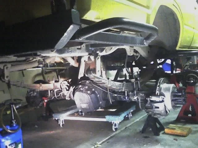

I bolted up the sterling last night... can you say BEEFY?:
We need to trade diff covers ;)

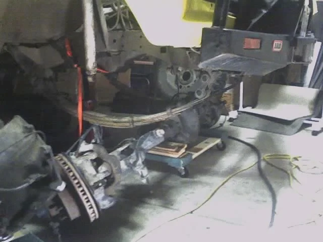

outboarding pics

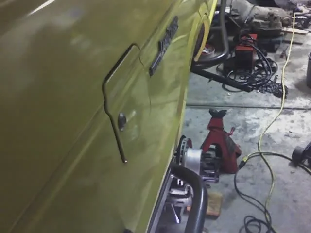

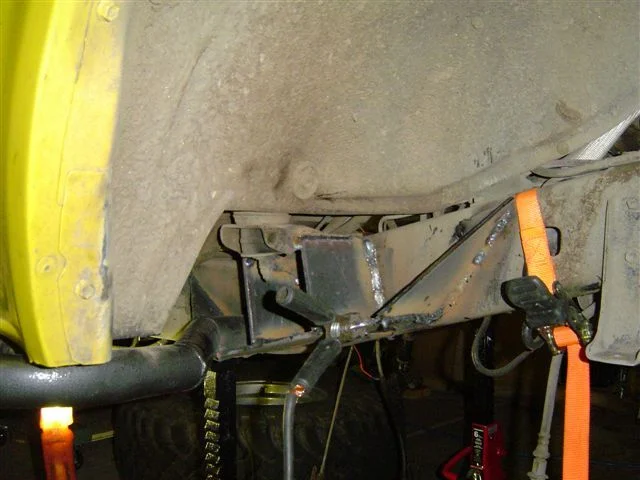

Heres a few pics of the beginning of the outboarding process. I have to outboard 4.5". I made the section I outboarded long to hopefully sprea the torsion load accross the frame. its all 1/4" plate, excuse the overhead welds.. :frown: I was having trouble filling the chamfered edge & still get good pen, they'll look much better after some griding & painting :rolleyes:
Let me know what you guys think... I'm adding some more gusseting to add rigidity.

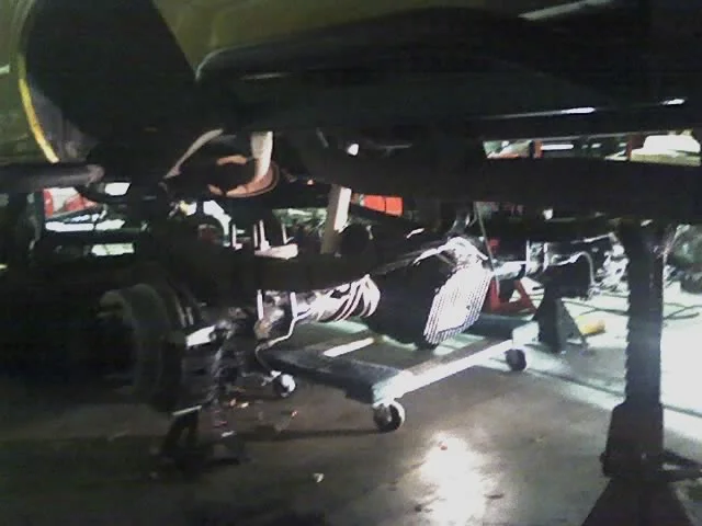

I also thru in another cleare rear axle shot for posterity :cool:
Oh yeah, I've been using my new Mitech plasma and once I got the hang of it there is no better tool for a project like this... it will cut 1/4" with little clean up at about 2-3' per miniute.... awsome & they are only $430 on Ebay shipped!
