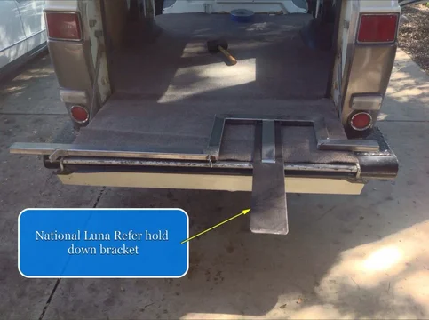

Everyone is so diligent about sharing there projects, I figure I should see if anyone would enjoy this one.
My goal was to be able to secure my refrigerator, have it easily accessible but not have to fasten it to the floor. That way my cargo bay has no permanent encumbrances.
Very interesting! My set up is similar, but haven't gotten to the frig hold down yet. I'd like to make a slide out and like you not drill into the floor.

Great idea on the easily remove-able bracket for your fridge slide. I was having similar thoughts on how I was going to mount mine in the rear of the pig and think this is an awesome way to go. Thanks for posting and the great idea!
