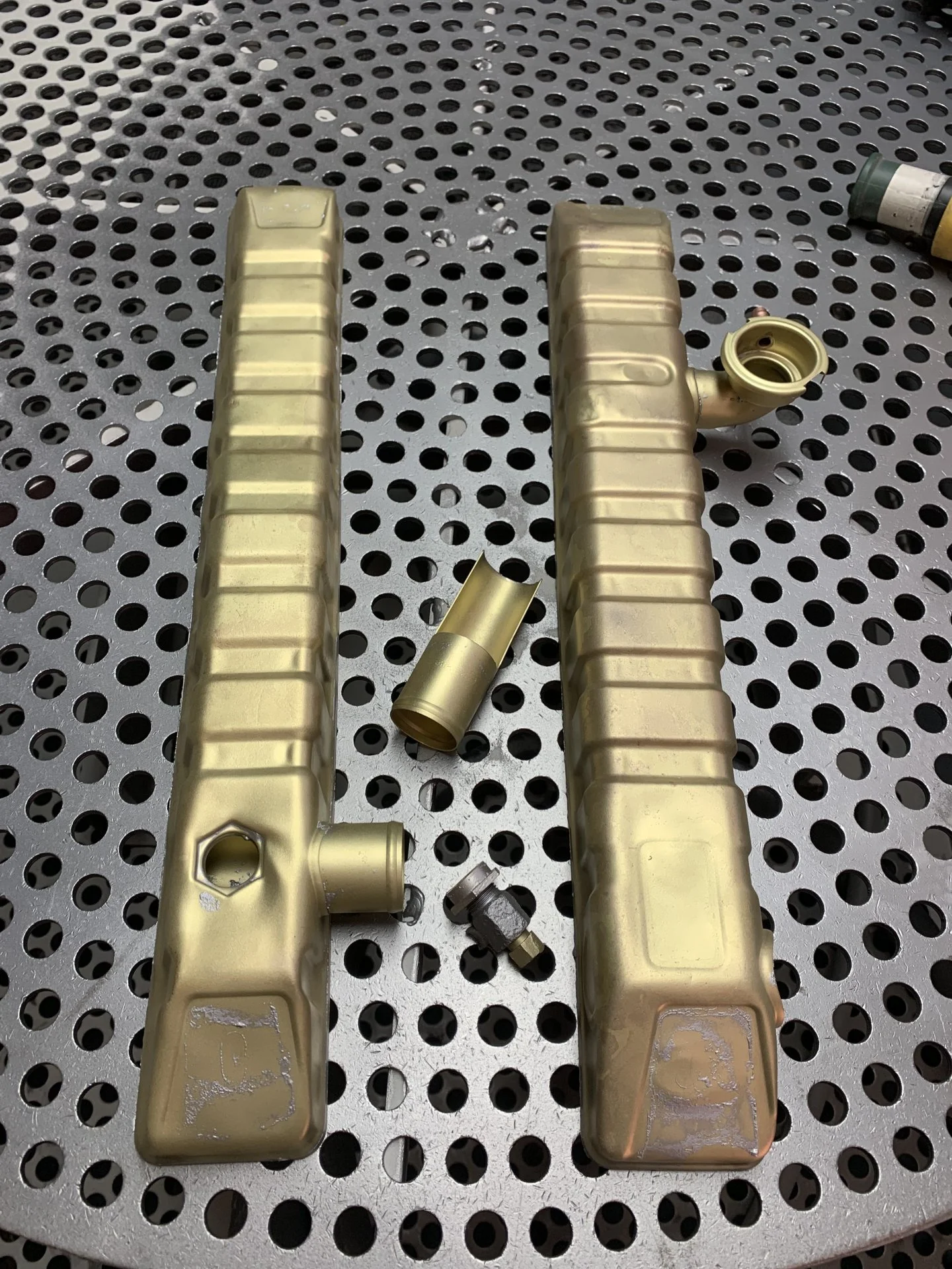

Best shot i got
This is all that’s left when they disassemble the radiator. Have you tried another shop? I’d have a hard time believing it was too far gone? Unless the side straps are rotten what’s to go bad? The tanks are brass.
I have to agree here. A good radiator shop can fix just about any radiator. Find the oldest shop in town. Preferably with old people working in it.

This ^^ is wonderful advice, I had first my gas tank & then my rad done by the old boys locally, and wasn’t that pricey really.
