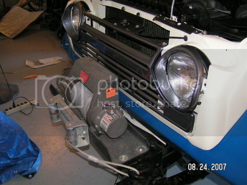

Sometimes its the little things.......
Winch

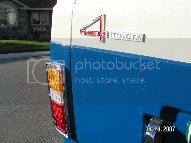

And emblems

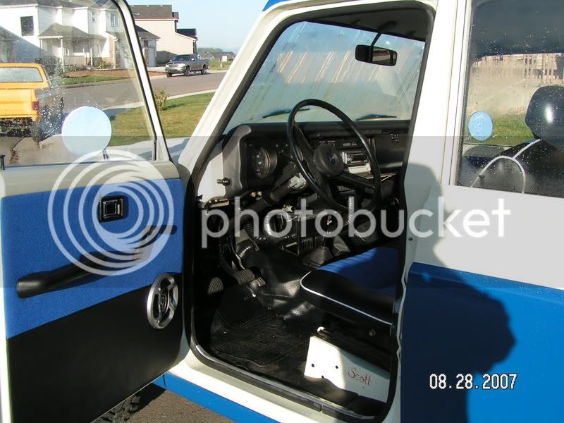

you have done great work on that truck.. the little things make a huge difference. are you going to paint/touch up the shifters?
also, are the speakers mounted to the door or the panels? I dunno if the panels are cut around the speakers b/c in on shot they are mounted directly to the door. just wondering. keep up the good work.
What kind of glue are you using on that insulation on the floor or are you just loose laying it??
Yeah, I will touch up the shifters...I missed that somehow..
And the speakers are mounted inside the door panel to the doors, then the covers mounted over the door panel through to the door, to give it a solid and clean look. I installed them before the door panels to make sure they line up right.

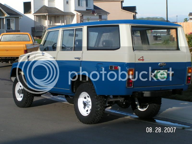

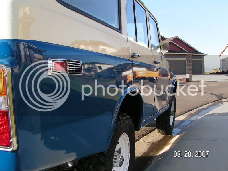

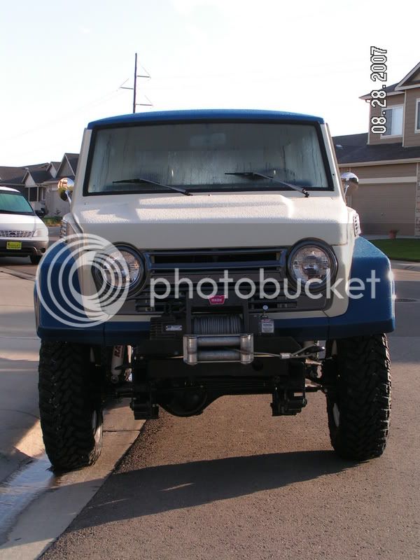

Tomorrow is D-day. The pig is ready. The owner and I took it down to Windsor to get new rims and tires. Kinda its maiden voyage/extended test run. Ran great, couple rattles exposed themselves. I will button up the rattles, fix the washer bottle leak, and call it done. Couple of parts are still out on order, slap them on when they arrive. Pics tomorrow, for the visually deprived. BTW, the new wheels set it OFF!
PICS!!!!
