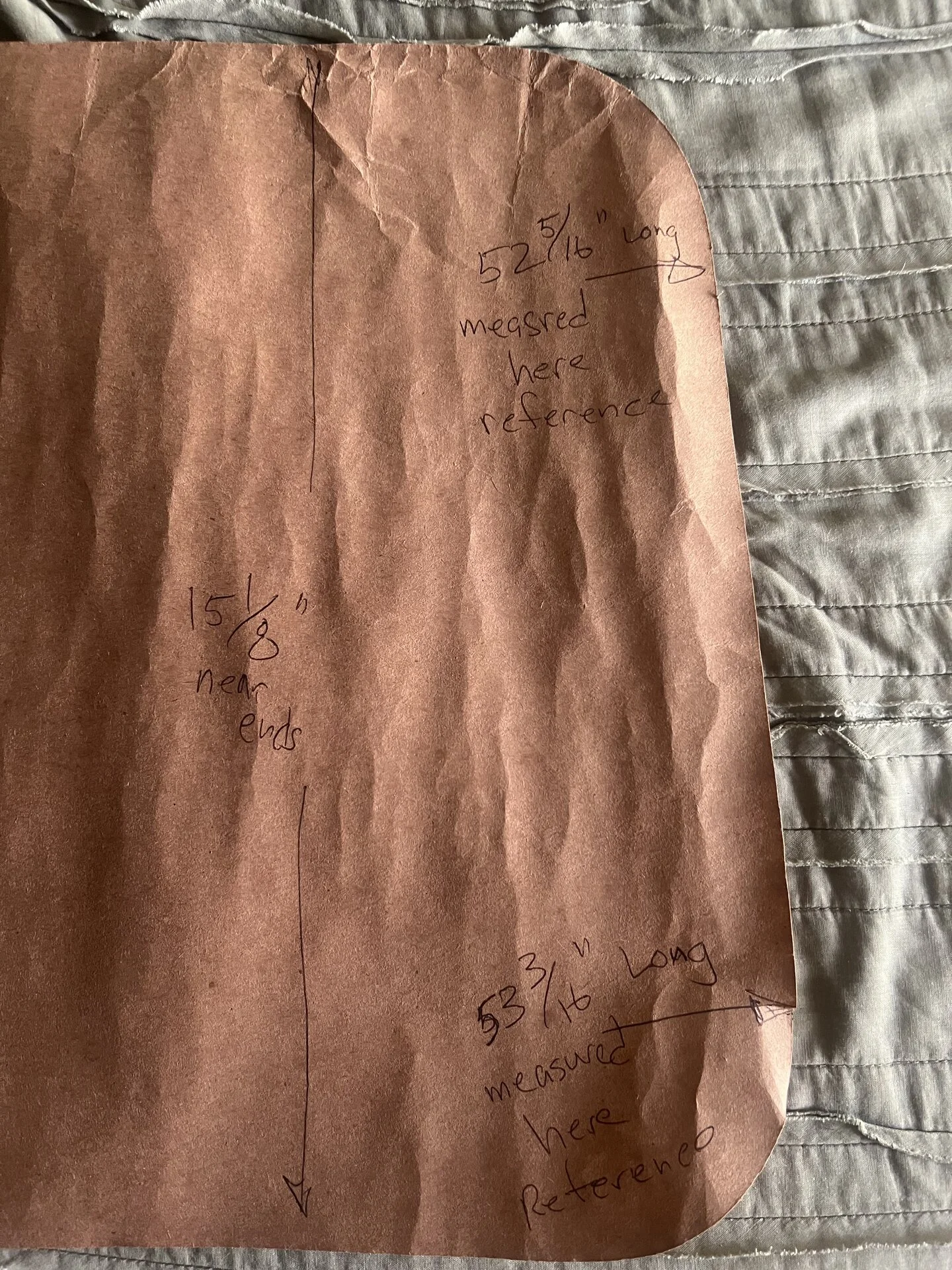

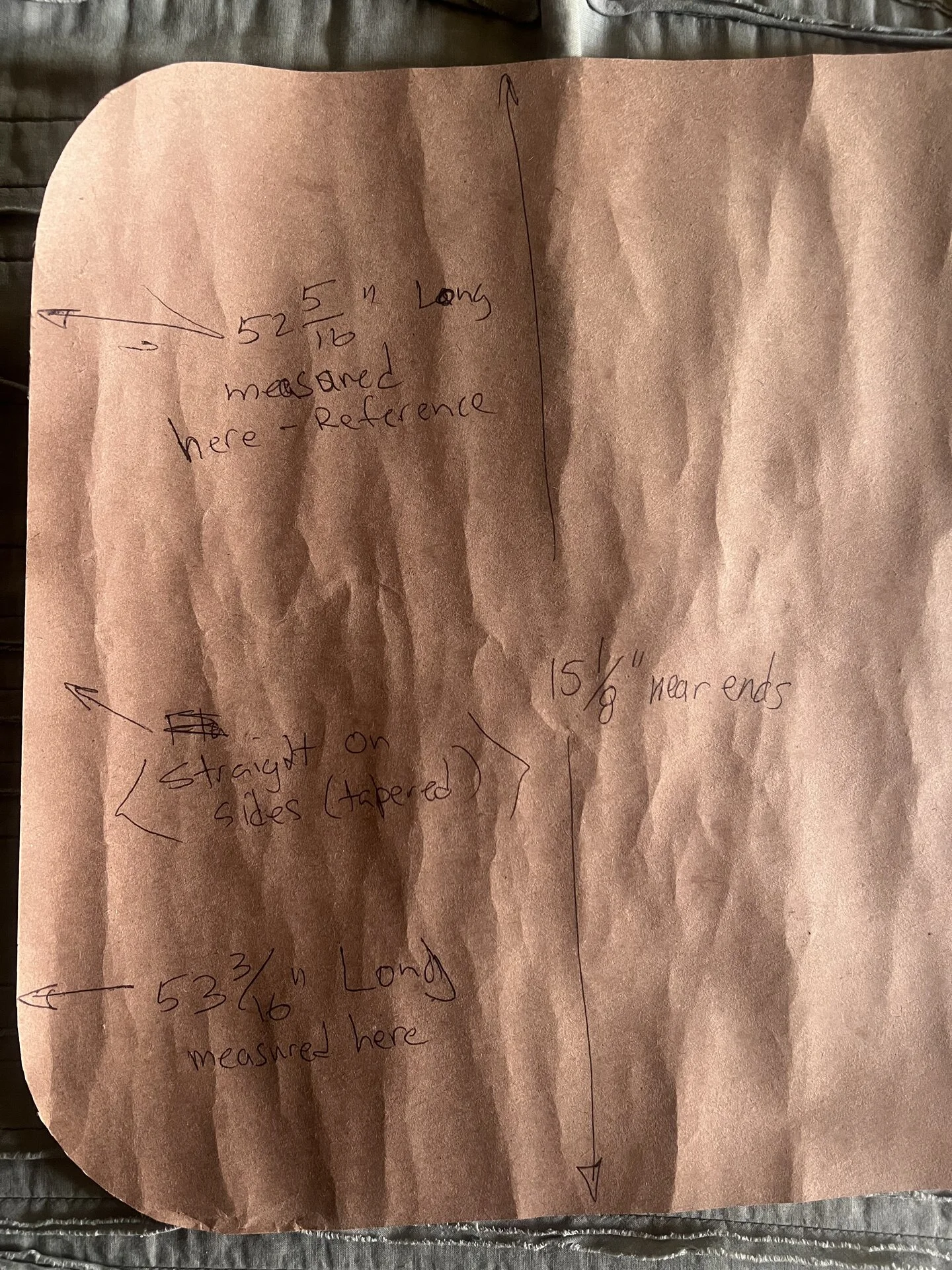

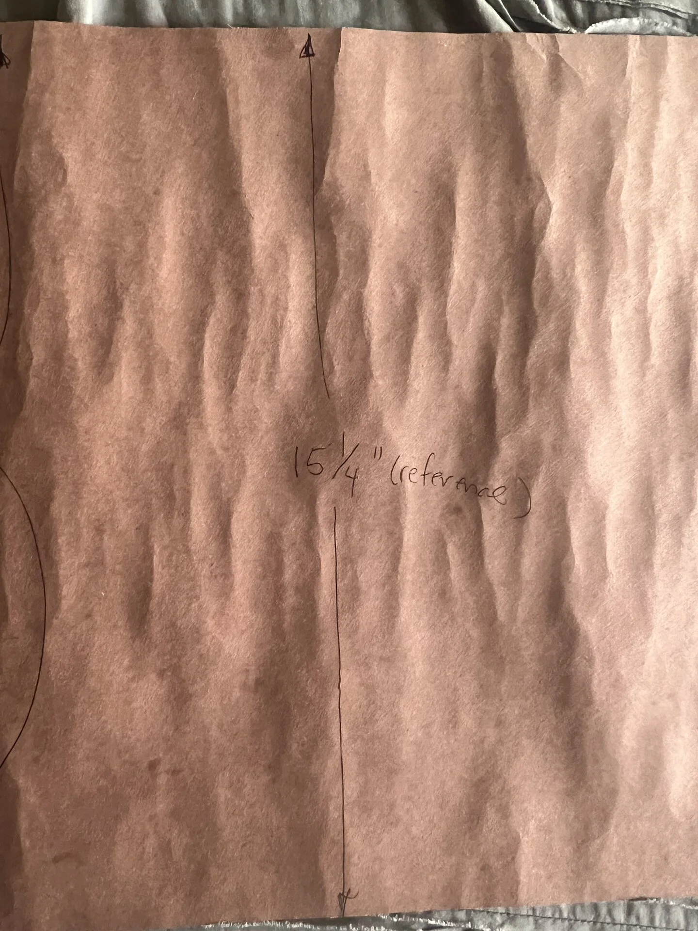

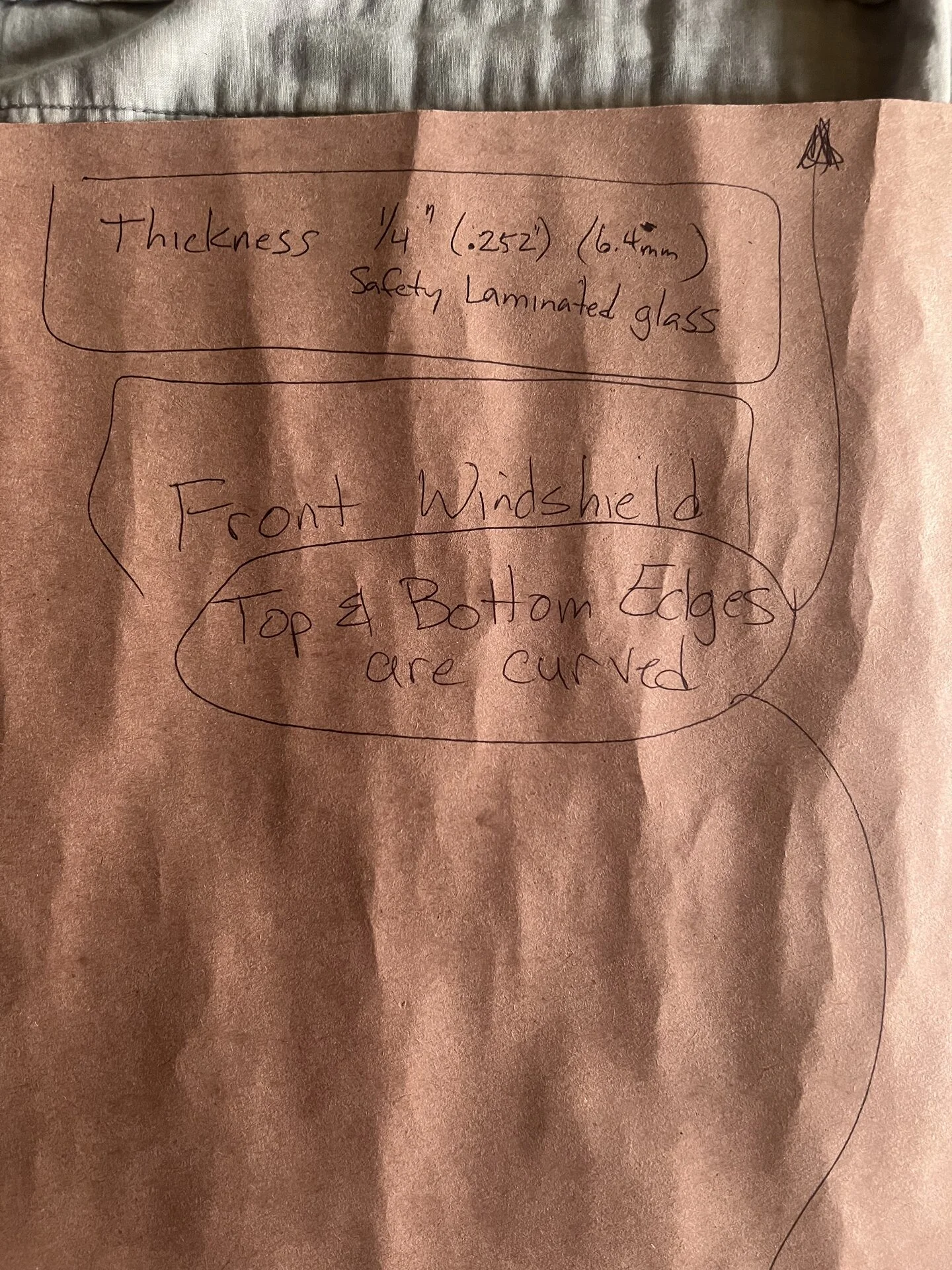

@OhItsNotAJeep- I can help you out. I will make some paper templates of the windows for you. I’m finishing up another project but I can get to this in a few days.

xtremeVA sent me some paper templates. I couldn’t get a full photo but ive attached the measurements on the template. Was easy for the glass maker to follow.
Just be careful of sharing templates. These bodies were assembled by hand and may not be identical to each other. Just double check fitment of template allowing enough space for the thickness of the windshield rubber.
