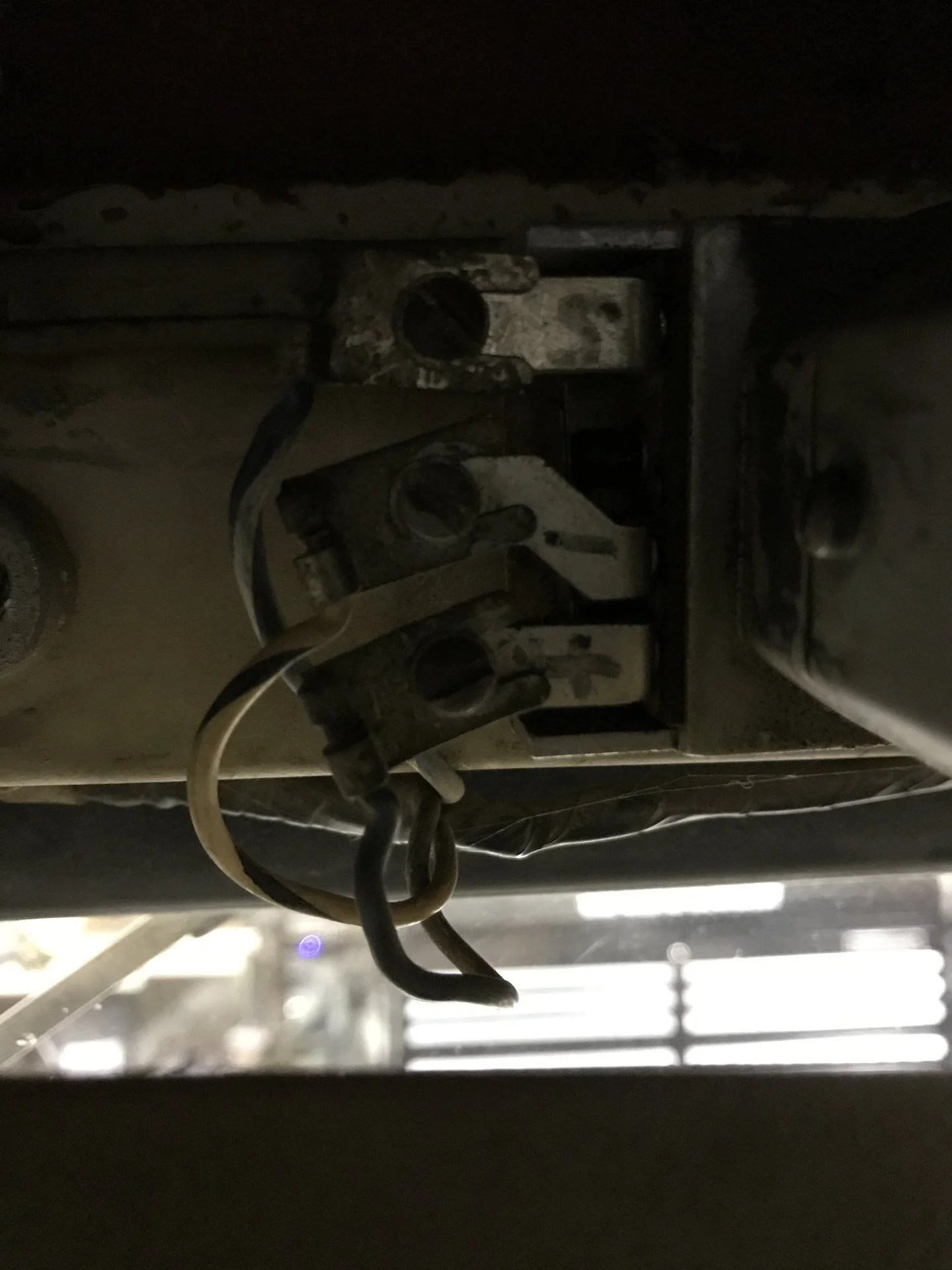

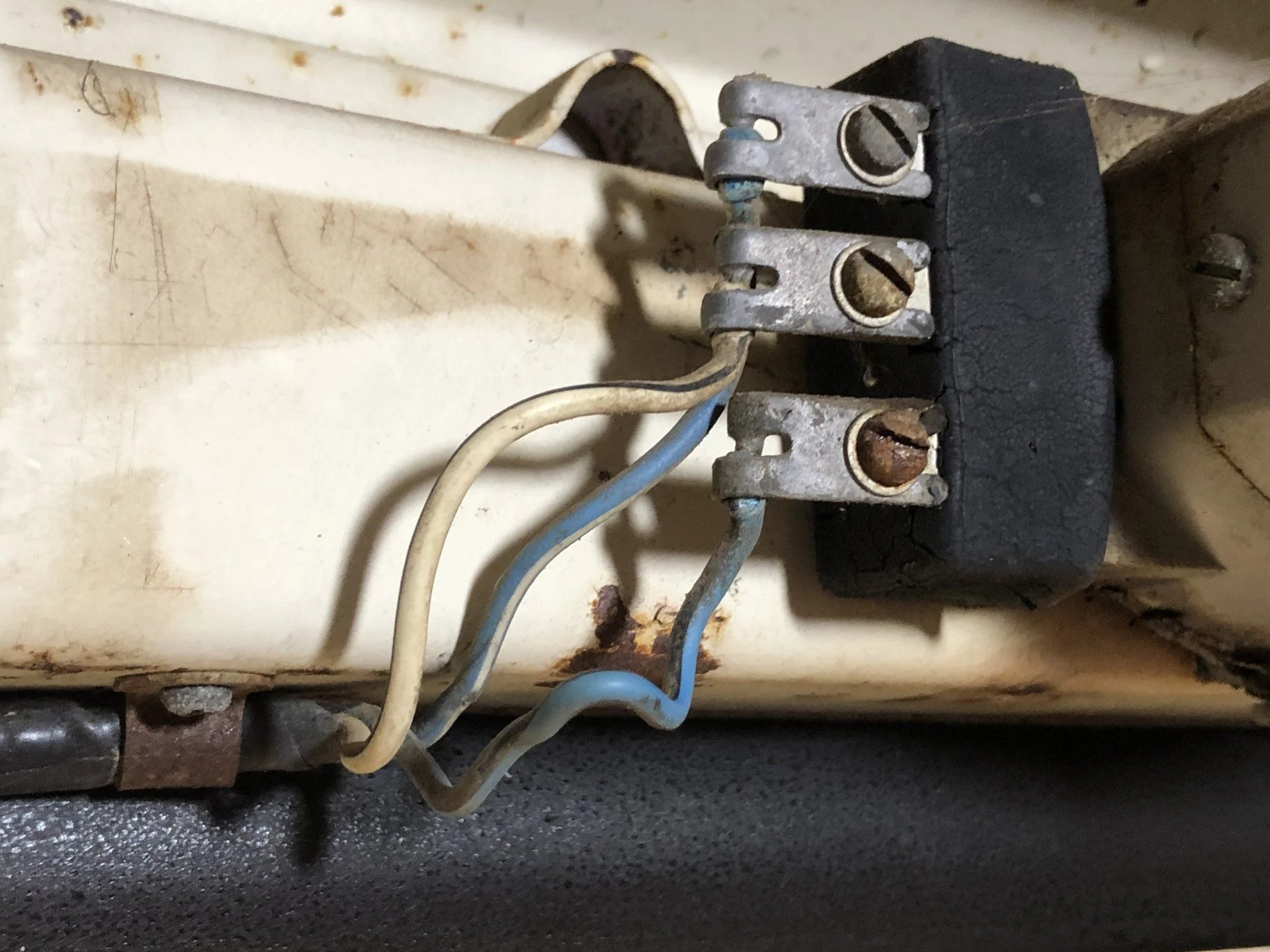

One of the 3 wires is PARK. I think it’s the bottom one but I’ll have to check. These other guys probably know off the top of their head.
1921213
Top Blue/White: 12v from wiper switch
Middle white/black: Ground
Bottom blue/black: 12v from key
