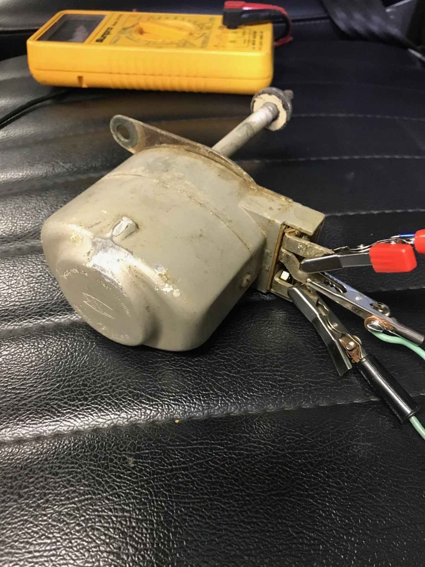

Next I hooked it up with long jumper wires (to the drivers side wiper motor) as a third wiper motor to see if it would park...
1925746
The wires are as follows:
Top wire (Blue with white stripe) = Switched power (12v when the switch is on). Mine is connected to battery power and did not need the key on.
Middle wire (White with black stripe) = Ground
Bottom wire (Blue)= 12v hot all the time
1925748
Luckily it worked like a charm. The other motors stopped when I turned off the switch but this one kept going and then stopped. So I took a closer look to confirm the park function operation and parts involved....

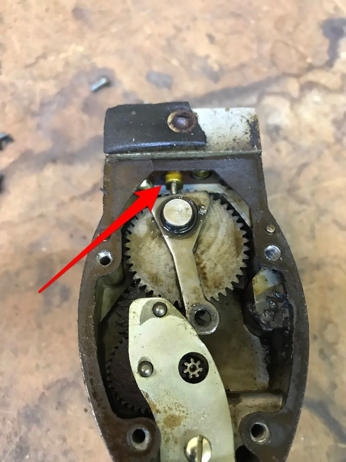

The parts are:
Plunger/pin
Copper plates with contact
Switched wire contact point

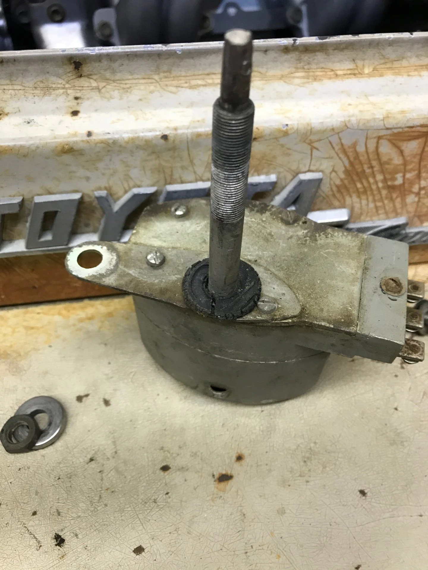

Here's the plunger pin on the inside of the motor. It is spring loaded and drops back towards the cam until it is pushed out towards the copper contact plates...
1925769

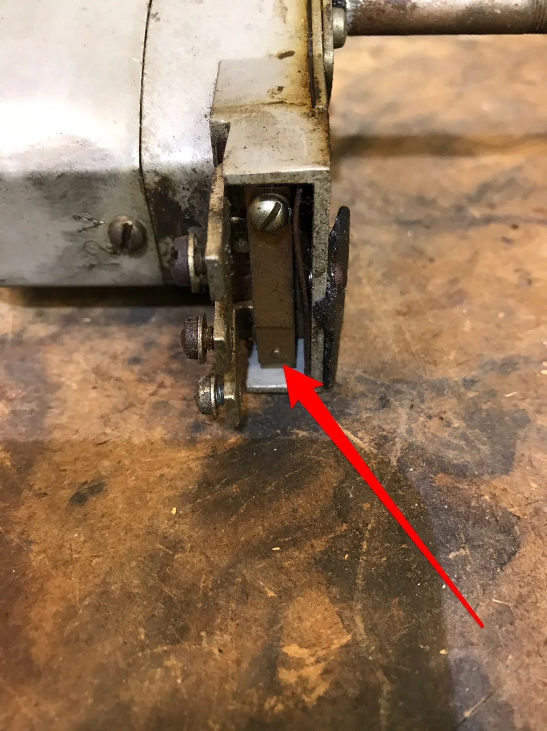

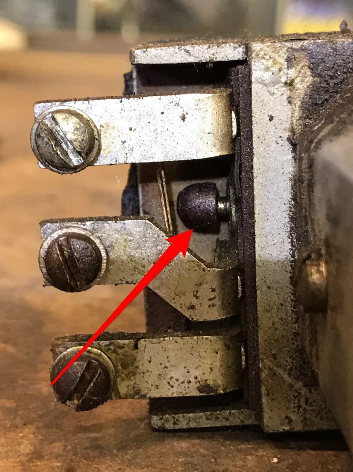

This is the plunger on the outside of the motor that the pin pushes into the copper plates.....
1925770
You can see on the example above that the plates are bent and don't rest up against the plunger like they should.

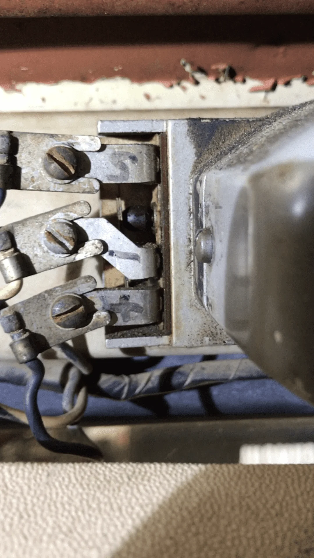

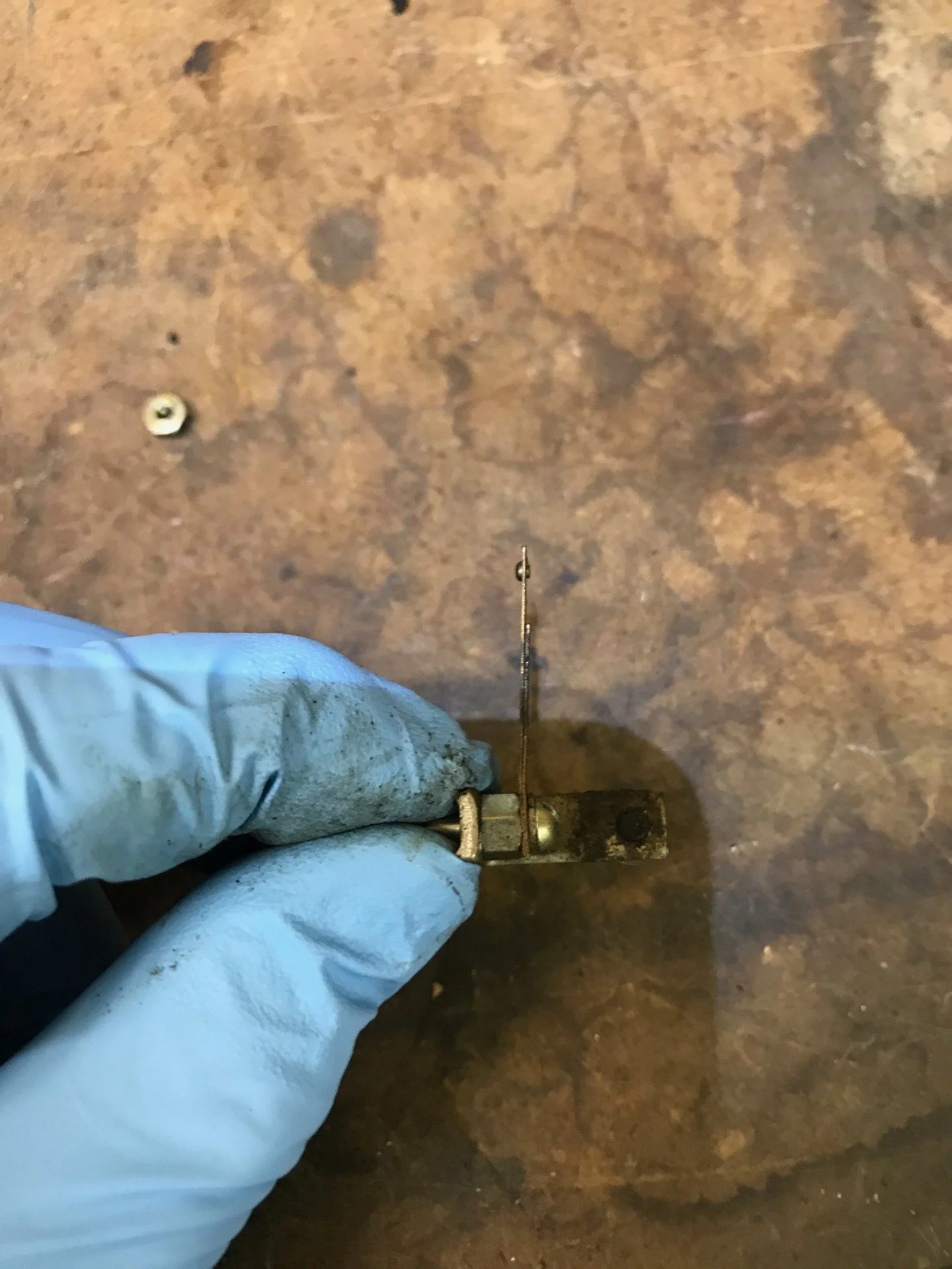

These are the copper plates that are bolted to the motor and flex as the plunger moves back and forth which in turn contacts or breaks the contact with the top (switched) post. On the underside is the contact point...
1925778
One of my wipers had a bent copper plate. All it took was bending the plate into position to get it to work properly. I chose to exaggerate the bend to be sure the contact was made. When I initially bent it back to straight it didn't hit the contact point so I opted for an excessive bend. This may be due to a worn plunger?
Original bend in the plate. The bend was angled away from the contact point...
1925786
This is the plate bent towards the contact plate...
1925790
I cleaned up the contact points and put it all back together and this one worked!

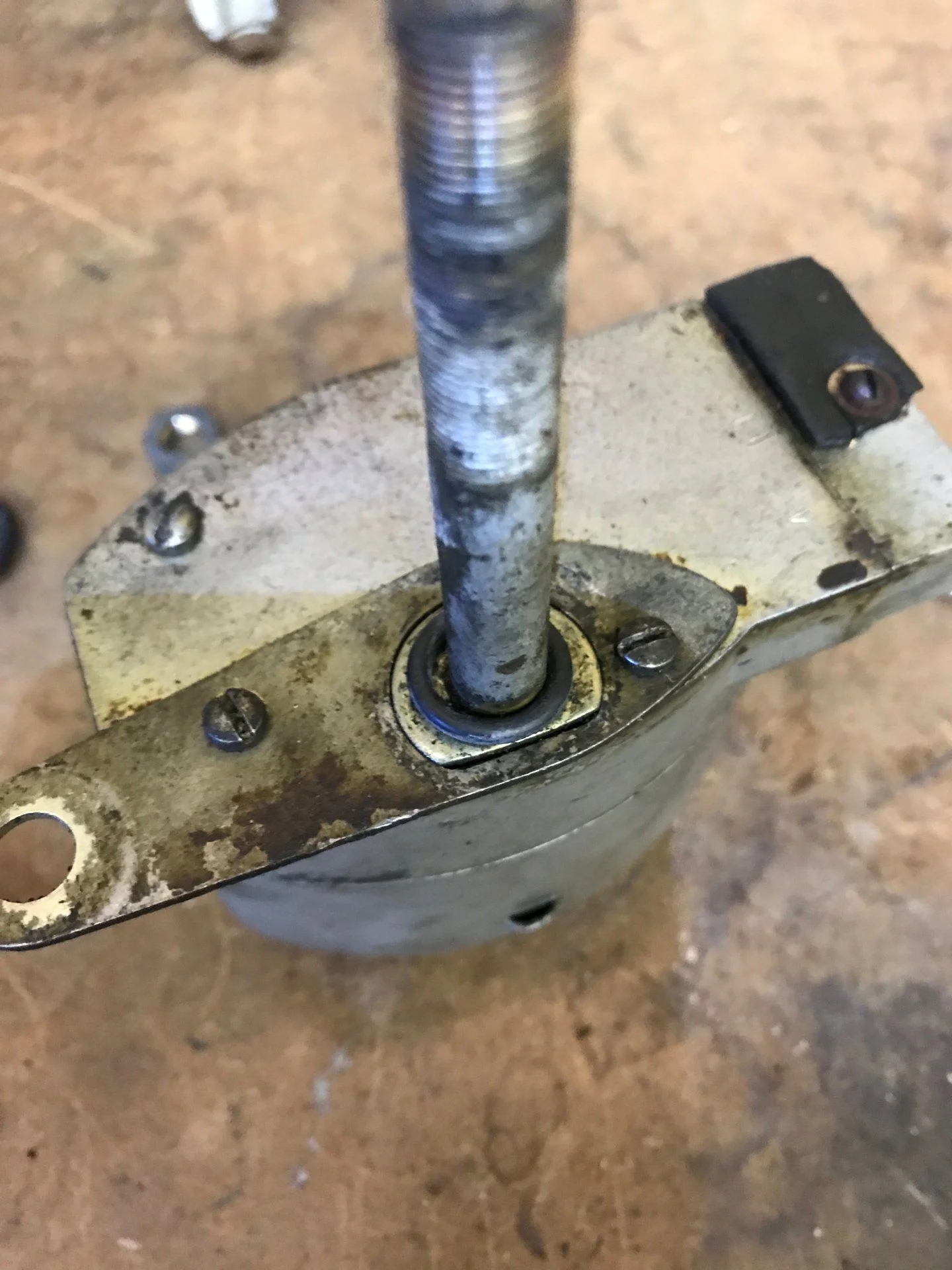

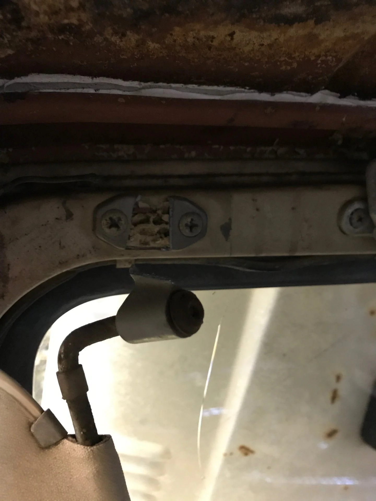

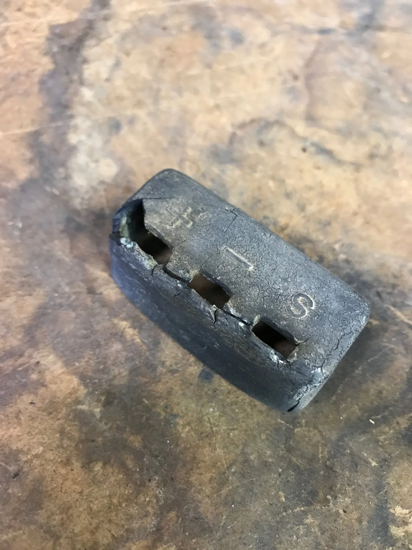

The rubber grommet that holds the motor away from the windshield disintegrated as soon as I pulled the motor so I used a small o-ring as a temporary bushing until I can source something closer to original.
1925792
I think the rubber washer on the outside of the windshield that the wiper shaft retaining nut holds on will work but I need to see if they are available anymore.

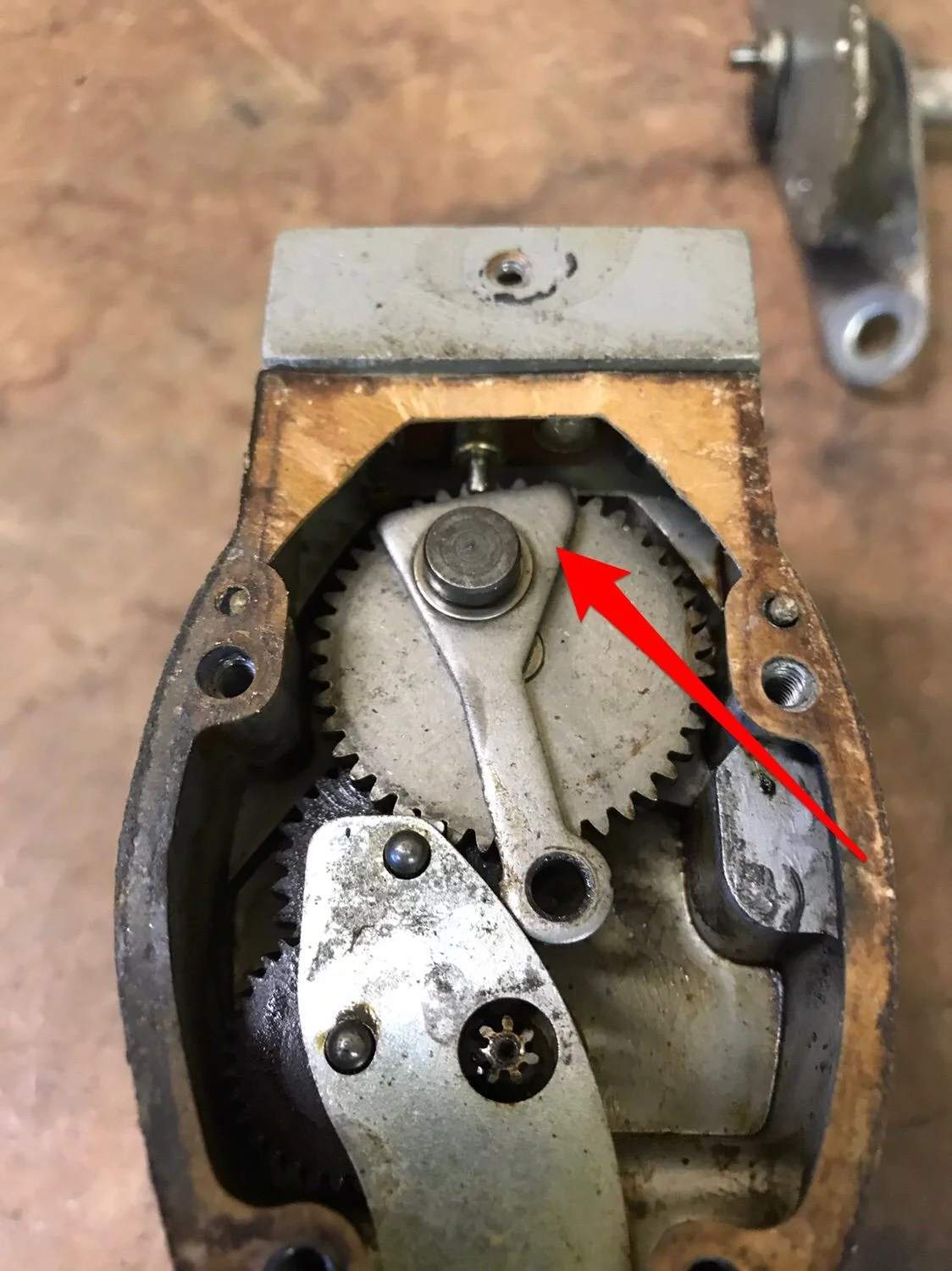

I next turned my attention to the passenger side wiper. When the switch was turned on and the motor ran the plunger did not move.
Once pulled apart I could see that there was quite a bit of the goopy grease stuck to the cam on the inside. This was too much for the spring to overcome so it was stuck in the "out" position. A quick removal of the grease and exercising the spring and it was back in business. It returned to the normal position when the internal cam moved off it and pushed out towards the contacts when engaged by the cam.
This is the cam that pushes the plunger pin as it rotates...
1925798
This is the rubber grommet I mentioned on the initial post...
1925799

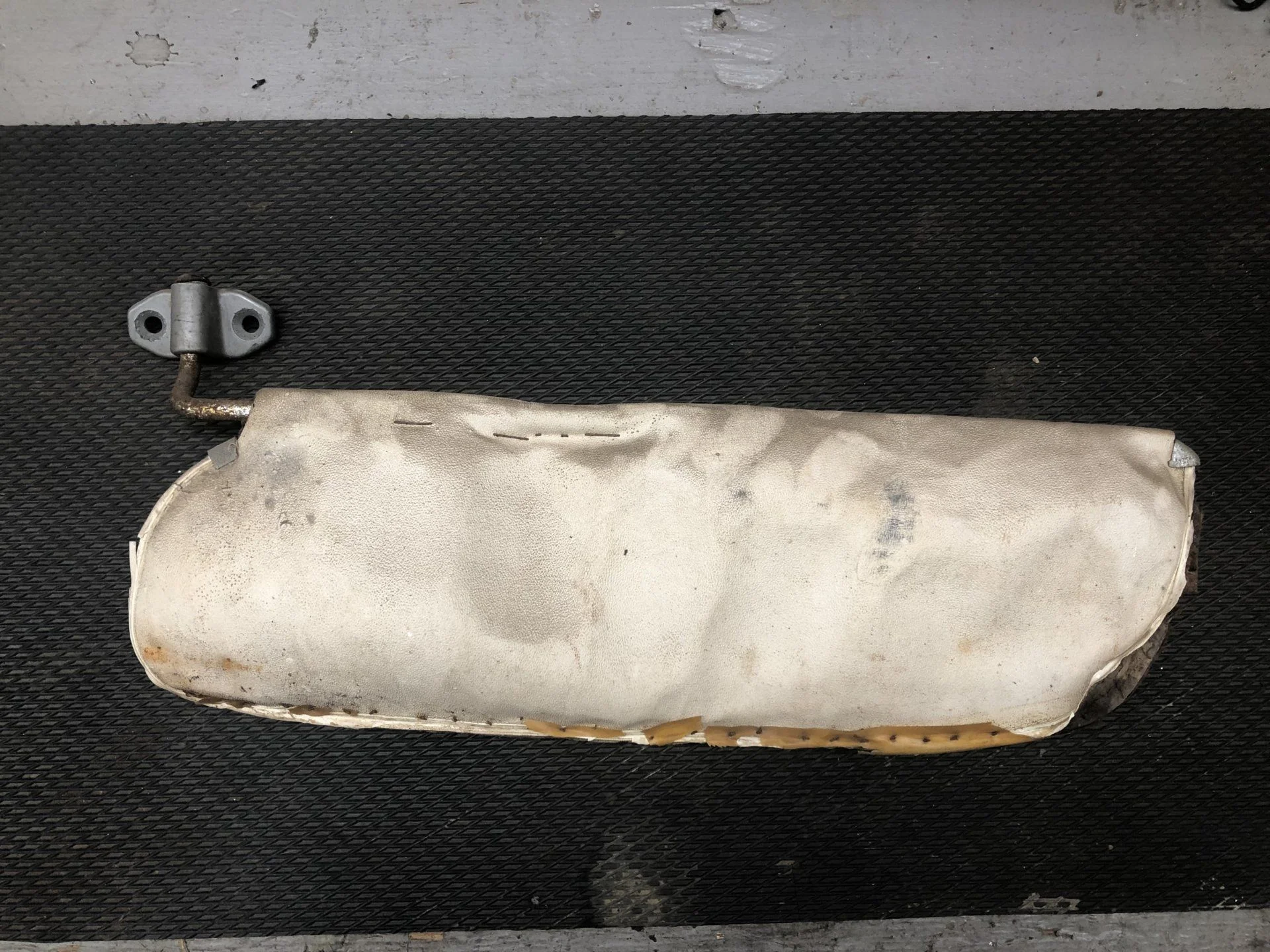

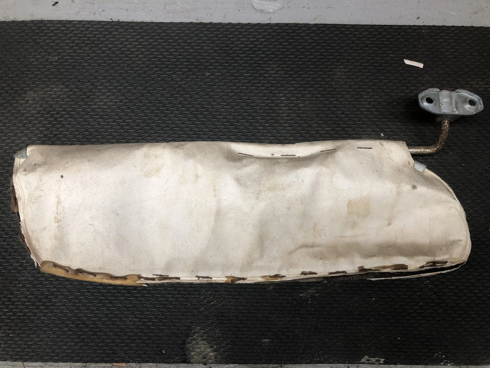

This is the drivers side sun visor I broke during the process. (Please see wanted ad in the 45 classifieds)...
:bang:
1925800

I'd say take a look at the plunger when you turn on the switch and you will probably see no contact being made. There is a small nut on the backside of the screw that holds the copper plates in place. Definitely need to remove the motor from the windshield and take care when getting the screw out to bend the plate.
Hope it's a simple fix like mine!

Also: when the plunger is pushed out and breaks the contact to the top (switch) wire that is when the wipers will park. So if you turn off the switch while the plunger is retracted (at rest) the wipers continue until the cam pushes the plunger out against the plates and breaks the contact and stops. This leaves the wipers to the far right of their stroke.

I have seen this thread and read as many others as I can find. Unfortunately, heavily used and abused motors are not as easily remedied, such as some, not all, I have come across. The copper reed switches do need adjustment, but I have found they are only one of a number of problem areas. The sad truth is that these were not designed to run and last forever, and there are a number of wear points such as the cam on the large metal gear, the friction pad on the motor side, metal-on-metal rotations without bushings or renewed lubrication, the rotor post, and so on. The TNK company simply globbed-on a thick wad of grease and that was it for the past 50 years of running (or not.)
