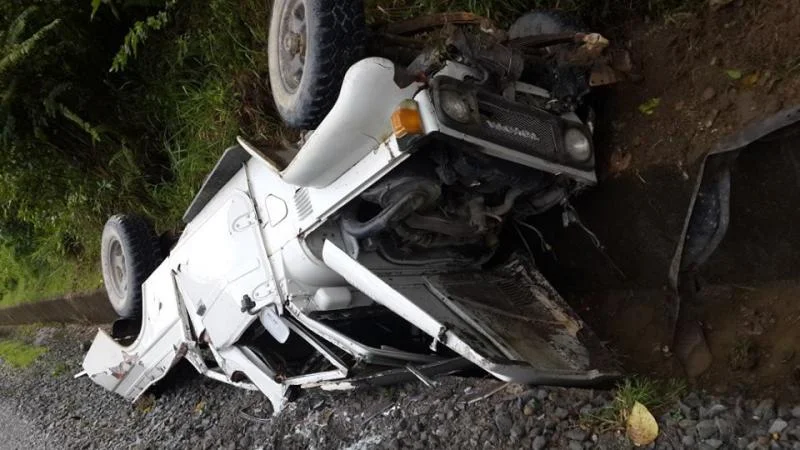

Then I saw this picture of a 45/47! Don't know what the story was and hopeful the occupants were OK. But even that hard top collapsed!

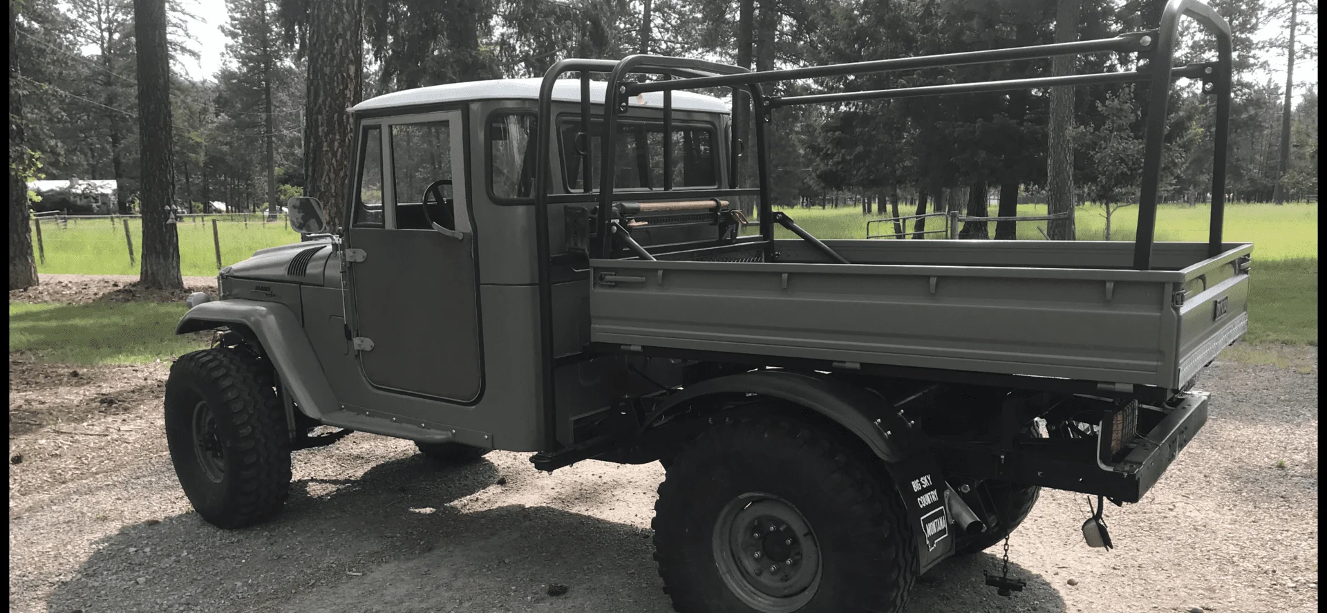

I opted for some limited protection outside the cab. So I built some protection between the cab and my smaller bed, then a rack in the bed that is beefy. One directly to the frame, the other indirectly. Used thicker tubing, etc.
It allows easy transport of boats, lumber, ladders, mtn bikes.
It doesn’t have lots of diagonals and other race type advantages, but doubt it would completely collapse in hiway rollover.
But also remember, death usually results from sudden decelerations not compartment encroachment. The bending of these components somewhat cushions your organs.
I rarely go over 45, rarely have doors in summer and also like the mild added side protection in the event of t-bone.

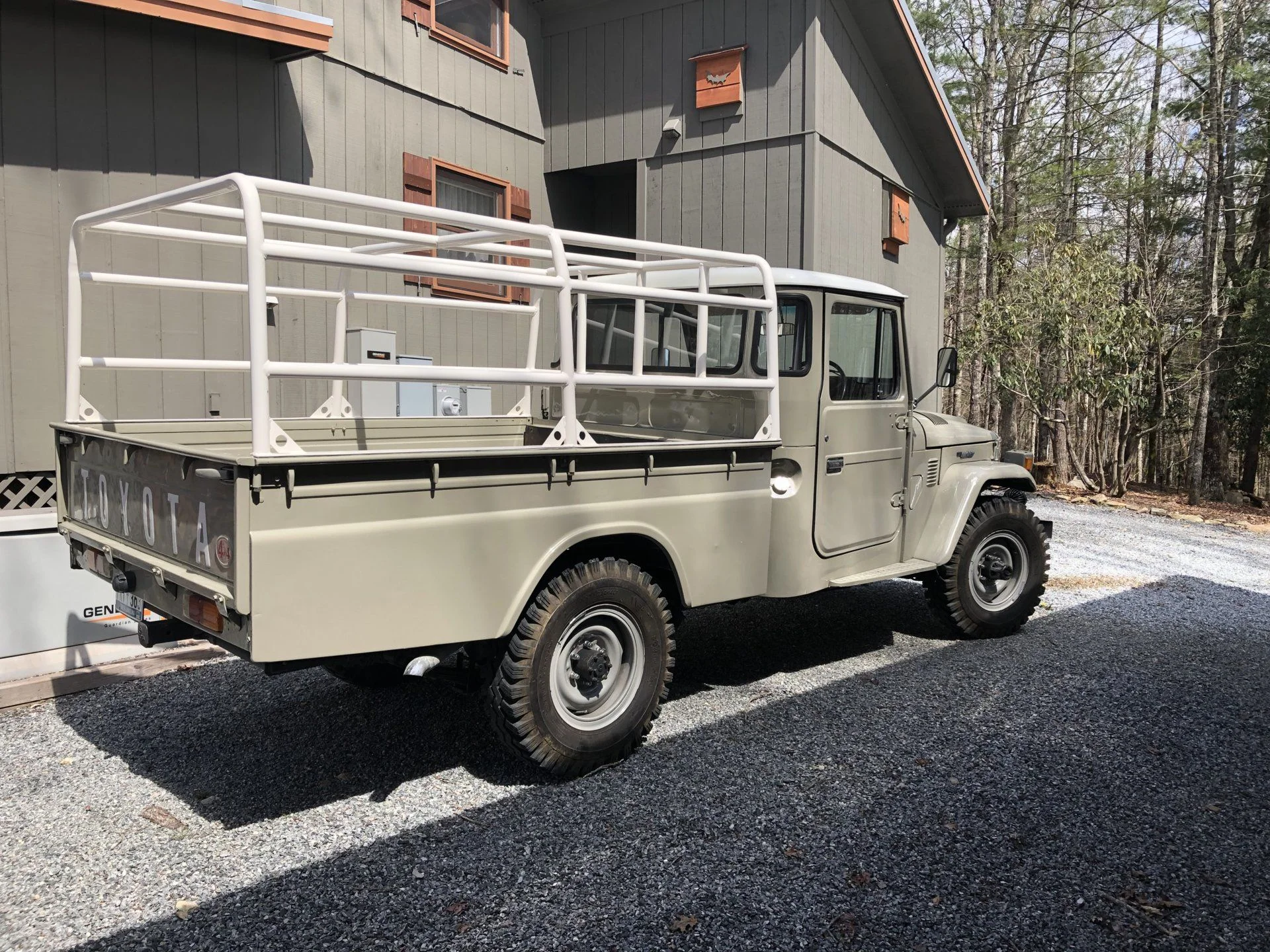

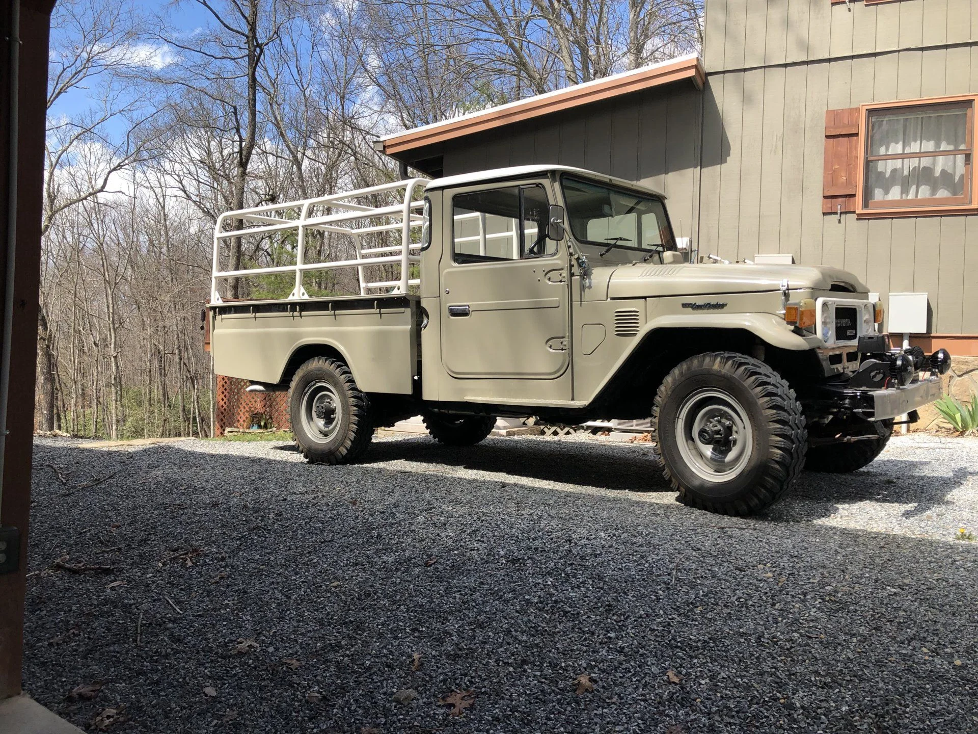

It would be possible to build a OEM-like bed canopy using stronger material that would give some protection and not offend the purists too
Like this?
(Quote) Like this?
That cage is only as strong as the bed. The bed isn't much stronger than the body. So without braces from the legs angled downward toward the frame and bolted, that's just a thick band-aid.

To help you the bar really needs to attach the frame and have a diagonal to keep the bar from collapsing as well as 2 rear legs. This at least gives you something over you head ala older CJ -5 and 7 jeeps. Padding as well at least in any area your head will hit.
