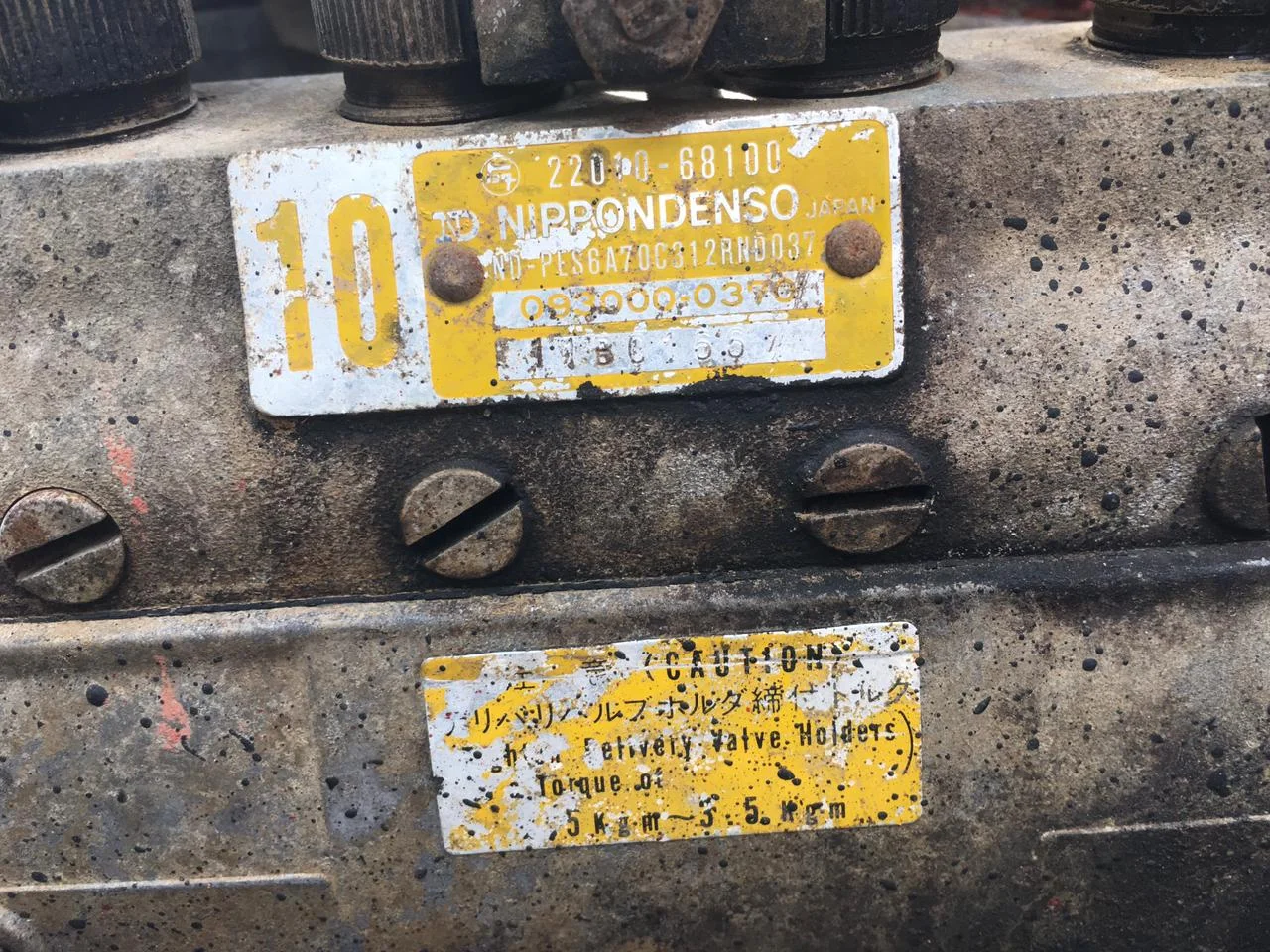

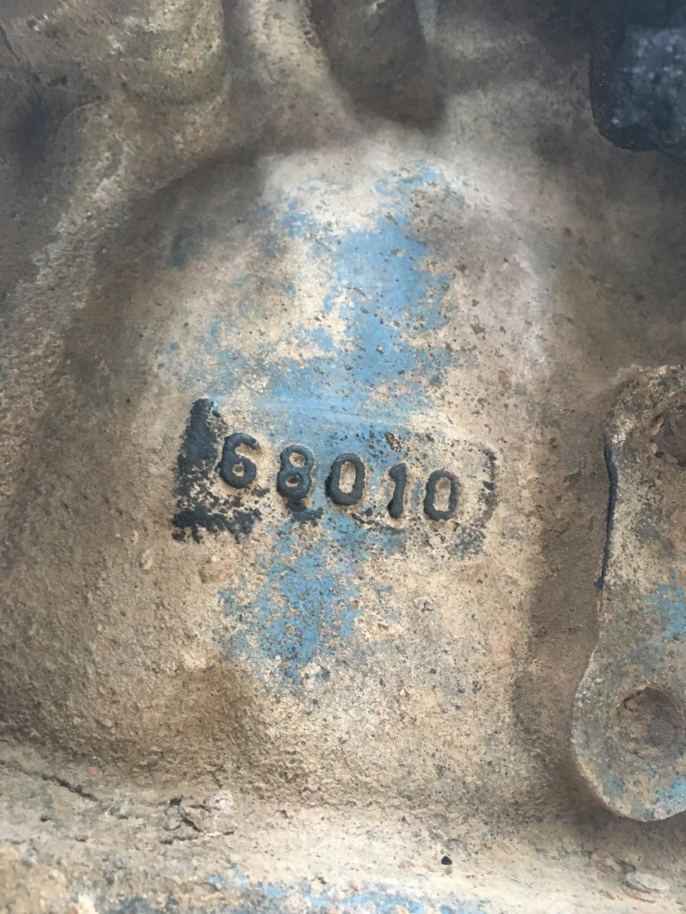

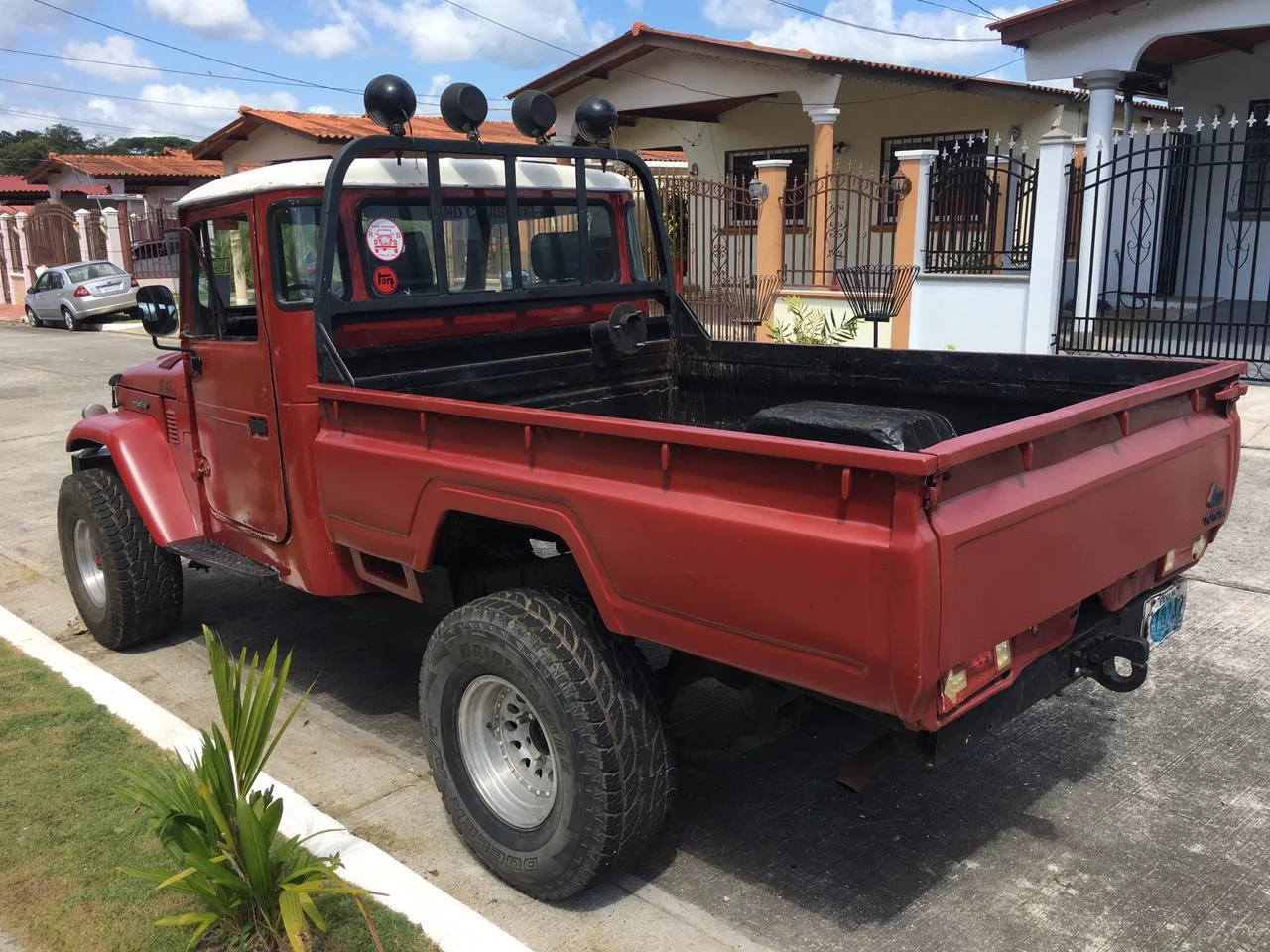

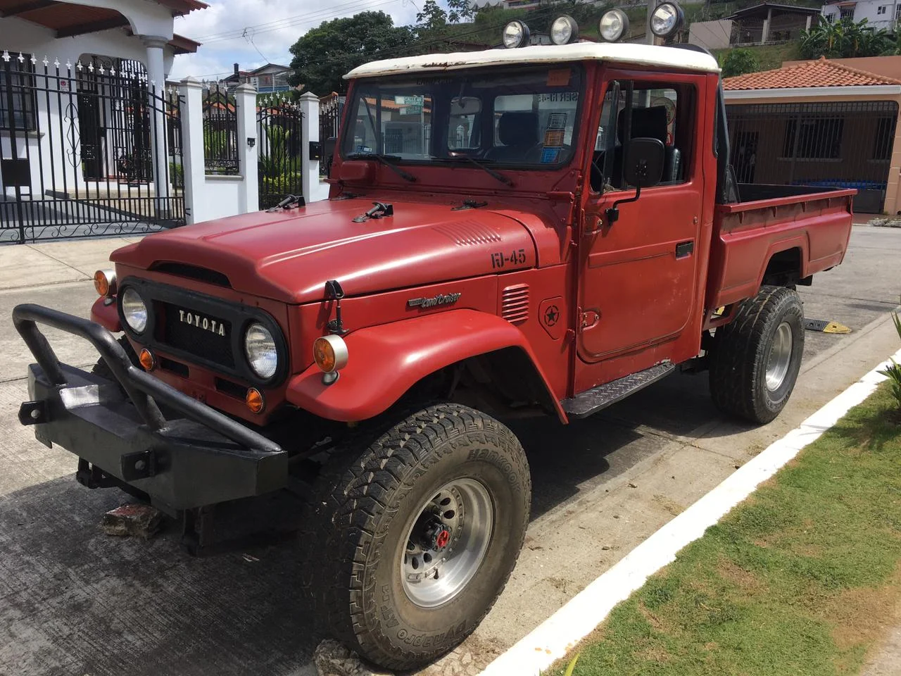

I am currently looking at bringing a 1983 FJ45 from Central America to restore and use personally. I just checked the truck out... runs great, roof needs to be replaced, bed looks like it was swapped for a newer model at one point, expected amount of chassis rust, body in good shape but has been resprayed, title papers color matches respray. But the big concern is not finding a VIN/constructor's plate. I've attached photos of what I could find but it looks to be only the engine serial. I need to get through these issues before okay'ing the purchase. Any insights? I'm assuming it wouldn't be legal to have a VIN plate made to match the title paperwork...
The frame stamp is technically your legal vin, so you don’t need the plate, & lots of dmv’s won’t check a non windshield plate anyway. Beyond that, yeah you can have them replicated. Search on here for vintageteqparts.com if I recall correctly. I don’t know how he does it, but Matt is the guy you need!
Appreciate this info! Will direct CBP to the frame stamp if there are any issues, thanks!
