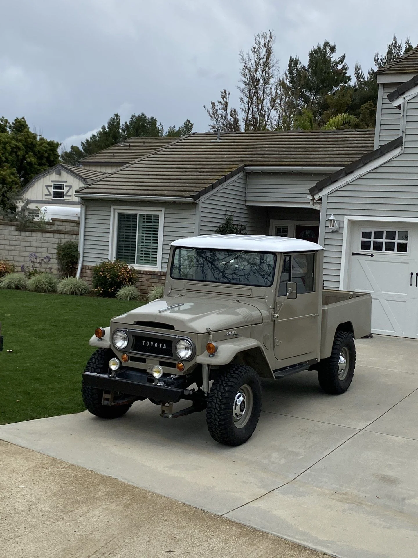

Hello hello! Did you ever end up sorting out anything for the SWB fixed top 45s? Would love to have something for mine if I end up putting seats in the bed.View attachment 2238007
Following up. I will like one for mine too. My dad and I where thinking about making one this coming summer, but if I can get one already done wouldn’t not mind going that way. One less thing to figure out
I see this is an old thread, love how that black soft top looks on the 45 pickup. I have an 82 FJ45 LWB, want to keep the hardtop but interested in a soft top system for the bed. PM me info if you are still doing these? Thanks
