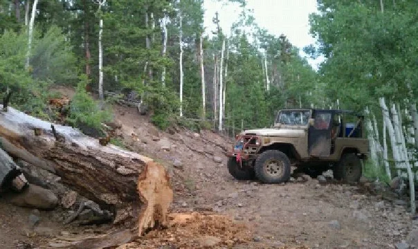

Reason I ask is cause its a mirror image of the bumper my buddy and I came up with. Search, newbie 73 FJ40 build and you will see the same bumper on my and my buddies rig. Kinda funny is all
