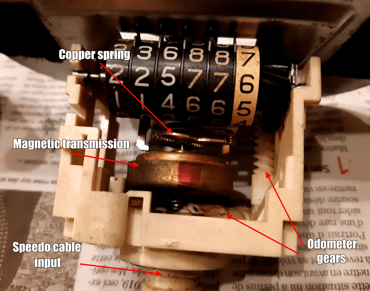

The original posting make me think it's the copper spring that is failing.
FYI the speedo (not the odometer) works with a copper spring that pulls the needle toward 0 and the needle is linked to the speedo cable with a magnetic connection. When your speedo cable rotate it pushes (through magnet) the needle toward the 100mph and you have a correct reading of speed thanks to a precise calibration of this spring.
This copper spring is very fragile, my original broke by itself after it sat for 6+ months not serving during a renovation of my 40. To keep my dash original/period correct we tried to move the mechanism with the spring from a brand new speedo to my old one... We broke the new one.
Long story short don't mess with this spring, don't touch it and if yours is broken I see no way to fix it, it's far too precise for our dirty full of grease hands.
The odometer does not depends of this spring to function so you have a way to diagnose where the issue comes from :
odometer + speedo not working = speedo cable problem
odometer working, speedo not working = copper spring mechanism not working properly
odometer not working, speedo working = odo gears used or full of dirt
