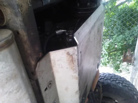

I have some piece of the metal which was dropped into the trunk when I bought the Cruiser. I assume it's a stock TC plate, but I can see it was cut, probably for clearance due to the lift. But it still a small.

Do you have a picture of it installed? I saw only pictures of it stand alone.
I dont' have any good pics of the plate installed.
Its currently off the truck right now because I am dealing with a leaking speedo housing on my transfercase. I could jack it up in place temporarily and get a pic of it this weekend.
If you have a stock one it should look similar to this one.

Something similar, just cut...

O checked my "original" and it seems to be around 3mm thick which would make it just a little less then 1/8. This is not bad consider my OEM skid plates on the 4Runner which was 1.2mm (less then 1/16). Another good point that back in 70s cars were built much stronger.
