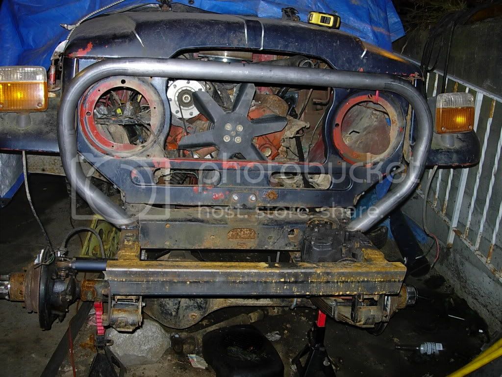

In the process of bending the front/grill bar.

It's a start. stinger, fenders and rock rails coming.

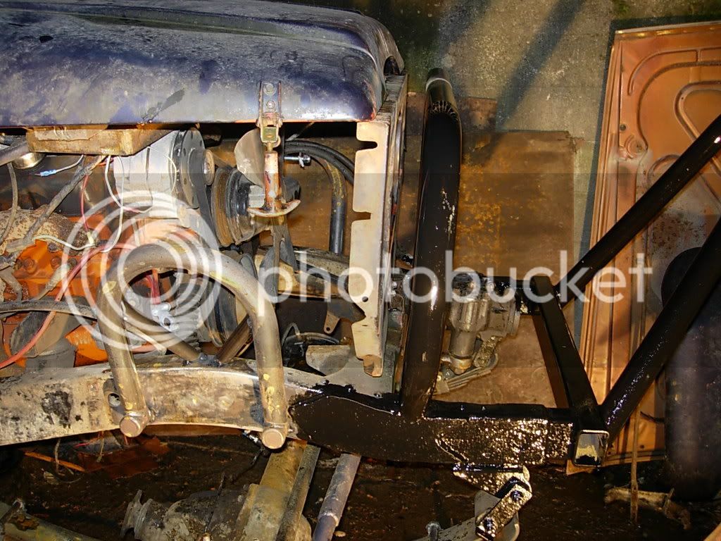

The gas tank and seats are back in, the brakes are on and bled (for now... still gotta SOA the rear)
The power steering is in and operational. :clap:
Drove her around to the back yard last night.:steer:
Got some other stuff done on the front as well.
sorry for blurry pic
More to come.

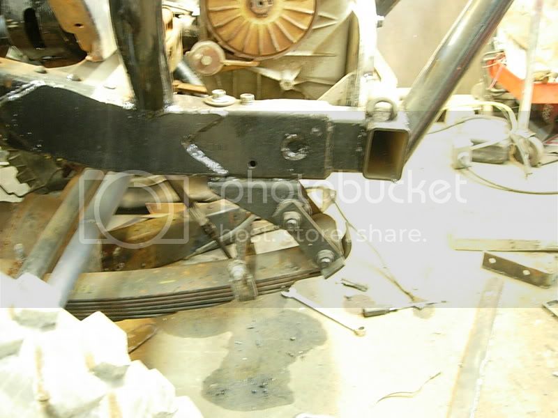

Moved the front axle forward a bit on the 40 for better shackle angles, mounted the winch, with help from Gabe, Eric, and My Dad.
Moved the rear axle's shackle hangers forward for the same reason.
Going to put longer shackles (a little longer) on both ends.

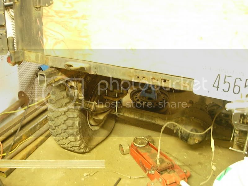

Rear spring over is done.
Ready to mount front and rear shocks soon.
It BARELY fits in my "garage" with the oem roll bar still attached.
In the process of making the rear bumper, and I'm going to plate the rear half of the frame where it goes into open "C". And I have to make a cross-member for the rear portion of the tub mounting.
