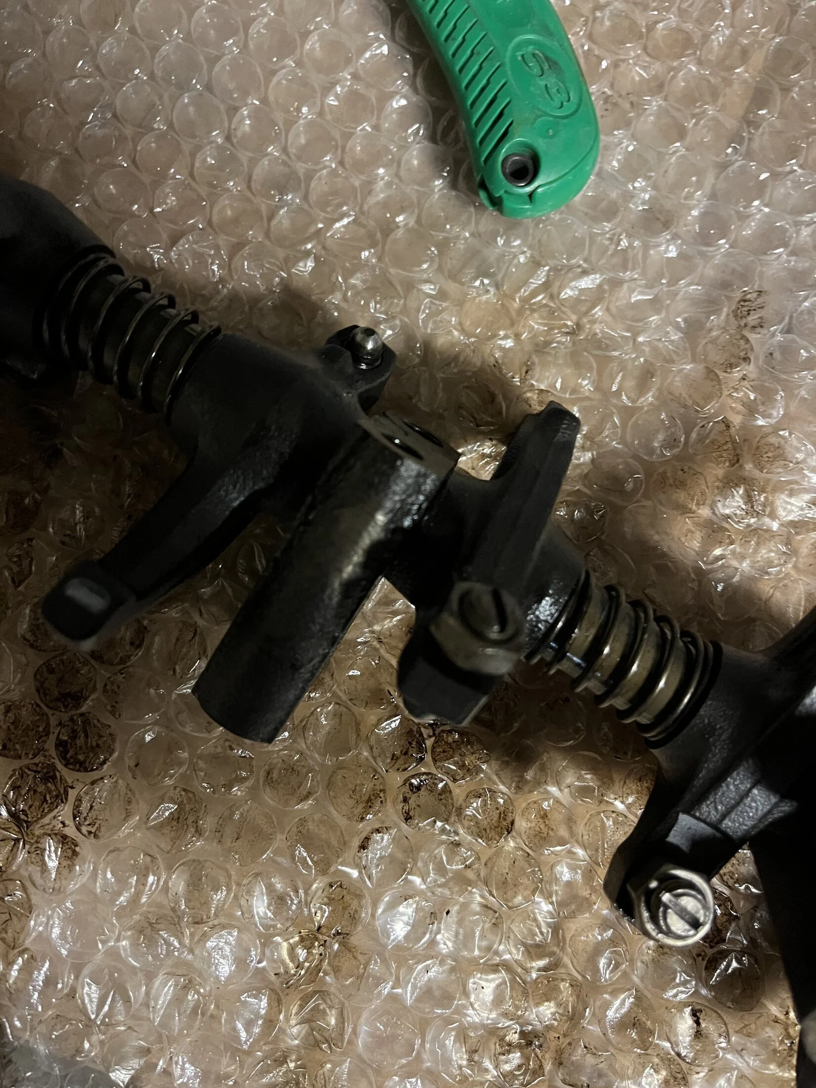

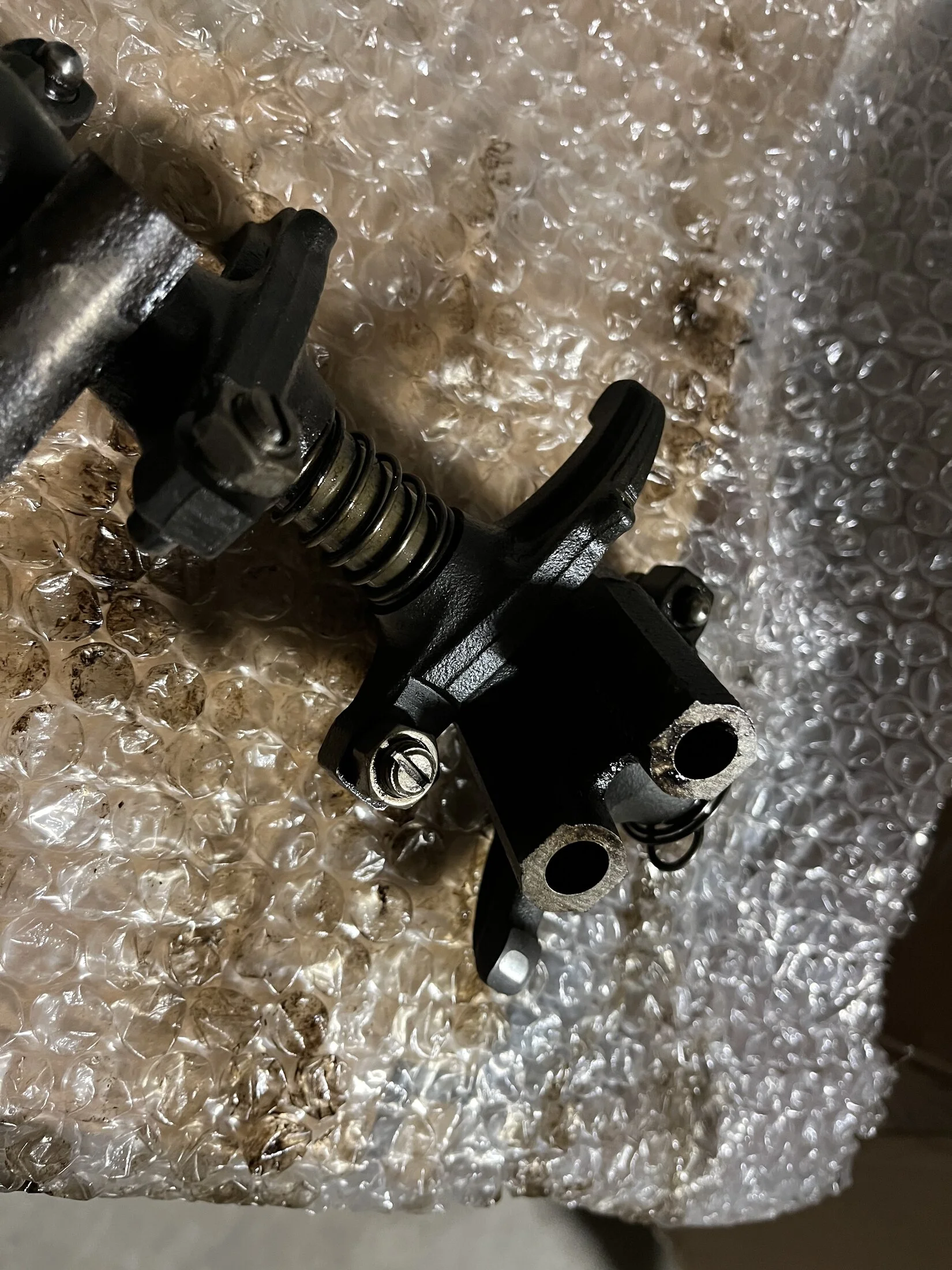

Before I throw this thing on, wanna make sure it will fit. Once again, first shown is the one I have on now with 12mm nuts and the next one is the one I’m putting on.
He sent a bolt too. Bolt is 75mm long. He said his is an 83. Mines July 85.
Don’t know the nuances and don’t just want to take SOR’s word for it and waste an afternoon putting on the wrong assembly.
Thanks
Thanks

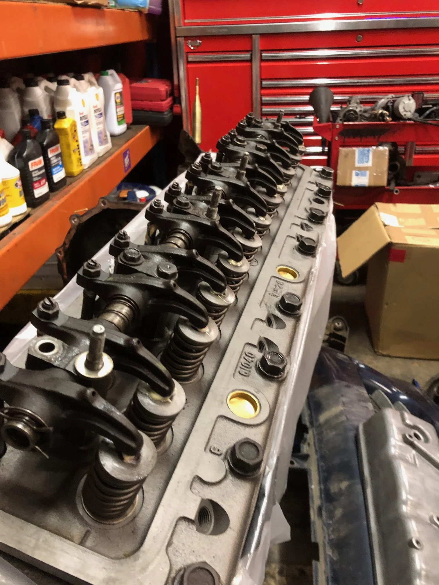

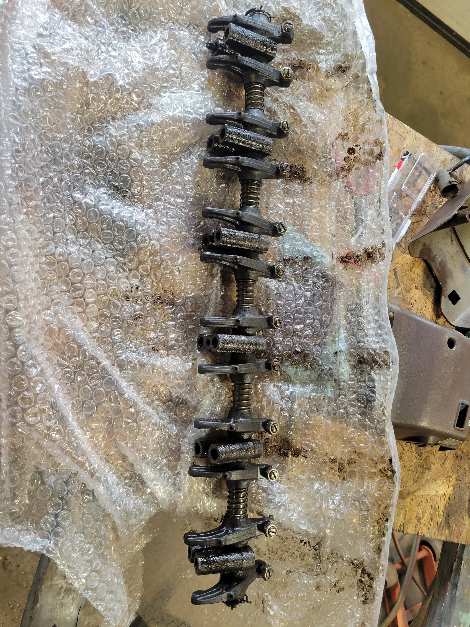

Bump! The assembly I purchased looks different, have been holding for until I can get confirmation it will eke. July 85 Land Cruiser. Attached is another photo of the new one, above is a photo of the old one on the head.
Thanks a million
Dan
Thanks a million
Dan
@65swb45 if you can lend any input, or where I can find an answer. Would be greatly appreciated
Dan
The stand looks correct.
