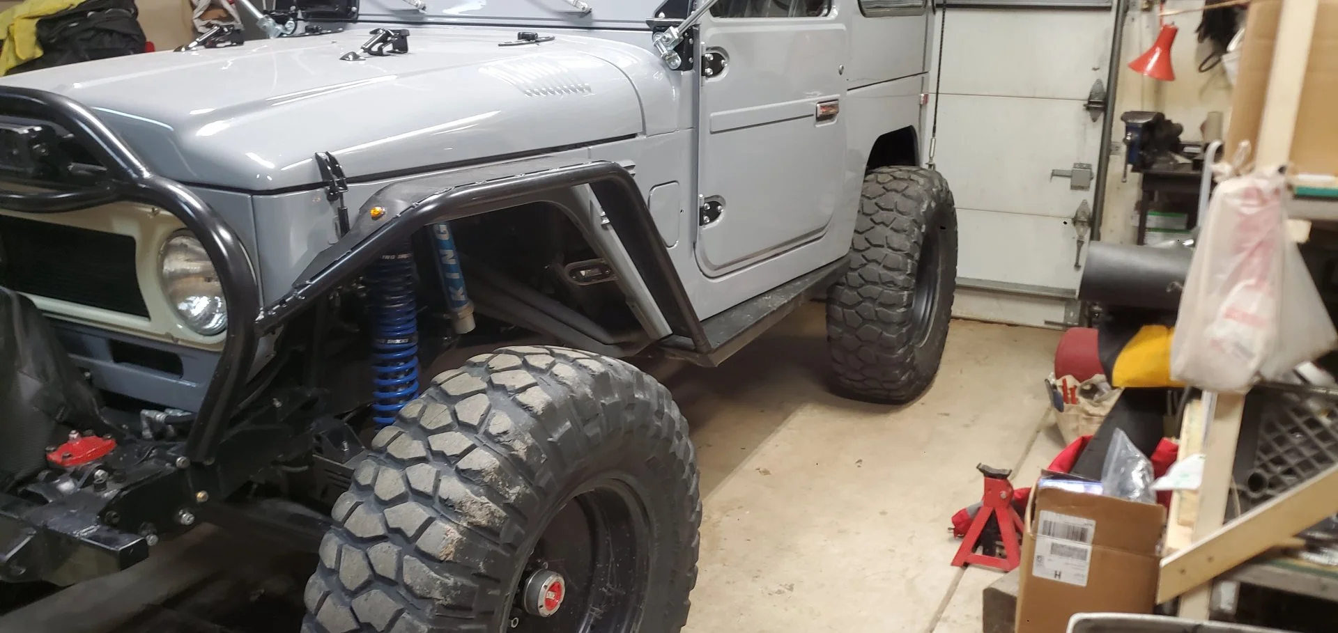

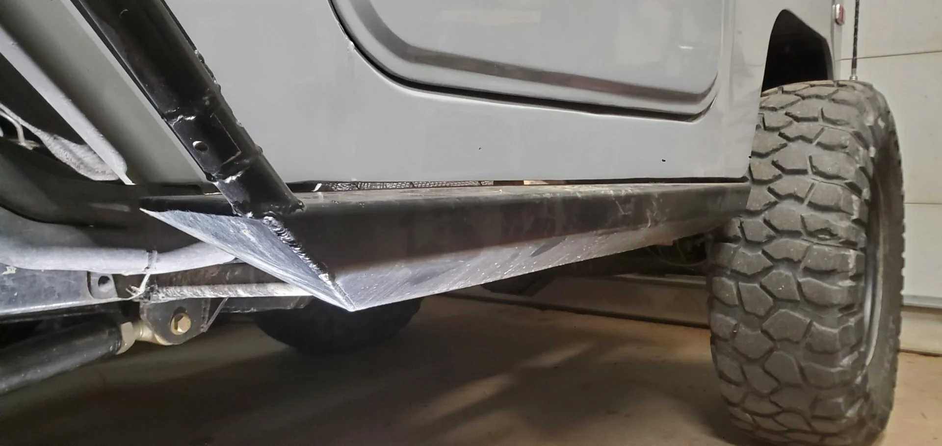

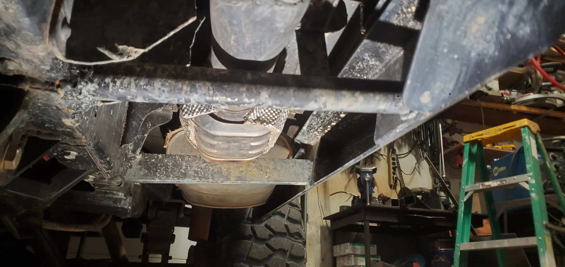

I run outside the frame duals with my 40, and have full sliders tied into the frame in 3 places. It is a very tight fit, but it works just fine.
A few pictures.
If the 13BT is like other B engines and your running a LC transfer case rerouting would be interesting. With the transfer case just about touching the frame not much room on the inside of the frame. You do not have to wheel very hard to bash the exhaust routed below the skid plate like Toyota did for years in the FJ40. On a FJ40 1/79 exhaust was routed outside the frame. Because there in a CAT bolted in line wouldn't be too hard to make sliders so could work on the exhaust without cutting and welding. But really keeping the exhaust in it's current location and have work done at the muffler shop would be the way to go.

Great info, thanks. Where did you get these sliders?
One of my friend's designs. It's folded 3/16 sheet. A competent shop with a press could probably make you a set.
