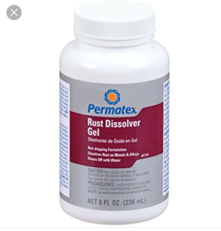

Your rig is in amazing shape. If you decide not to grind, I've found that Permatex Rust disolver gel works great. Sometimes a 2nd application is necessary, it used to be called Naval Jelly.
I totally forgot about Naval Jelly! I used to use that stuff on my old '70 Plymouth Duster. Good call. I'm not too concerned about making the floorboards look factory smooth, I just want to stop the rust from advancing. I'll grab a bottle or two and give it a shot.
Once I get the rust wire brushed/ground down/naval jellied, I'm guessing I need to prime and paint it so the bare metal doesn't flash rust. Kind of ruins the vintage patina, but at least on the floor, that might be the best option.
That's kinda what I was thinking you could do, as you know Naval Jelly is amazing stuff. Might even be useful on your rusty carb. It'll take the sacraficial coating off your carb, if any still exists, at this point though:meh:.
