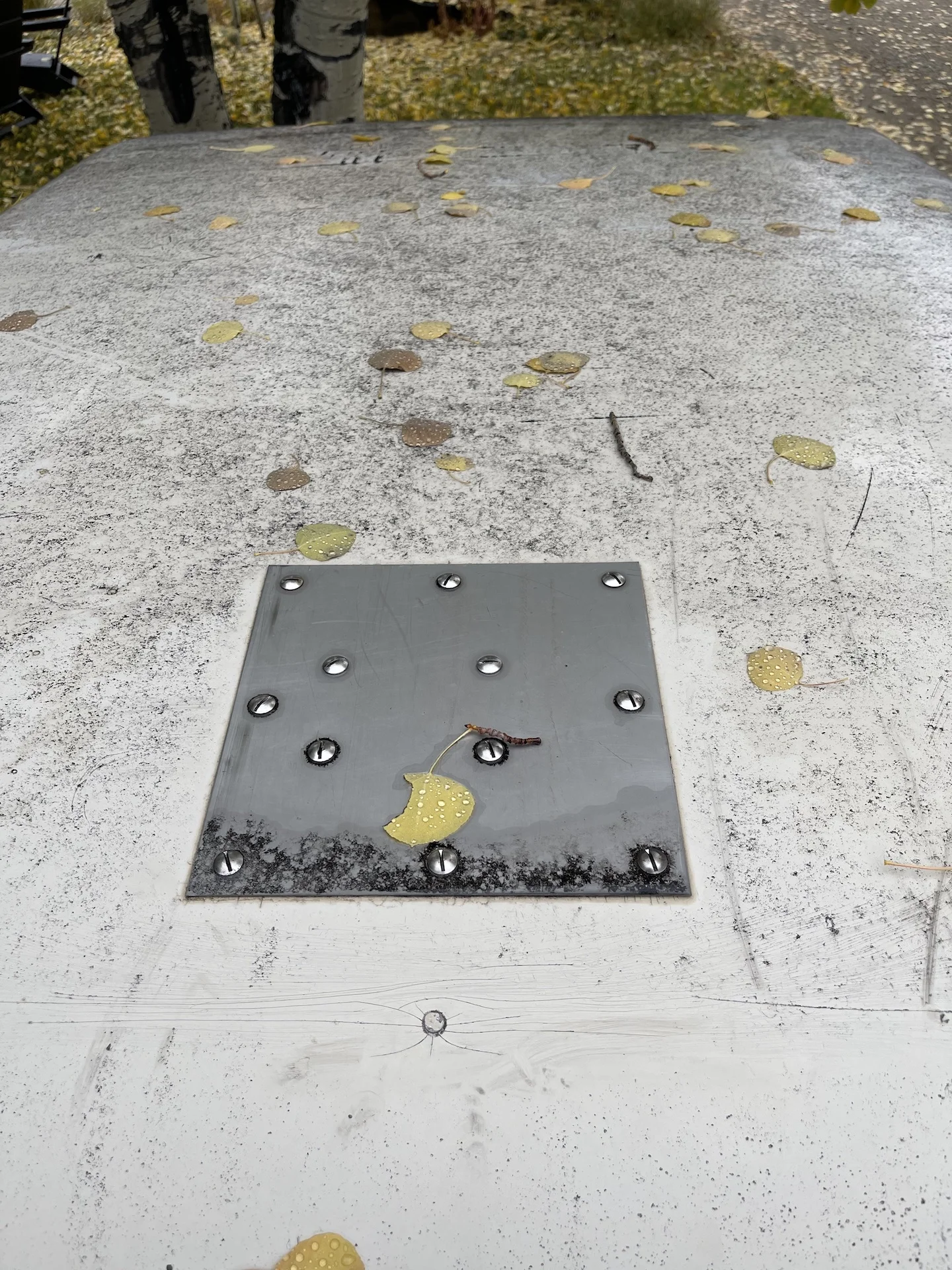

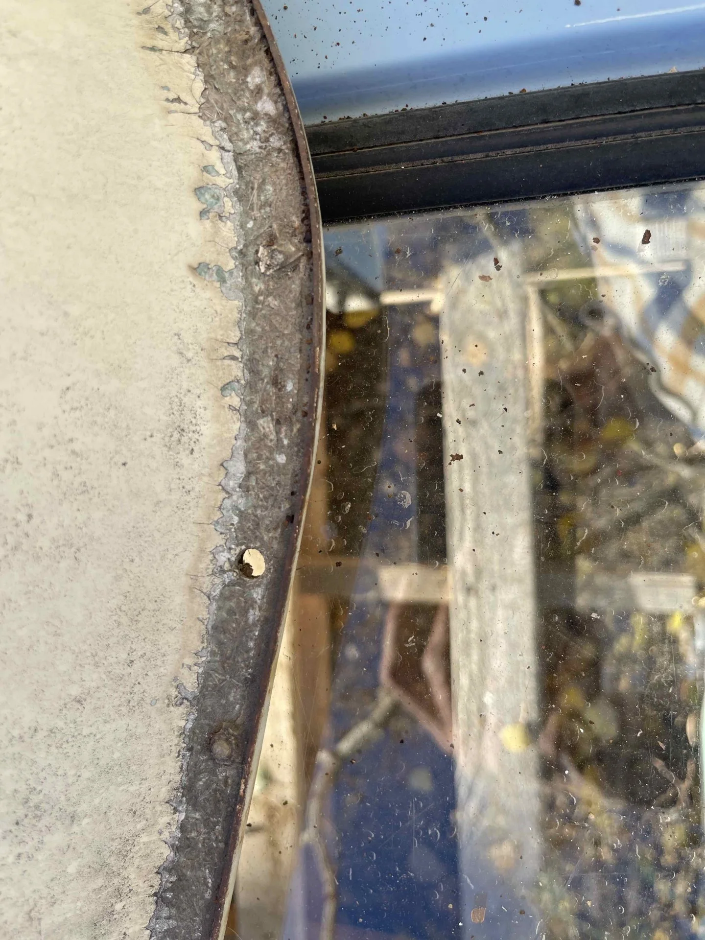

I need to remove this plate and fill the bolt holes

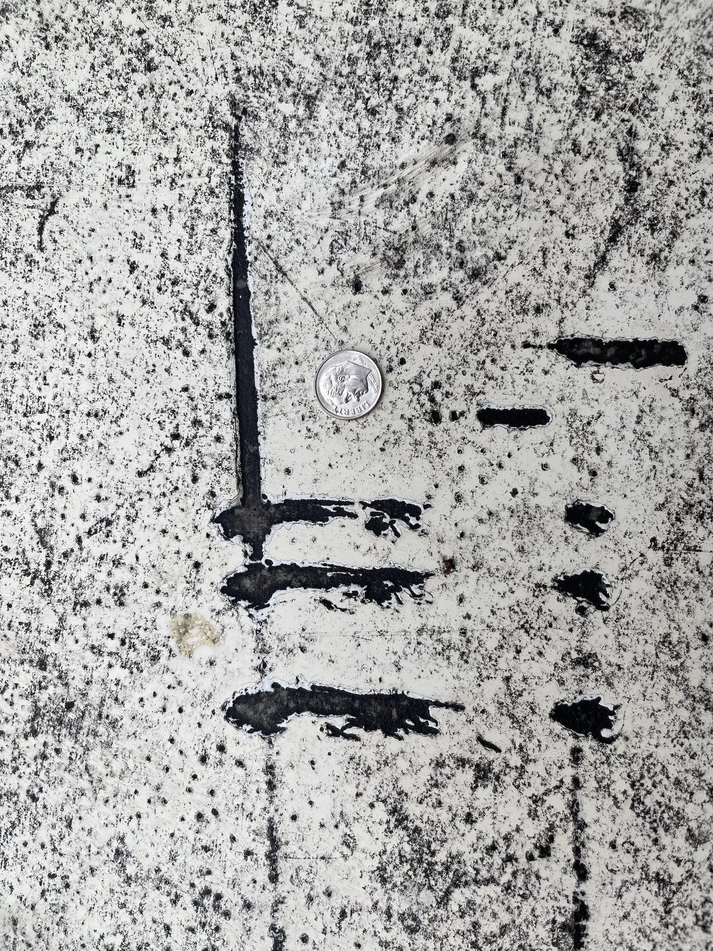

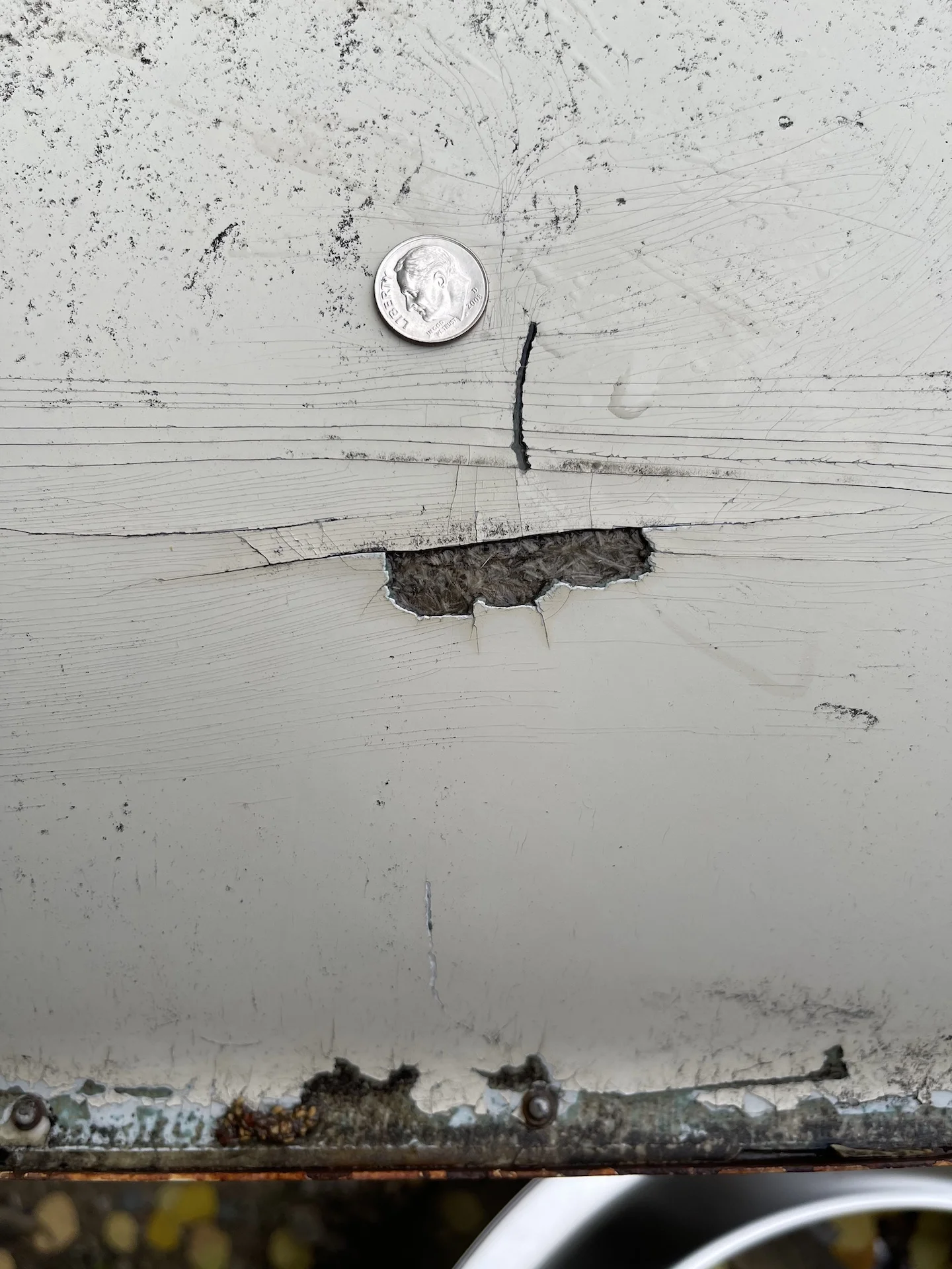

Then I have a few partial holes and scrapes to deal with
My plan is to repair these, and paint the whole thing. I assume a light sanding is the best prep.

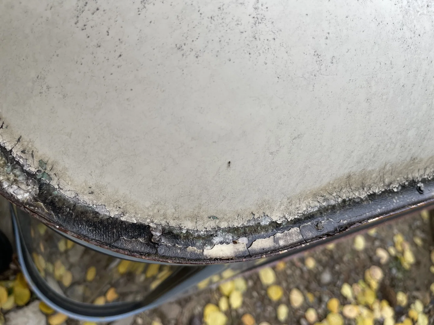

Finally I'm toying with the idea of re-riveting the lid, but would like to avoid that for now to keep it a little simpler. The raingutters do need love, and I have read about people throwing some kind of (silicone?) caulk bead in there every year. Any recommendations?
I do have new rivets coming from CCOT with headliner and weatherstripping, so I could probably be talked into doing it right.

Separate it and do it right from the beginning. You will thank yourself later.
My 2 $ worth. Prices have changed due to inflation.
^^^^ This. Separate.
Thanks all- what's the method for popping the old rivets? Grinder?
And once it's re-riveted, what type of caulk to seal the gutter before paint?
Not trying to be snarky. Use google search to search mud. There are threads on this.
thanks all! Yes there's a s***load of info here, amazing. Cheers
If you want some help, I'm in Gunnison. I've worked on those hardtops several times. 3m self-leveling is my choice of seam sealer, it usually takes about 1.5 tubes. You will probably want some fiberglass reinforced body filler "kitty hair". The stuff sucks to work with and is a bitach to sand, but it will be needed to properly fill those holes and any cracks. Don't sand into the gelcoat, it only makes things more difficult. Splitting the rain gutter is pretty easy, I'd recommend a flap wheel and some time to pop all the rivets from the bottom. If there isn't any major rust you want to take care of, I'd leave it alone. Depending on how perfect you want it, you can skim the top with a body filler. I would DA the entire lid with 180 to prep for paint, 80 if you are going to skim.

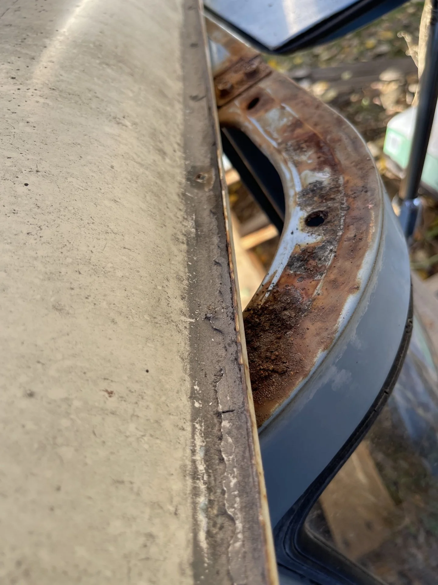

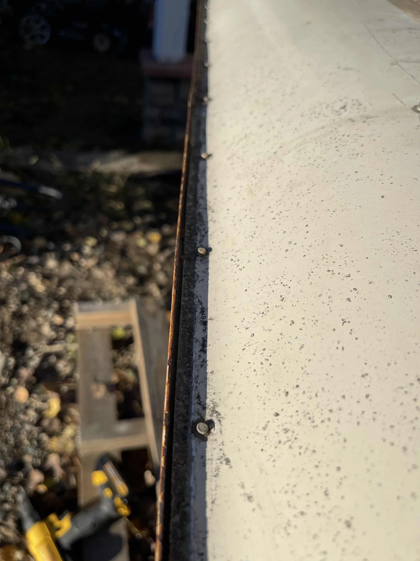

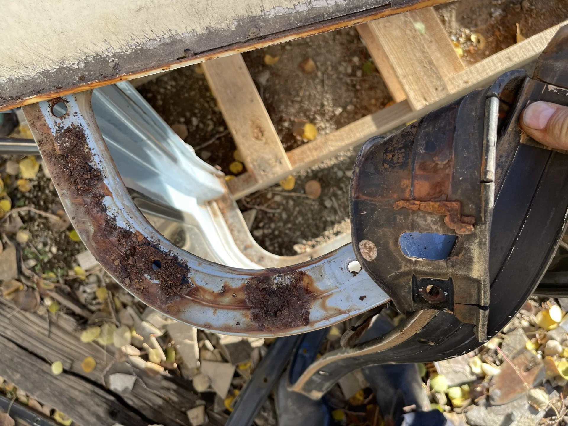

OK- today I started on what I'm calling my fall art project. Although it's already snowed here, so I need to get a move on! I figured I'll chronicle it here, what the hell.
I split the top/gutter piece from the body, and it all looks pretty solid to me.
My plan was originally to grind out the rivets and replace them, but to my eye they look like they're holding tight and why kick that nest. So my thought is to get a gentle grinder attachment and buff out the gutter as much as I can without damaging the rivets, and then use the 3M self-leveling sealer to seal it. Thoughts?

The gutter seems in decent shape, but it really isn't that hard to split it and reattach it either. I think it took me under an hour to redo the 70ish rivets, easy peasy...sometimes you'll spend more than that trying to clean the gutter and glass (top and bottom) while attached. Pick your poison a bit, I suppose.

EDIT: and definitely go light on the sanding...if you burn through the white gelcoat-type layer, you'll be filling in pinholes in the glass underneath.
