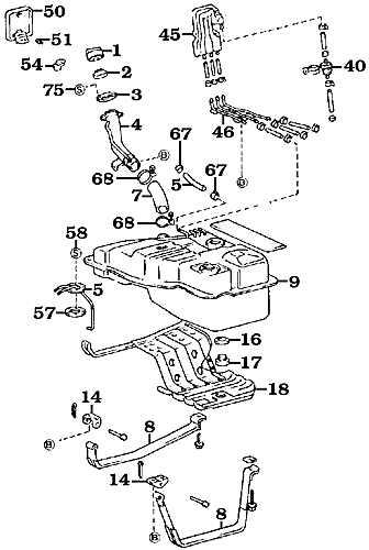

Toyota still has these Check Valves, but they are proud of them and quite the coin. I ordered one for my '77 part number 90917-10020.
Under the fuel filler hose / vapor separator guard.
Doesn't show up on the '78 diagram, but it's shown here on the later tank diagram as #40.
