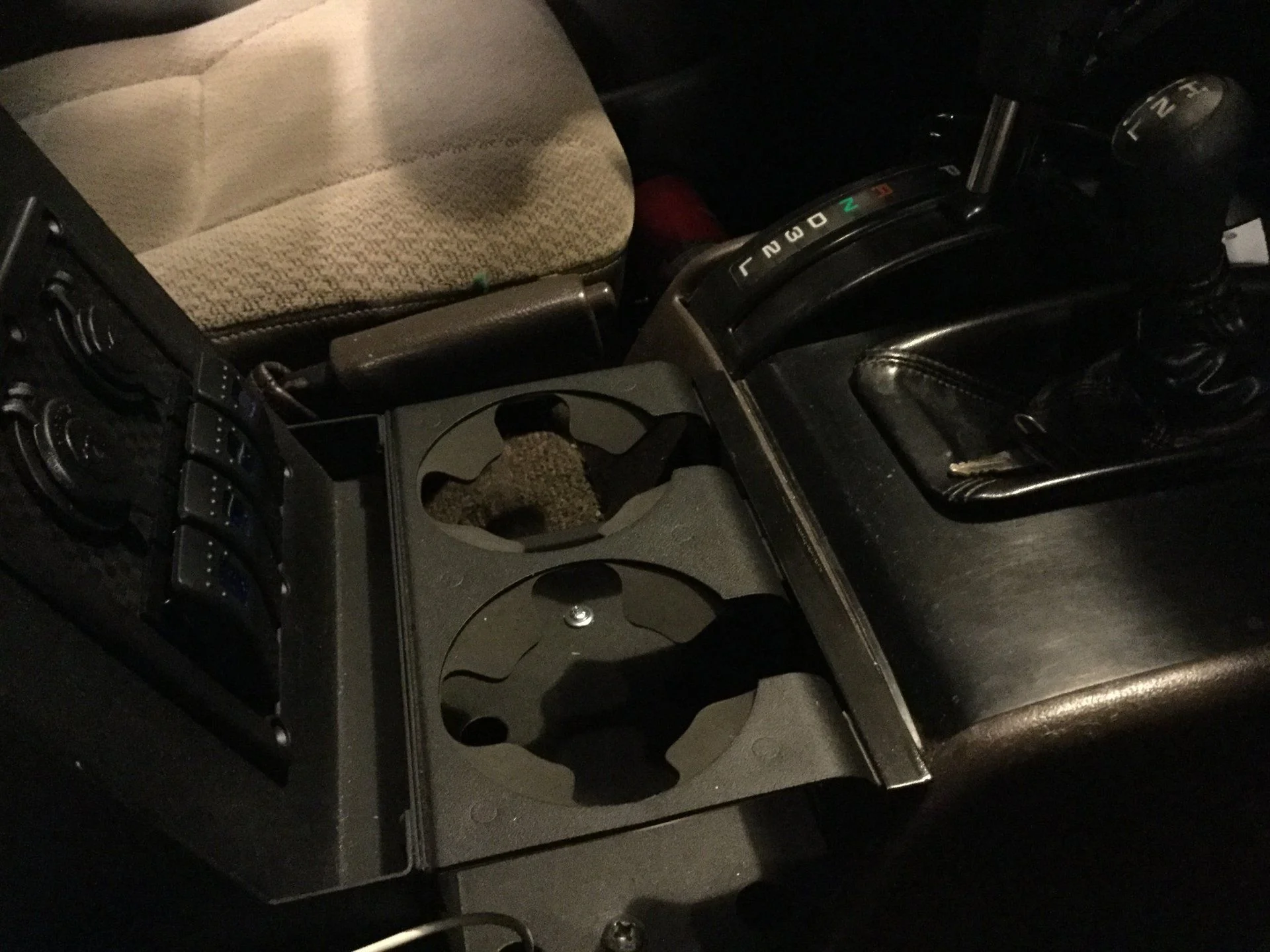

I didn't realize you responded. Sorry. I put in the Tuffy 013. It is a frog hair under 8" and fits fine. Probably could have done another half inch. This is the version with the stereo slot in it. I cut a hole and installed a 4-gang rocker switch panel that got good reviews on Amazon. It's all installed except I have not got the switches wired as yet. I trimmed out the OEM console hole to get the cup holders to slide in just a little. It left a gap at the top that I finished out with a piece of black aluminum angle. I didnt get the measurements on your box but I'm pretty sure it would be to long as the Tuffy seems shorter and is still borderline to long.
This looks awesome! I can barely get my FJ in reverse if the passenger seat is too far forward, so there's no way I could use it.

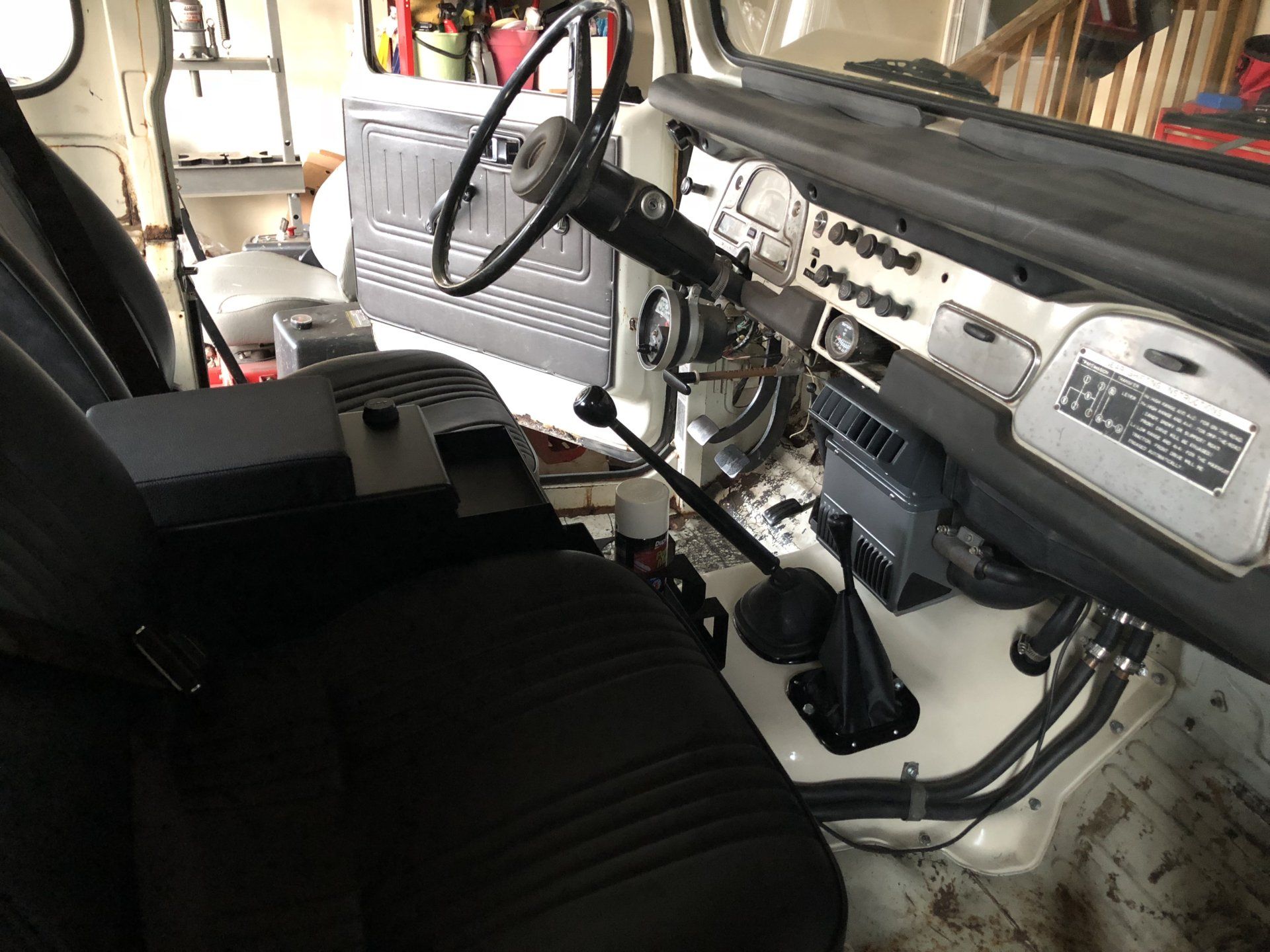

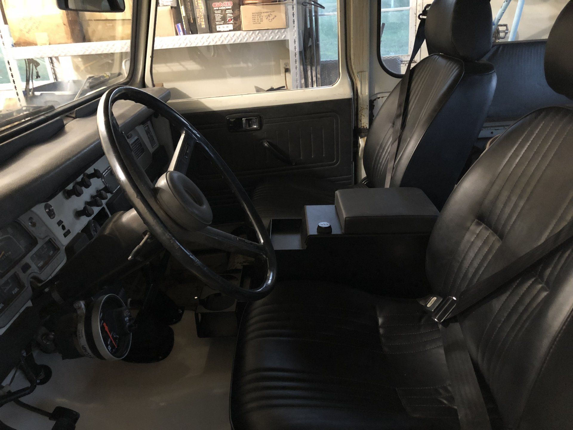

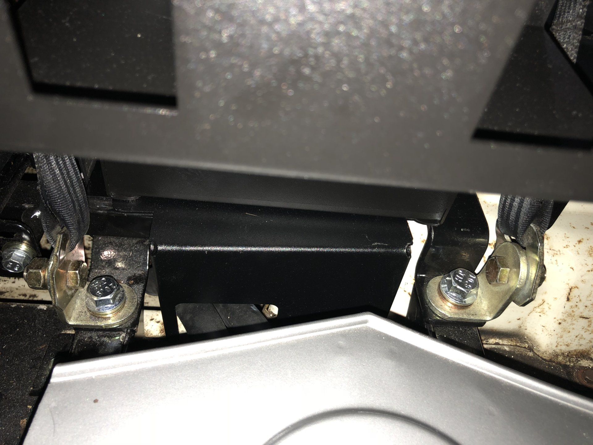

Another happy customer here! Very happy with how ridiculously heavy duty this is. Fits great between my ProCar 90 seats. I just had to cut the inner seat belt mounting tabs off the seat adapters. I moved the buckles to L brackets mounted to the rear seat mounts.
A quick shot of the seat belt brackets.
