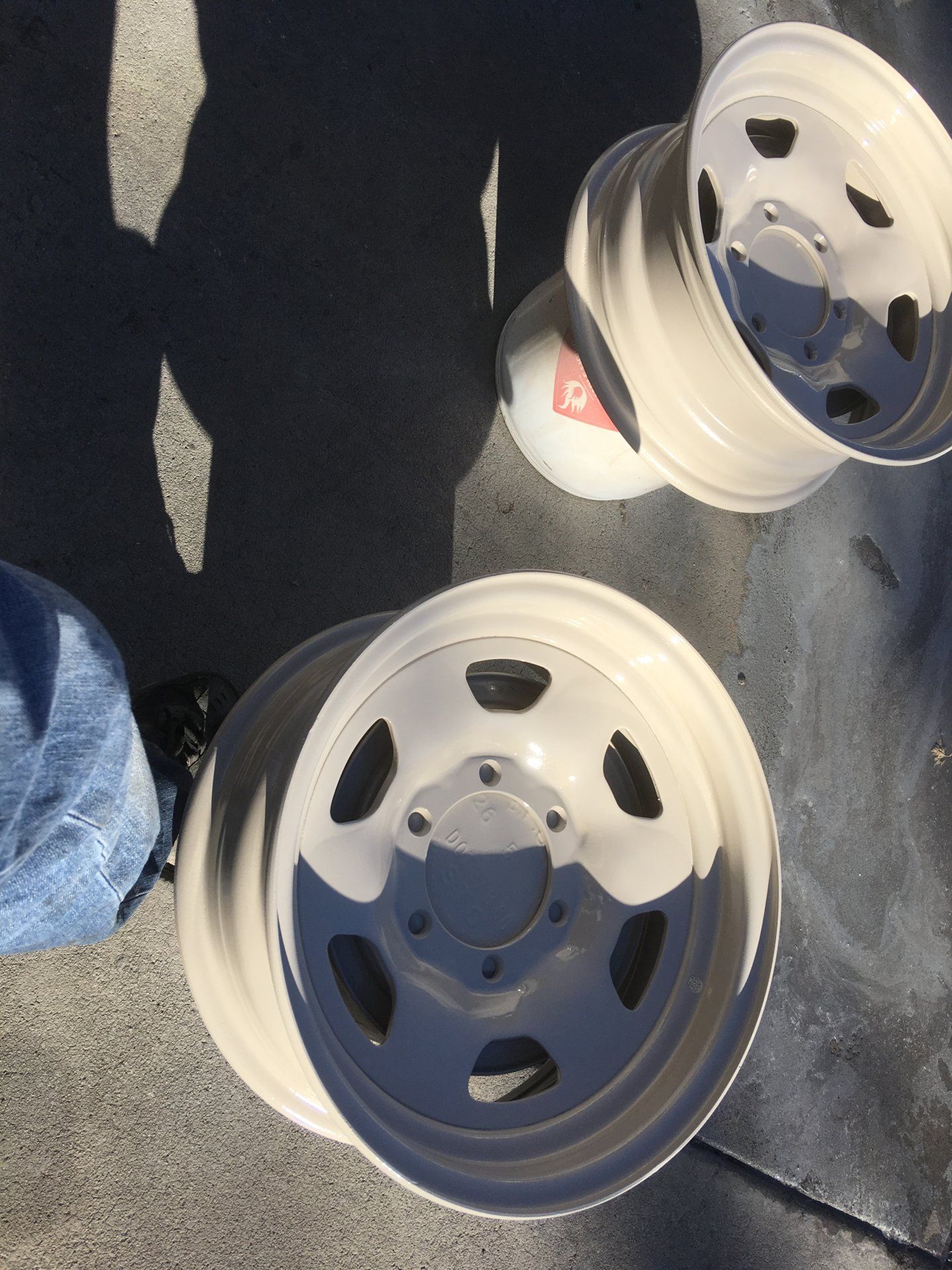

I've been reading everything I can find on colors for the last 5 years as I've been collecting parts and getting ready to paint my '74. (No way to preserve patina, replaced fenders and quarter panels, rear sill.) I'm not stuck on a period perfect resto, but I decided that if I liked OEM colors I would stick with those. The other day my body guys said it was "go time" on picking colors so I pulled the trigger on Nebula Green. For the roof, bezel and wagon wheels (I know they aren't accurate to the year but I got them dirt cheap and I like them) I told my body guy to try Shell Ivory, fully expecting him to come up empty with that color code. I told him Cygnus would be fine if we couldn't find the formula for Shell Ivory. Today he called to tell me that his paint guy had no trouble finding Shell Ivory but was worried that it would be more tan than I wanted.
I said "go for it" and this is what I got:

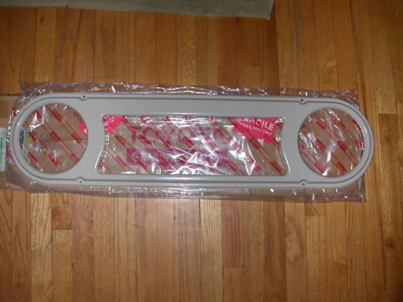

Compared with a new-in-package shell ivory bezel below (borrowed pic). Keep in mind different light, different cameras, but I'm pleased as punch.
I'll try to get more details when I stop by the garage tomorrow. All I know right now is that it is single stage.
I know this an old thread, but where did you buy a new bezel?
thank you
thank you
Sorry I missed this 2 years ago LOL. I wish I knew where to buy a new bezel. The photo of the OEM bezel I had referenced, I stole from someone else. Admittedly it's not a good idea to reference color using digital images viewed on different devices, but that image at least supports the "no bright white" stance.

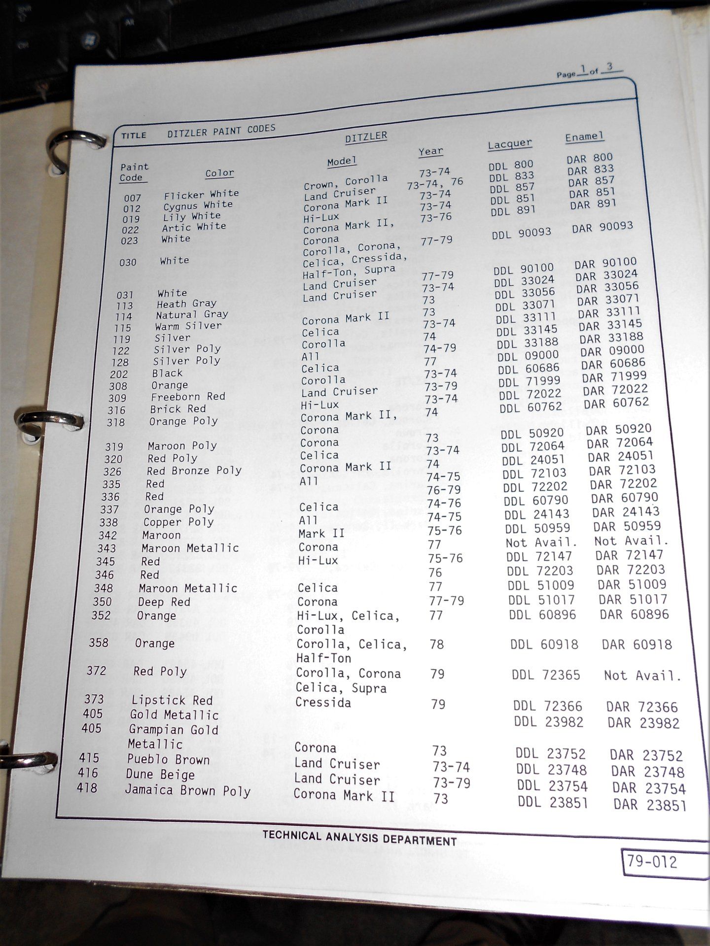

Thank you for this chart. The date range helped me distinguish between dune beige and beige (464). Very helpful to a noob on the site.

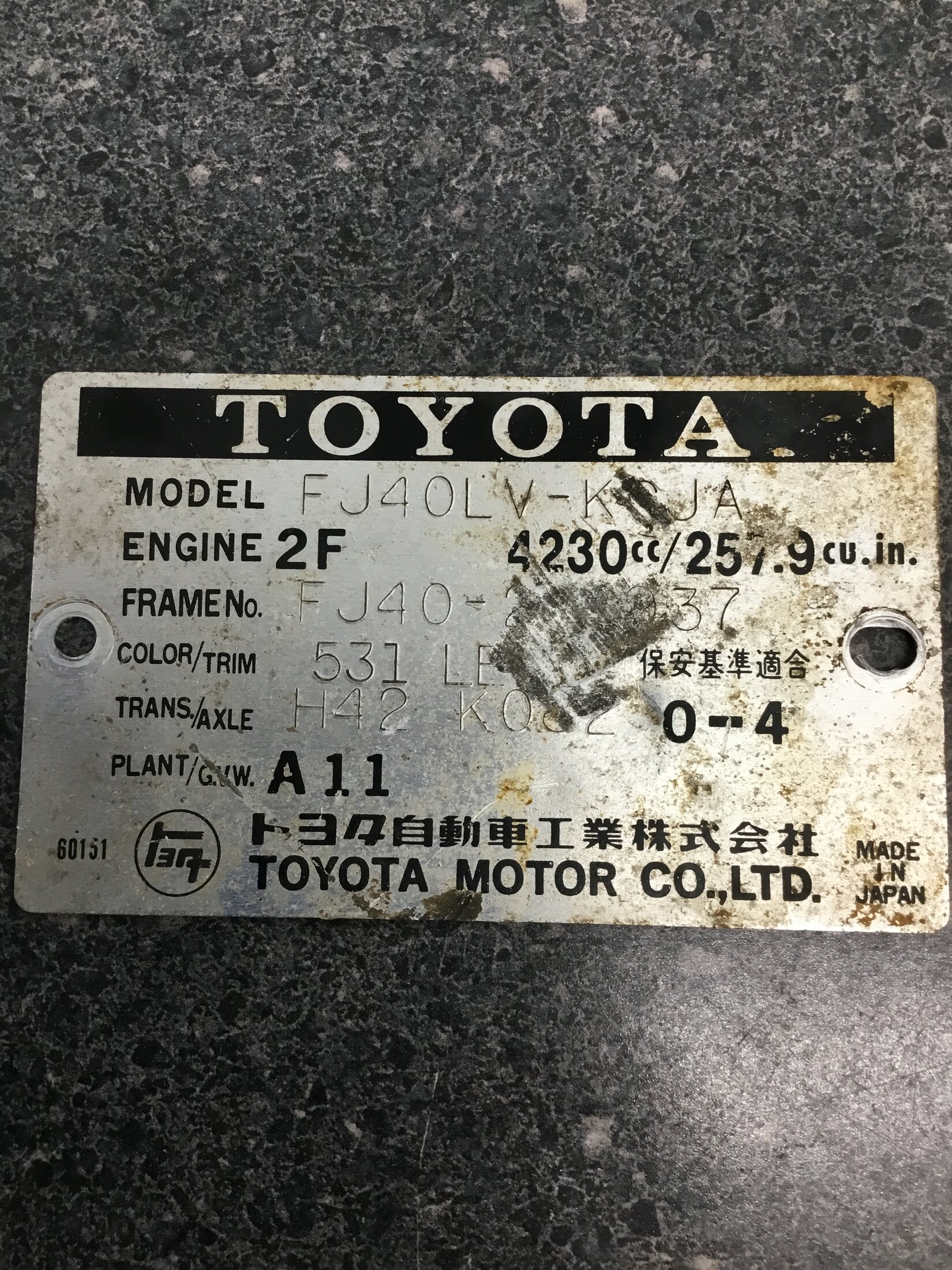

Apologies if I missed it, but the 75 (40) had a different yellow code (531) that I believe was unique to that year. Just slightly lighter than mustard. I'll attach my tag.

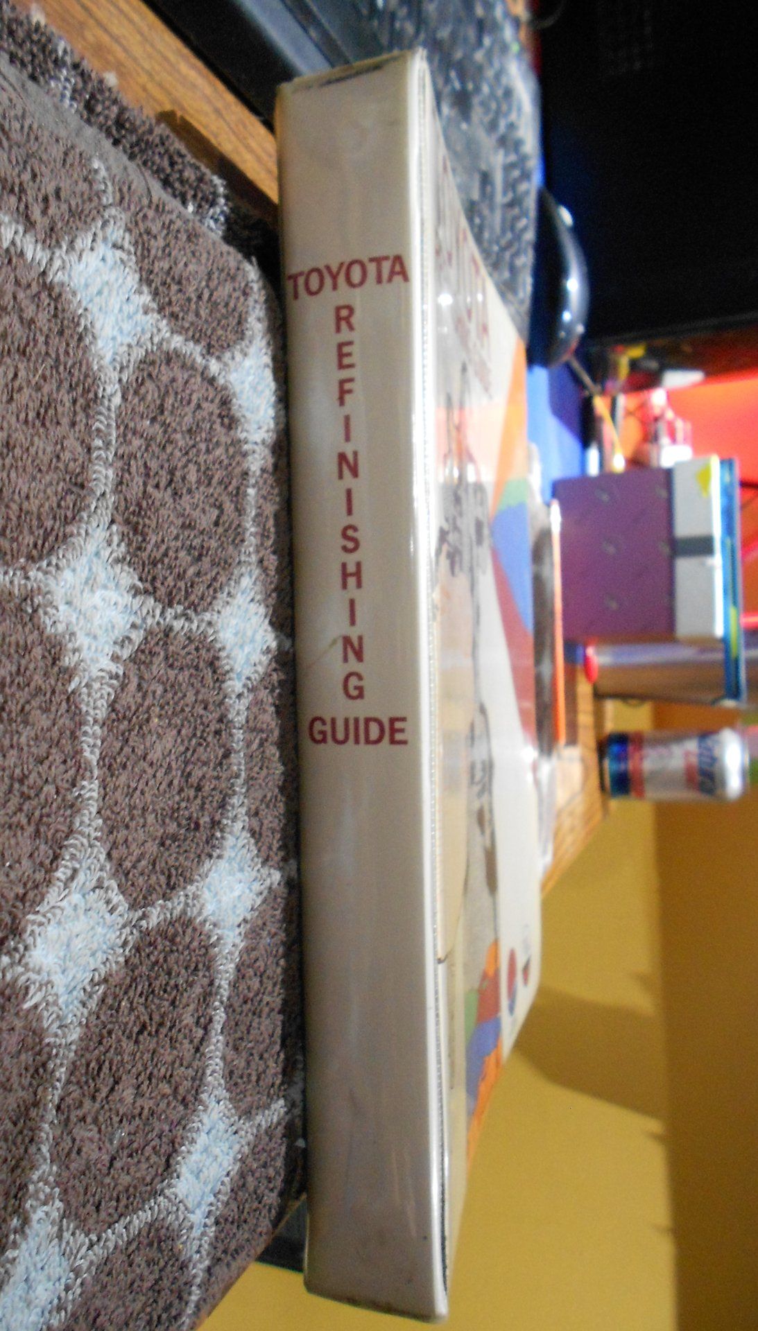

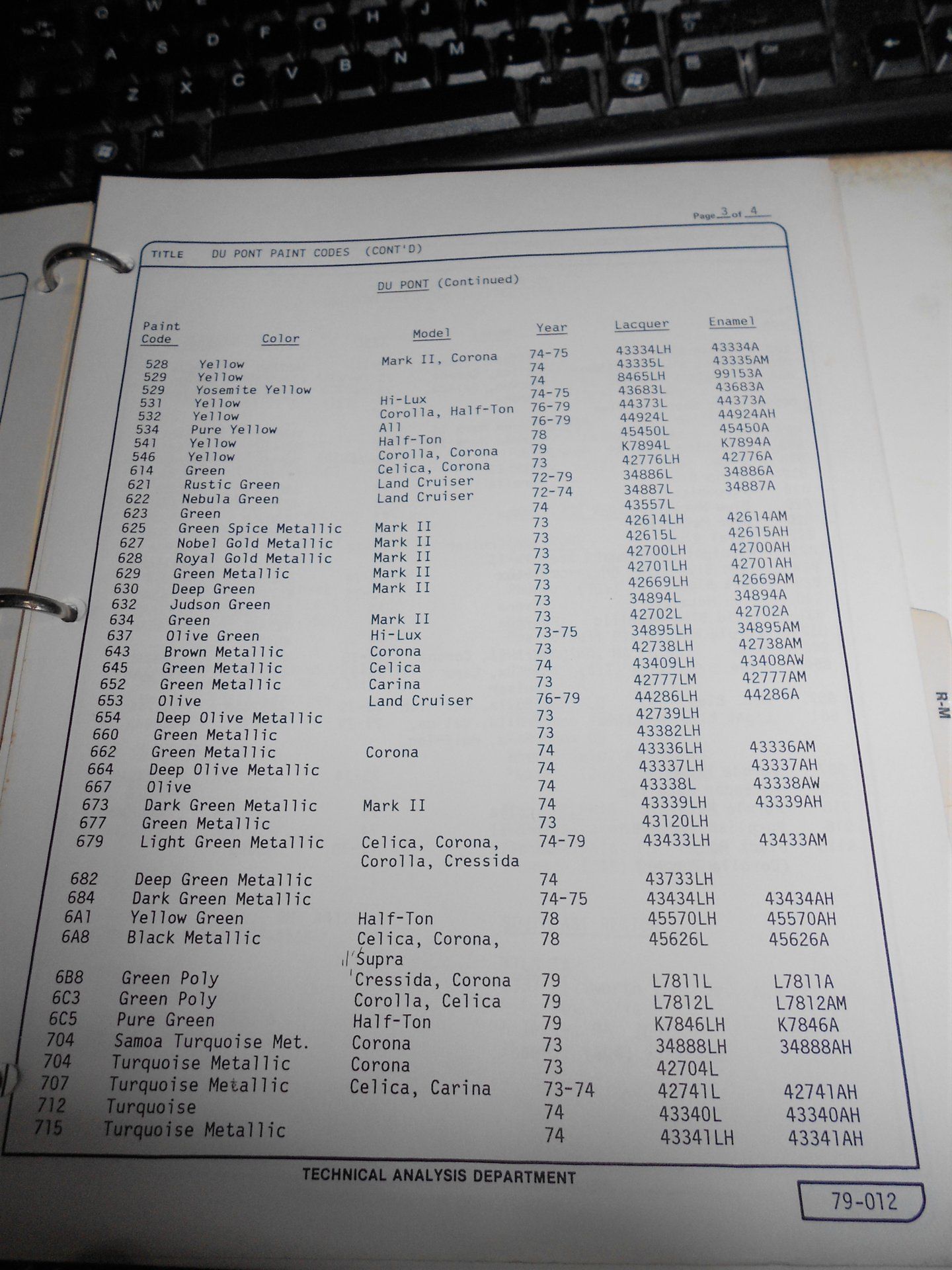

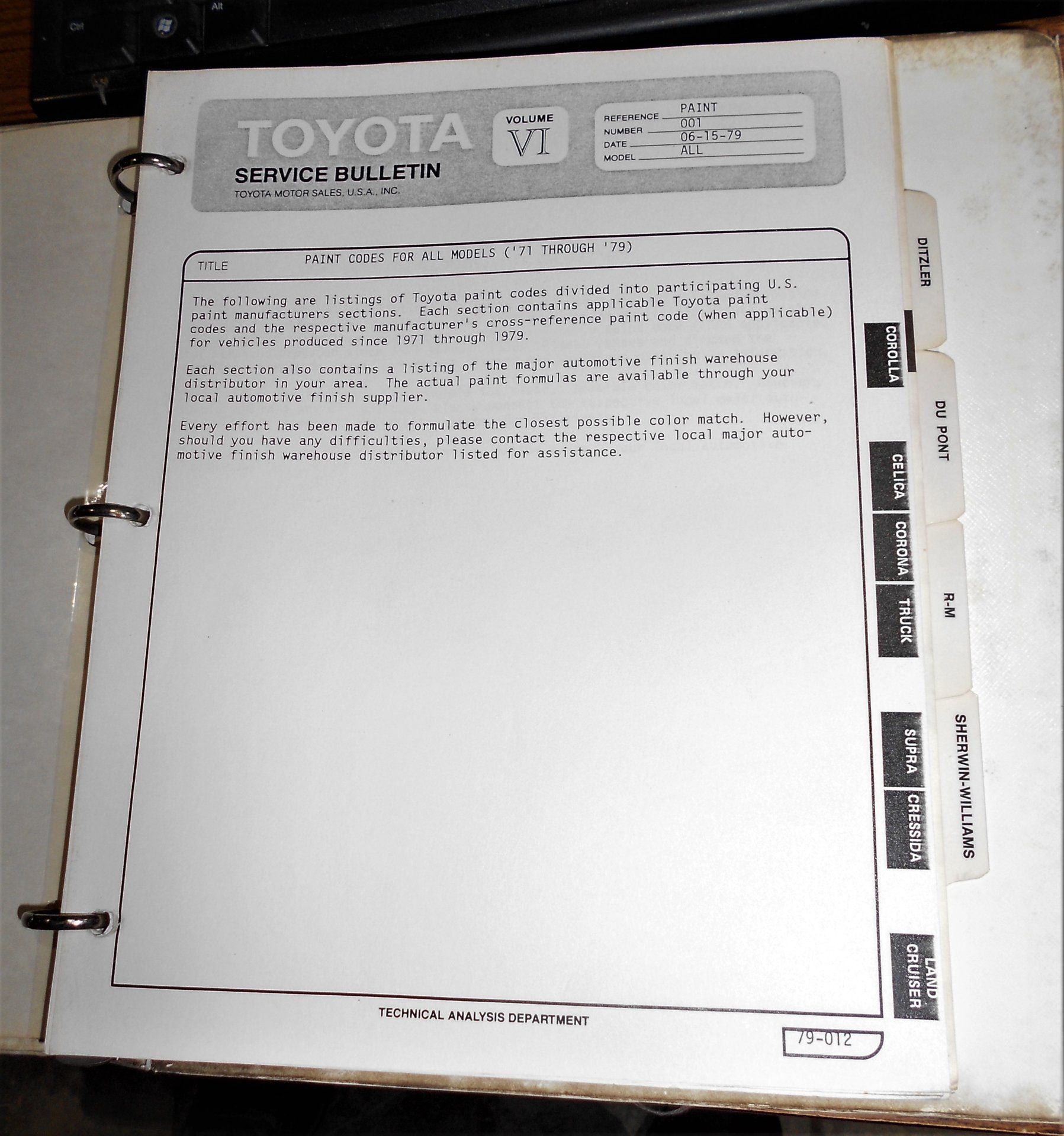

I Scored This in the Trash Can @ The Toyota Dealership i was working @ the time as A Technician Circa. 1995
It has 126 Pages of paint codes & Color names in Year by Year Format Starting in 1971 - Mid 1980's ( 1980's section in back 1/2 of book )
Every LandCruiser Color Code & Color Name is side by side as shown below to refer to .........
View attachment 1614154 View attachment 1614155 View attachment 1614156 View attachment 1614157
Do you have page 2 of the 3 page listing?
