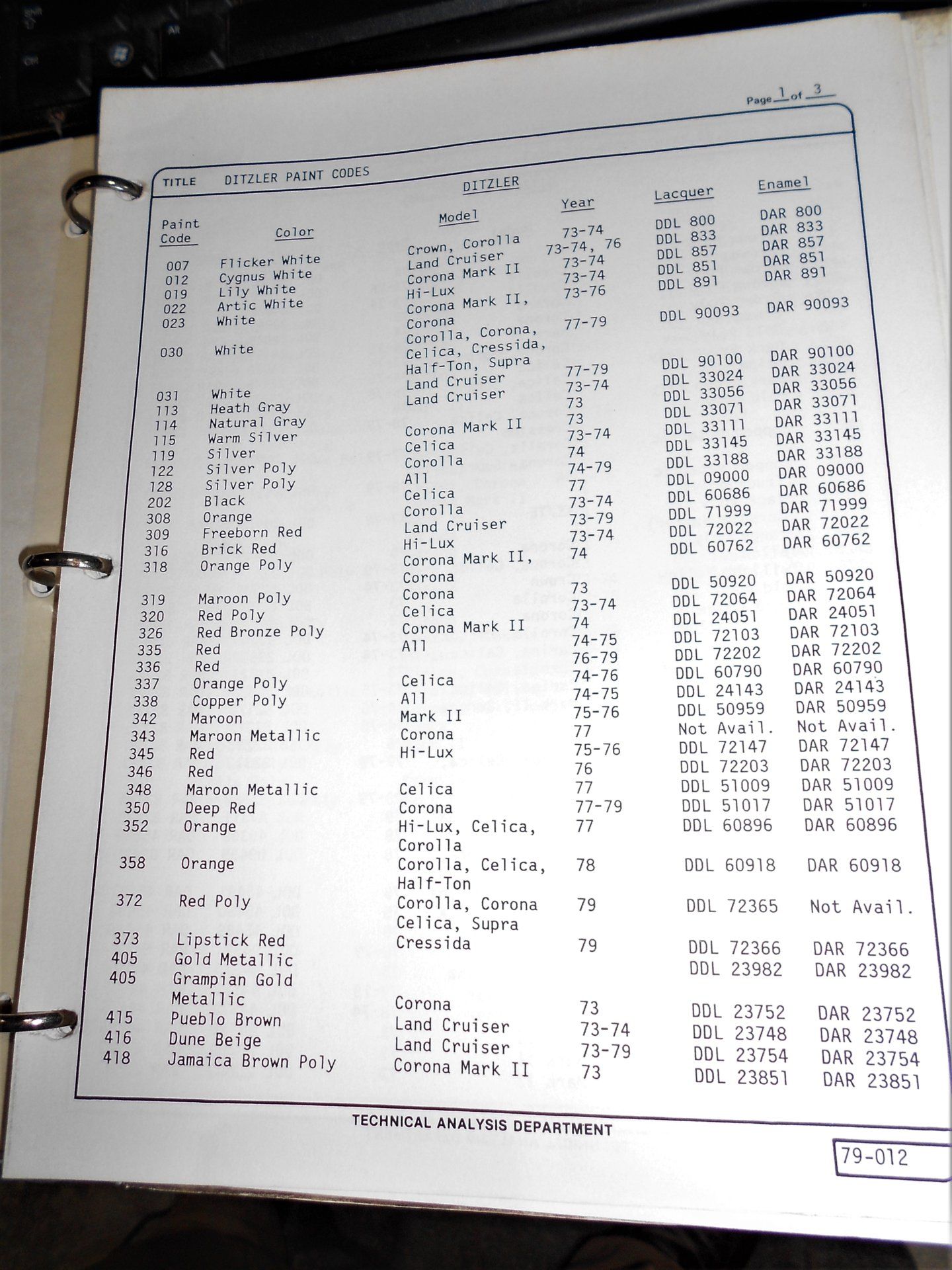

I Scored This in the Trash Can @ The Toyota Dealership i was working @ the time as A Technician Circa. 1995
It has 126 Pages of paint codes & Color names in Year by Year Format Starting in 1971 - Mid 1980's ( 1980's section in back 1/2 of book )
Every LandCruiser Color Code & Color Name is side by side as shown below to refer to .........

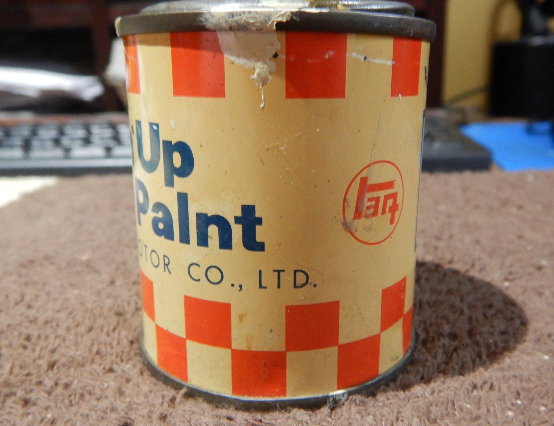

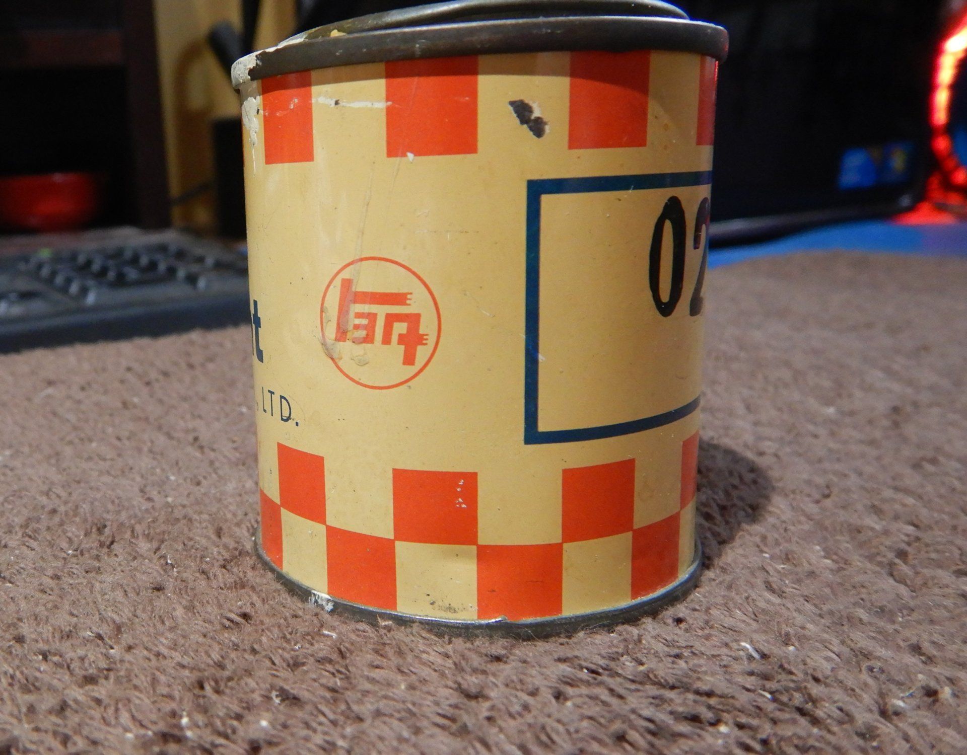

unknown year ?
1/4 pint size approx , paint code 023 " White "

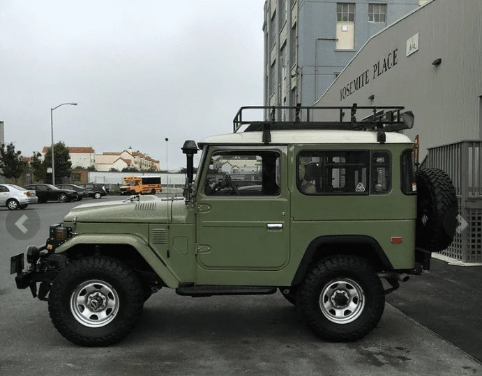

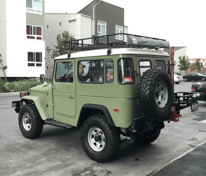

Does anyone recognize this FJ40? I'm looking to paint my 42 a sage green and I found this picture online. I know it's a custom color and not factory but I'm wondering if this is a fellow Mudder or someone on here that knows them. I'd like to get the info on where it was done and what paint code they used.

The color of this '78 is Toyota factory color : 6L4 'Light Olive.' ... PPG DCC line - code 47627
6L4 was a bit lighter and a shade more yellow. I ended up finding who built the rig and it was a custom color he had made.
