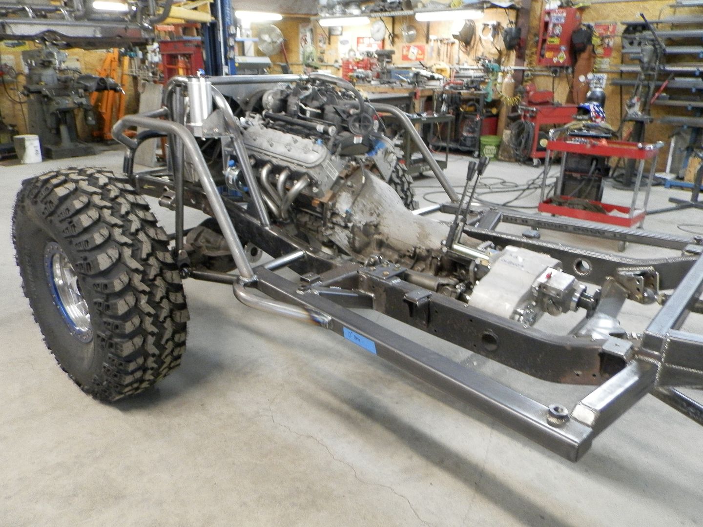

Thanks. There are not a lot of motor swaps (especially LS-1s) into series rovers documented. It has all been pretty much uncharted territory other than some info/help from Timm Cooper. Plus the 88" is so damn small.

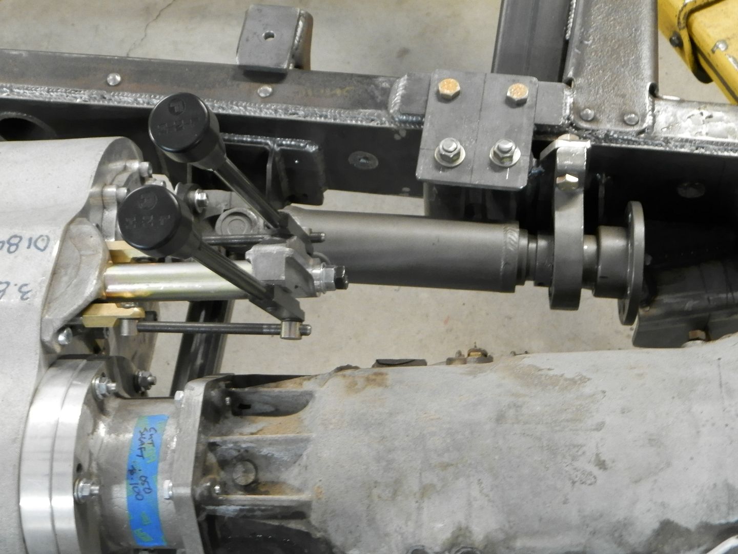

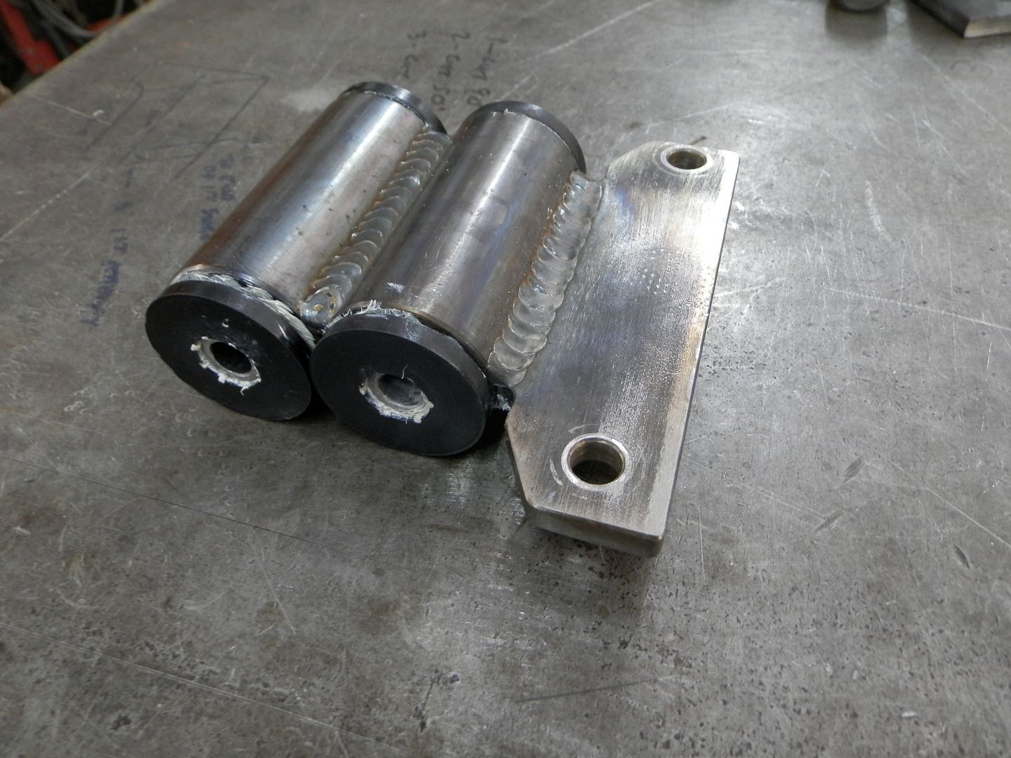

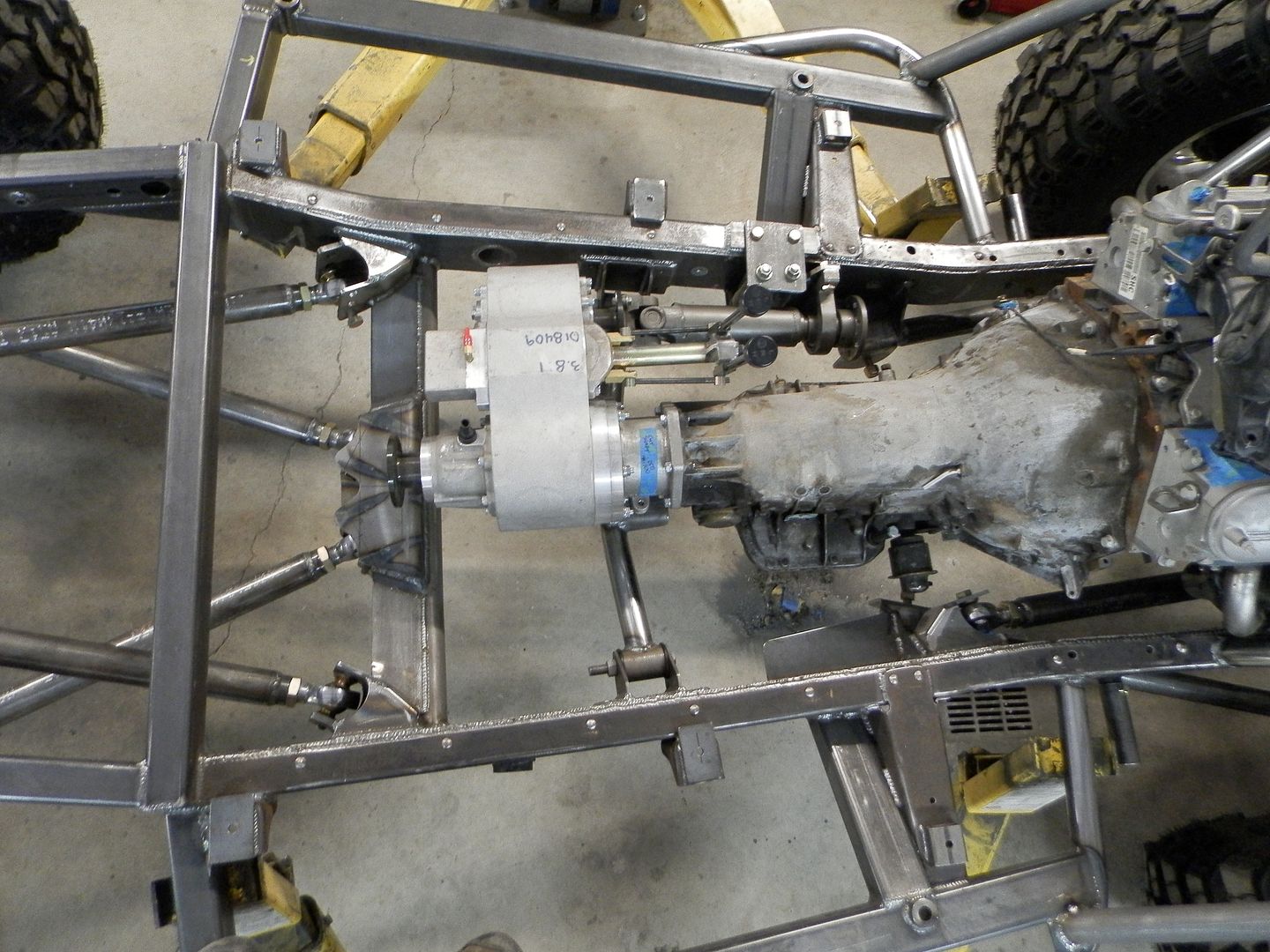

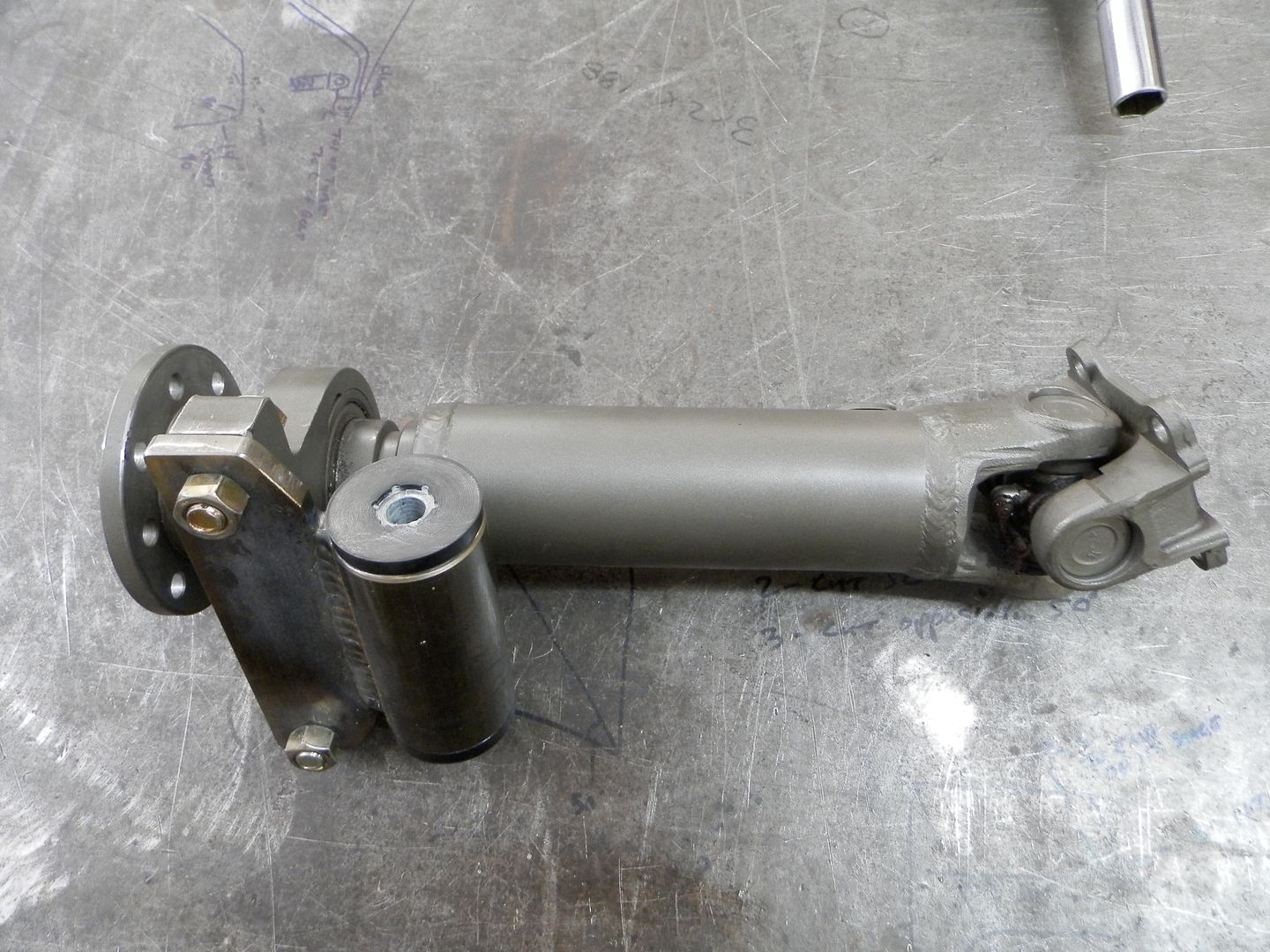

The short two piece driveshaft mounting was one of the last things I had to get done, and it posed a problem. I had only about 3 hours to get it done before the customer came to pick it up. It's pretty down and dirty, but it should work just fine. Please don't laugh...
I used CJ shackle mount bushings and cut the flange off one and stuffed it inside between the two outers. I cut a sleeve of .120 wall DOM for the inside of the bushing. The two are welded together to keep the rocking of the the bearing to a minimum. I had other ideas, but this got the job done.

I figure I had between 250 and 300 hours into the FJ project. That's just fab work.
