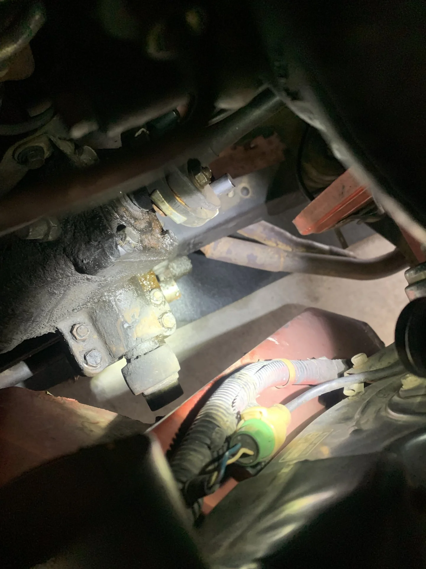

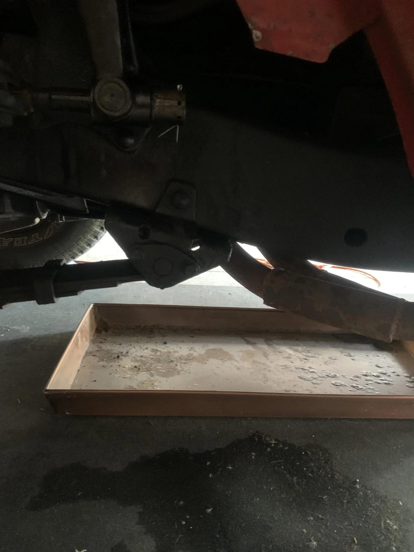

I have a 1980 cruiser, she sat garages all winter with regular start ups and a drive around the block about a month ago. I was under it today noticed a puddle under the driver side near the pitman arm. I followed it up to the brake booster area. The reservoir of brake fluid is basically empty… how can I tell if it is the brake booster or the master cylinder? I am a newbie but I have a good service manual, and might need a few diagnostic tips.

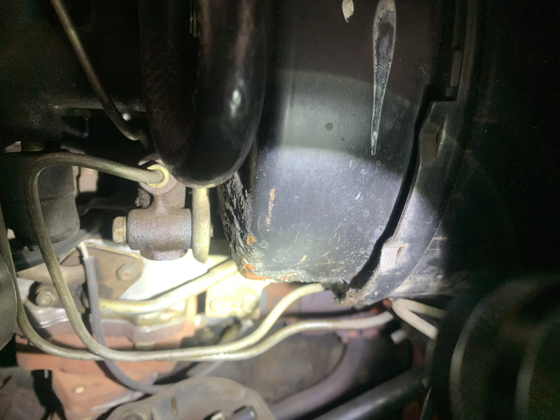

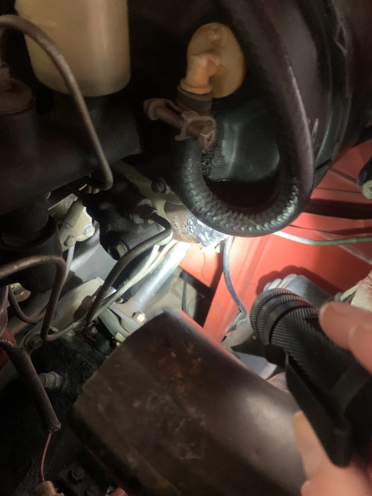

Here are better pictures…
It looks to me by the bubbles in the booster paint that was leaking down where the push rod goes in? Or maybe at the grommet and check valve.
It looks like the rear seal on the master cylinder is leaking and the fluid is running down the front of the booster. There is a little spot (indent or groove) where fluid can run out right there if a leak develops. Probably like a waterpump weep hole so you find out there’s an issue before there’s a big problem.
In short: you need a new master cylinder, booster is likely fine.
