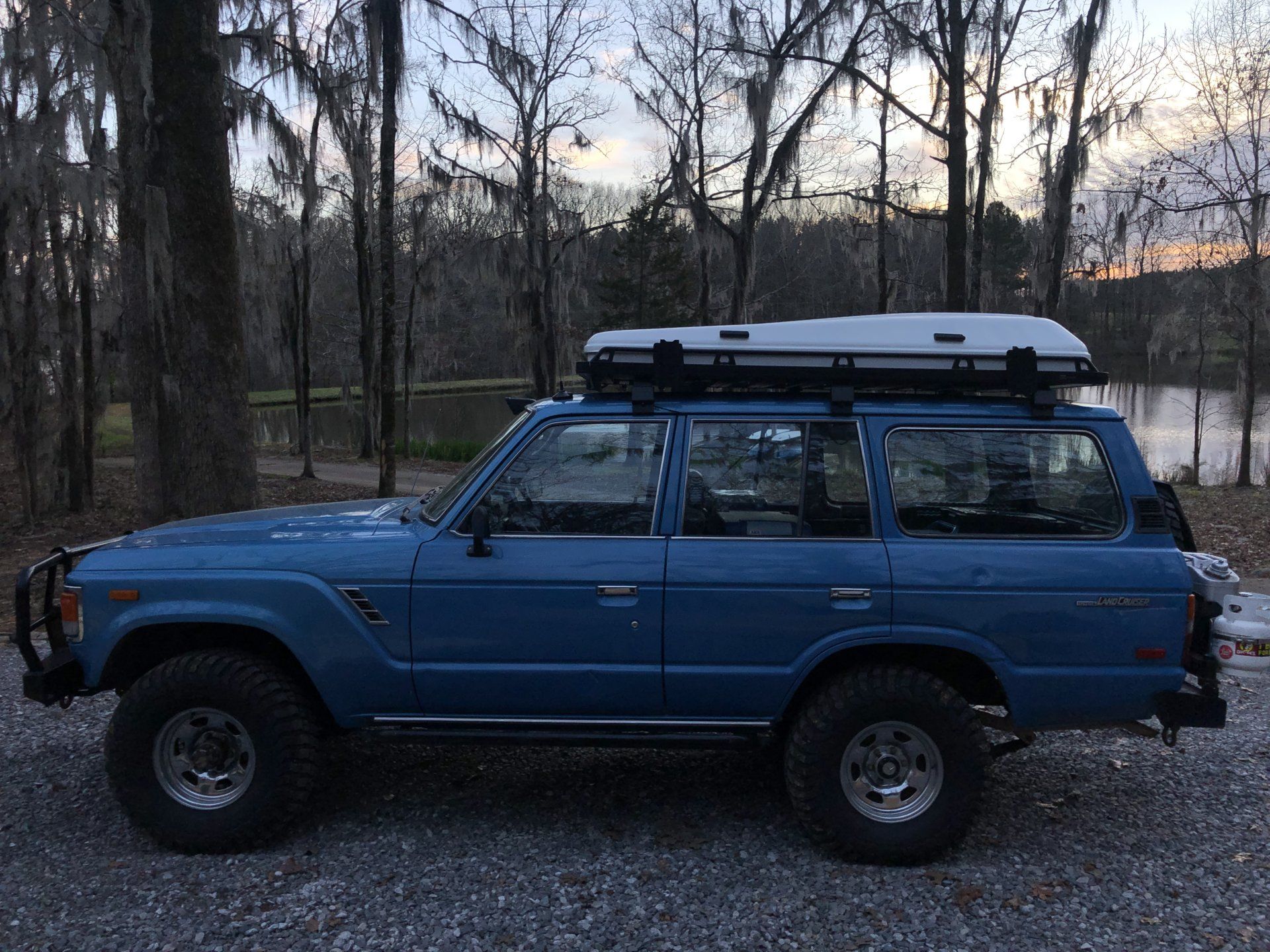

Any thoughts on 5125 vs 4600 for a heavier 40 series with 1-2” of lift?
By heavy I mean 2000 lbs on the front axle and 2600 on the rear axle (2400 summer)... empty. Plus possibly 600-800 lbs of passengers.
The perfect shock would smooth the bumps, control the sway, and not limit flex... sadly mostly road use, but I still want to be able to wheel it.
R5000s suck after nearly 20 years.
I ordered Iron Man Pro foam cell shocks direct from Australia recently. I’m loaded up and headed out on a 3000 mile trip tomorrow. I’ll keep you posted
