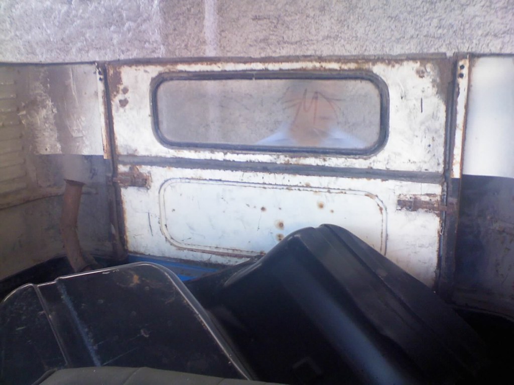

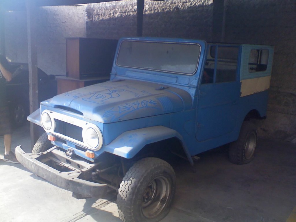

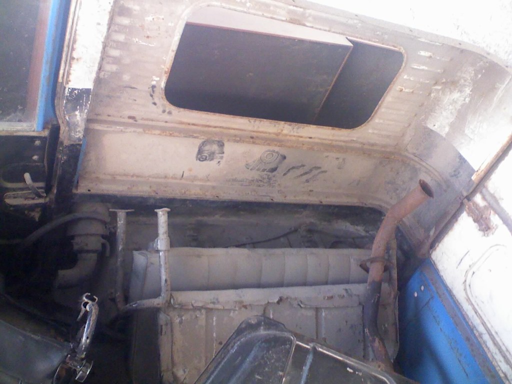

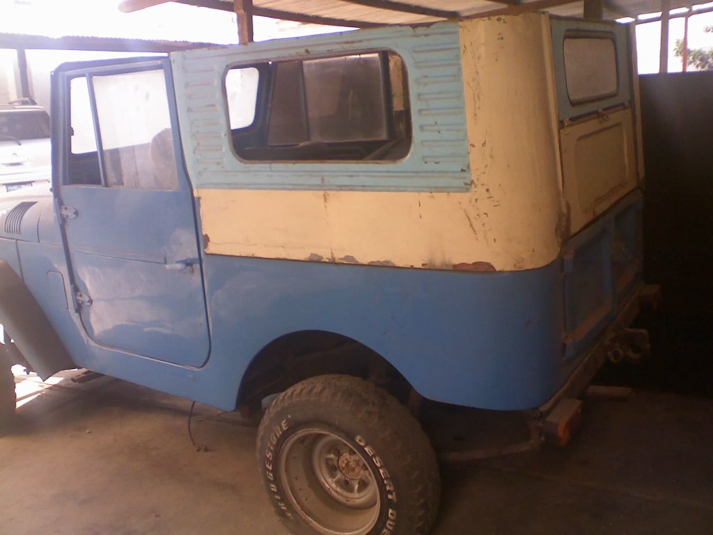

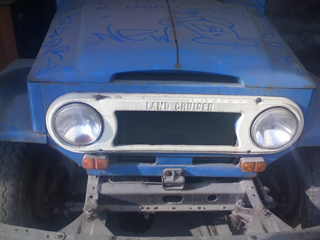

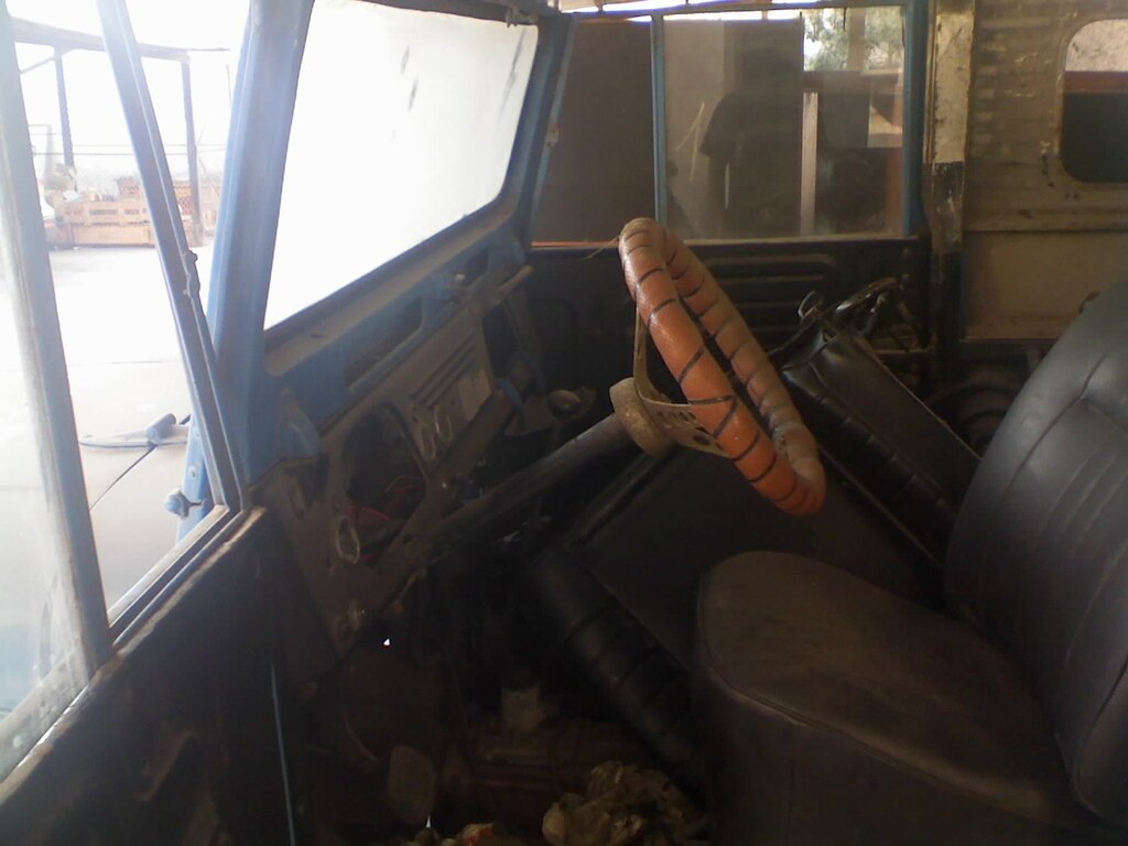

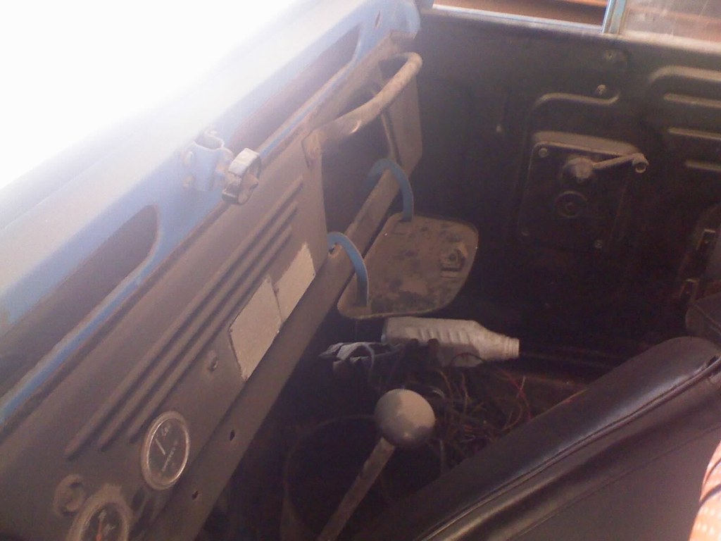

Hi I found this rare thing...
it is a mix from a fj40 and an fj25... the front fenders were remake, but the rest it is original?

It definately looks like a 25 tub and frame.

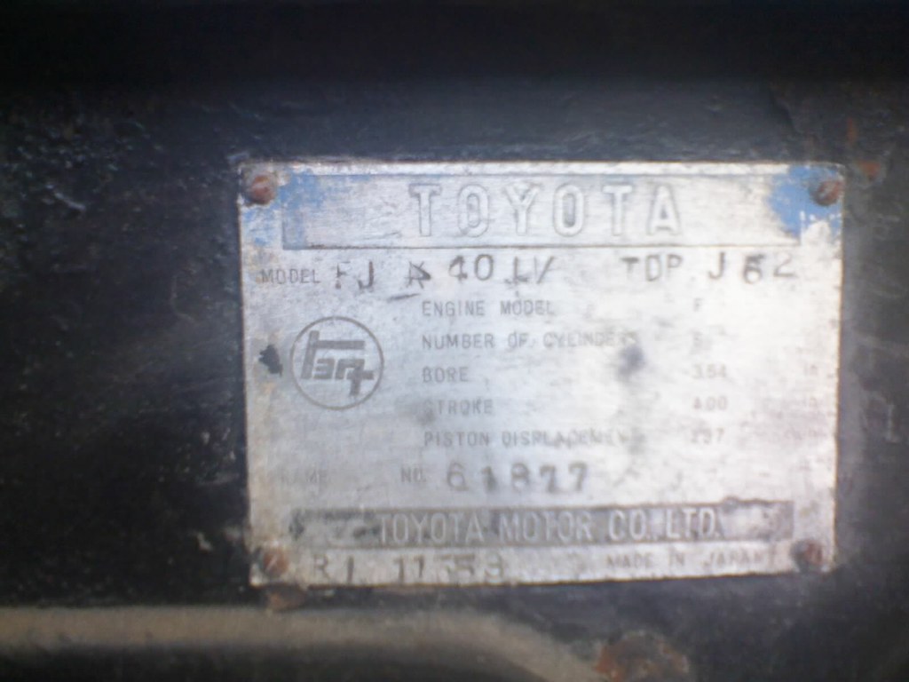

That has to be the crudest stamping on a data plate I have ever seen. Looks like that came from the 40 though. Frame number or pictures of the spring hangers and pics of the dash should tell the story.
What does it have for an engine and transmission?

If that VIN tag matches the frame number, that is a later frame under that tub. My 63 FJ40 frame number starts out 16XXX.
I see that also, the vin number is very hi but the year very low....:confused::confused:
i would be suprised if when you check the frame # it says something like 9-FJ25-61877L
could have been an overstocked fj25 that was retaged as an fj40? and bib put on ...some strange things get sent to the third worlds.
definatly fj25 in most every way...but...the bib
could have been a rebuild...and merged parts ...many different colors are on that rig

X2 on the VIN on the frame being different.
The early VINs had the engine number stamped around were the frame number is and just below would be the vehicle's VIN number. At least I think that how it is. All my FJ25 are from 1960 and I think the VINs are in the 20,000 to 22,000 range. Pretty sure they never number anywhere close 60,000. I think the VIN came from another vehicle. Not sure what's up with the model number FJ * 40LV TDP J62:confused: Seems like something from a much later year but would of all would of had a 2F not an F engine. It might have something to do being it was not imported to the US but South America:meh:
I think this is a early FJ25. Of my four FJ25 the two earlier ones have the same type of frame crossover piece on the front as this one while the two later ones have the FJ40 style. Beside the bib, three speed and diffferential it all so has later style seats sitting inside it. Not the first time a Land Cruiser has had parts installed off of other years. I started updating parts on 68 shortly after I bought it in 1974:cheers:
that was going to be my ?, hadn't ever seen a front crossmember like that.

vin tag would have read Toyoda do Brasil

and definatly never a land cruiser bezel :) or corrogated top :)

I was going to jump at Bandi, mainly because the one picture from the rear quarter makes the kick ven look tall and skinny..........Anyhow, I think the Bandi was domestic to Brasil only.
Long springs and the front crossmember makes me say 25. The back crossmember bothers me, it's way to wide, unless they added on when they did those turn signals.
I'm really interested in the frame number, I don't think it's the mythical 25/40 hybrid though, only because it looks like an earlier frame.
Alonso, we need more pictures, under the hood and underneath! :D
Makes me think of those old cars in Cuba...a little of this, and a little of that...I don't think it is as special as your other find...hate to say it, but probably just a mutt.

How much did you say they wanted for it? That bezel alone might be worth the asking price ;)
