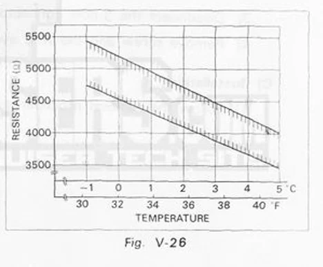

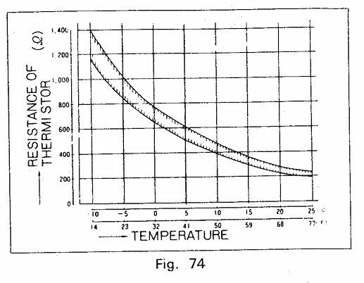

The thermistor in the evap works with the slide control to prevent freeze up. It could be something with that. I've seen one unit with a broken slide pot. I've also seen broken RPM and TEMP pots in the controller. Otherwise these are pretty reliable. Denso designed some pretty robust stuff.

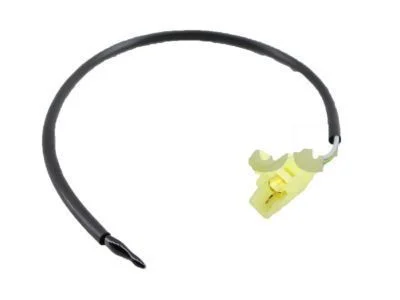

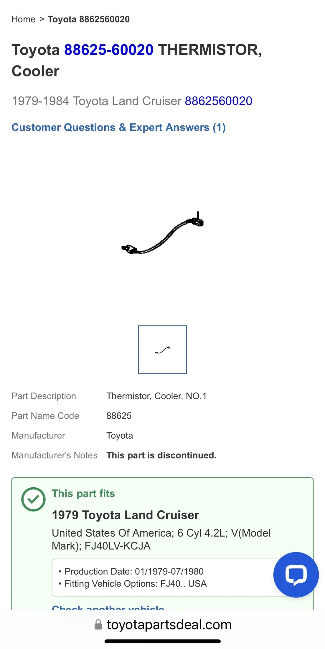

Hi Mate, I have a BJ40 series Diesel AC Unit. Can you by any chance let me know a compatible part/number for a Thermistor? I am unable to find the original. Also, where can get the 3K Slide Control component? Many thanks.
Is it 88625-60020?
That one is discontinued
Maybe one from a late 60 will work, not sure
