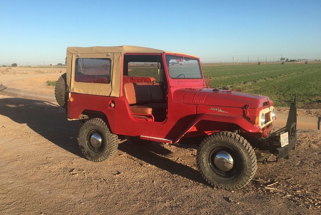

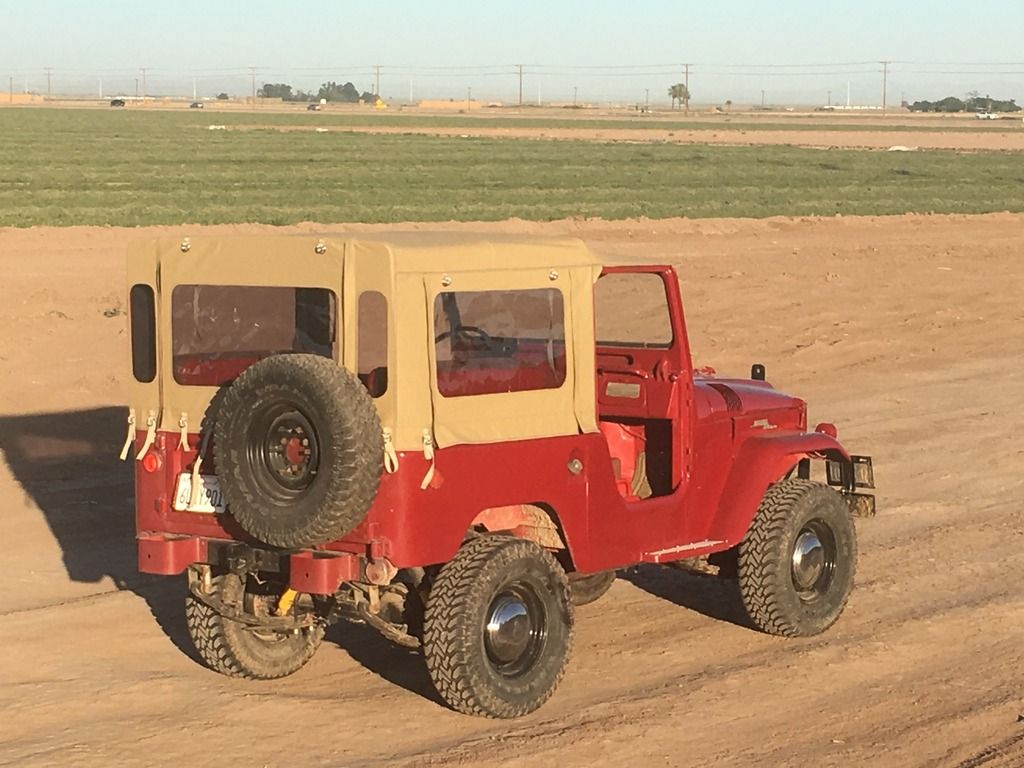

I am still waiting on bows. i do have a crappy mock set that i had the top on with, but they're not good enough to even put the common sense fasteners on the lower portion of the top. the pieces above and behind the doors are done and this weekend i pick up the door frames. just need to get someone with correct dies to bend the bows themselves. easier said than done. it's a tight radius.
the top made for my was light the 40 tops where the sides roll up. i do plan on having that remedies so the whole panel zips out like the factory top would've done with the common sense fasteners
Julie made a top for my 62 and it is a nice top. She was having trouble with the canvas so she used a newer material.
Thanks Sean for taking this on. Looking forward to see a accurate top one day.
Ken
Nice looking top. My biggest complaint is the side and back windows roll up and not removable. The dust in AZ is hard on the windows when rolled up. Have a few Kayline tops that I deal with.
I don’t know what the name of the color is. You will have to call Julie Roos.
The top attaches the same as a factory top but obviously it is not at all like an original.
Ken
@eltioloco - Is that Julie's PVC in Buckskin color?
Yes. I texted Julie this morning and she confirmed that my top was made with her PVC in buckskin.
