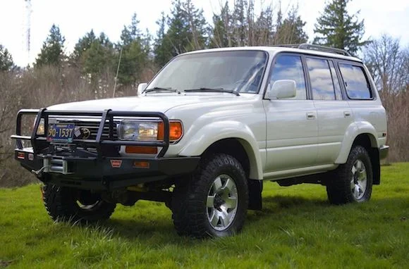

Which years can I run on my 1/92 fj80 without modification? I'm eyeing a set of 2014 Fj Cruiser rims. Don't want to use spacers if I don't have to.
265/70/17
Those will fit but they'll be tucked in under the truck and will look a little funny (IMHO) because they have too much backspacing. The center caps won't fit on the front unless you run wheel spacers. I run Toyota 4Runner 3rd gen Limited wheels on my '92 with 1.5" wheel spacers...

Is there a year of FJ cruiser rim that fits without spacers?

Fairly certain wheel spacing didn't change throughout FJ Cruiser production and thus, the wheels should all be spaced the same.
The fj wheels will fit. They're tucked in a little bit it's not horrible. I've used sequoia wheels with the same backspace as fj wheels on two of my 80s and had 1.5" spacers on the first one for a few years. I had zero issues.
If you use spacers Make sure theyre a quality bolt on type and never the "washer" type. If they're torqued properly and you check them after the first hundred miles and then every oil change for looseness you should be ok.
Appreciate the info, how tucked in are we talking? I removed my flares so I'm thinking they probably would look fine without spacers. Also, if stock offset is 8mm and these cruiser wheels are 15mm won't I only lose 7mm per side?
