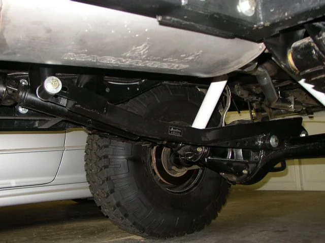

Hey Weak-Link,
Looks great, you've inspired me into building the same.
Jim's quick aint he ;)
I have a similar setup on my 62 behind a big block. I have had no problems with it bending or breaking parts. I like the look of the single bar setup much better than the ladder bar also.
attachment.php
i know it has been mentioned but having the trac bar mounted on 2 places on the axle at first i was confused thinking that yall meant like a "y" shape... (forgive me im still trying to loose the stupidness from the heep days:flipoff2:)
anyway now that i see it i understand the design (one mounting point one both front and rear of axle) and it seems to be a good design. ok well my question is about the point at which it mounts to the crossmember. i understand this meeds to have some movement but how much does it need? in other words how far does the "drop down" peice need to extend? like in gary's pic it drops down looks like allmost level with the driveshaft.
i know he said he has had no problems but it looks (looks from a visual point never seeing it work and making my own asumptions) that whenever heavy skinny pedal was applied its gonna cause that axle to twist toward the back or the rig while the tires run forward. thus making the "drop bar" then extend untill pointing at rear axle. so the longer the bar the more wrap it would allow... because if it extends out its that much farther the axle can aim the pinion towards the rig. SO all that being said what is the cutoffpoint in length that one would want to run on that bar? obviously not to short for sus. flex but not to long due to wrap and broken parts.
Sorry so long just talkinmg outloud if anything i have typed is incorect please let me know. trying to learn.:beer:

I wanted to edit this post as i now know the mechanics of this design.
when torque is applied the bar will press straight up on the shackle or "drop bar" as i previously called it and will not allow it to twist back towards the axle like i was thinking for some reason at the time. same thing applies if in reverse it would just pull on the shackle. the idea of the shackle is to allow up and down travel of the axle during suspension movement and still allow proper drive line angles.

I don't understand the mechanixc of it but everything I read said to make the anti wrap bar follow as close to possiabe the angle of the drive shaft.
i totally can understand that what i have a issue comprehending is teh drop down the farther it drops the more wrap it will allow. now if the crossmember were to drop instead of a bar i think that would be more efficient due to the fact that the drop bar would be shorter and it would still allow for the flex and also stop the wrap..

No, with a shackle arrangement, no wrap is allowed.. Forward to back movement is permitted, not up and down...
