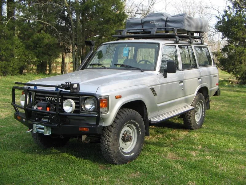

Sorry for the confusion....this is how it is supposed to be.
Not to hijack this thread....But does anyone have an specs on this truck?^^^^^
Build thread? Tire specs??
I am assuming OME lift and 16 inch steelies
Trying to figure out if those could be 235/85r16's or 255/85r's ?
Actually those look like stock FJ40 steelies (pizza cutters) which are 15x5.5 I believe. So those KM2s would be 33x9.5x15 from what I gather by the look.
