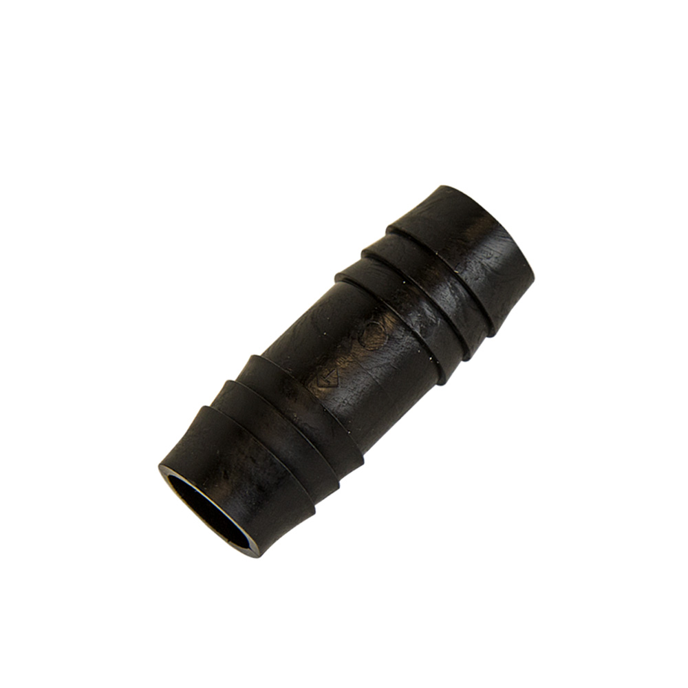

I think all of us should carry a pair of capped 5/8" hose nipples in the car (& hose clamps) to be able to bypass the heater core if it blows on a long trip away from home.
5/8" union would work too.
