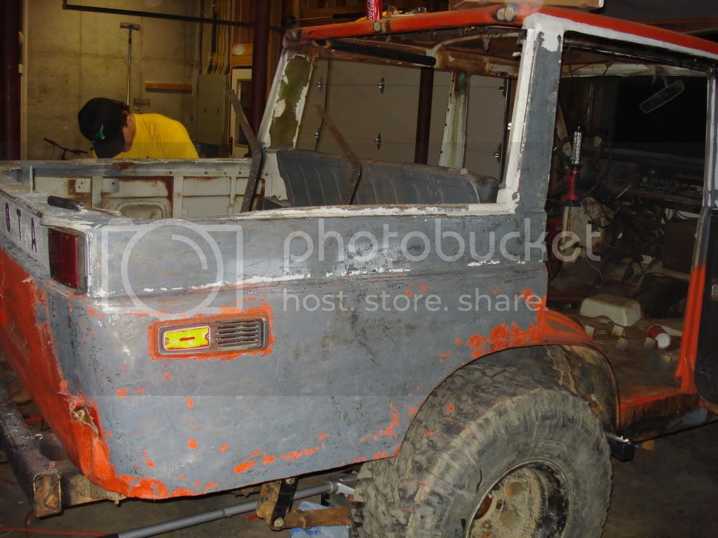

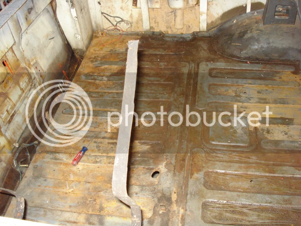

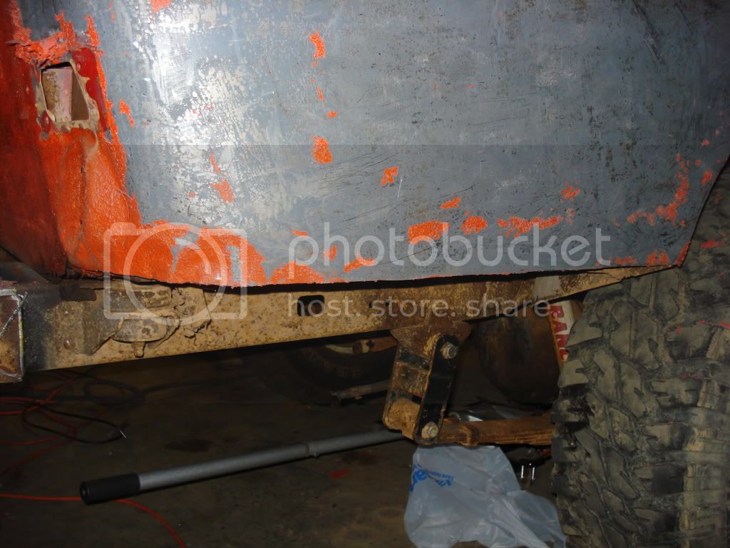

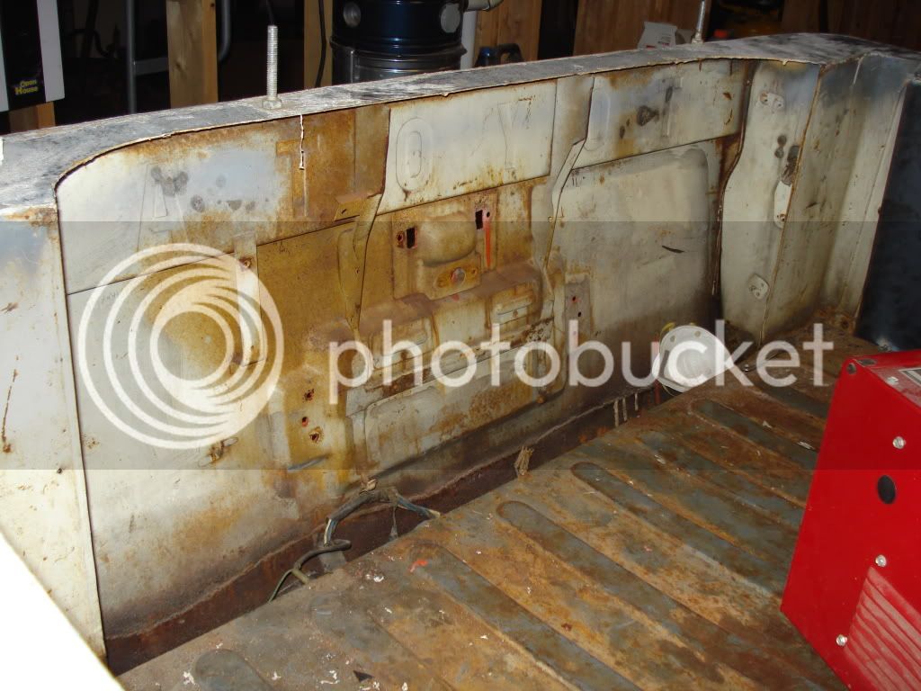

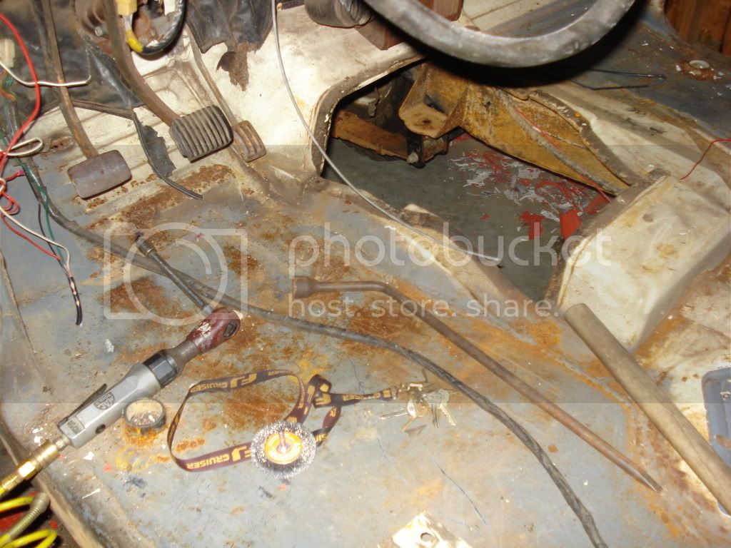

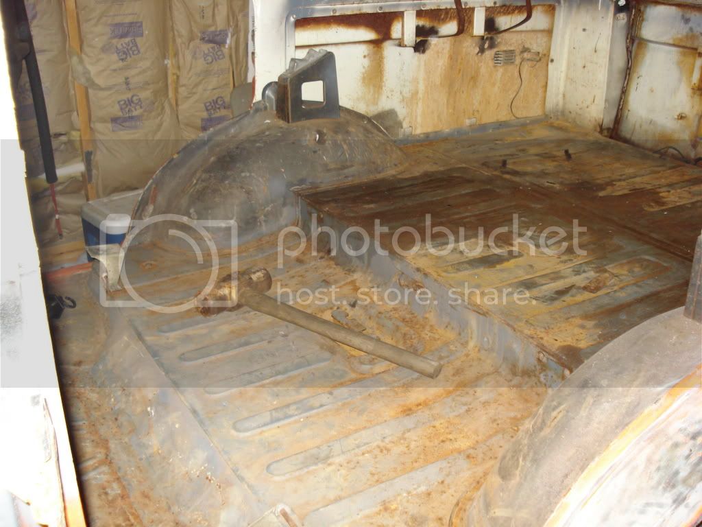

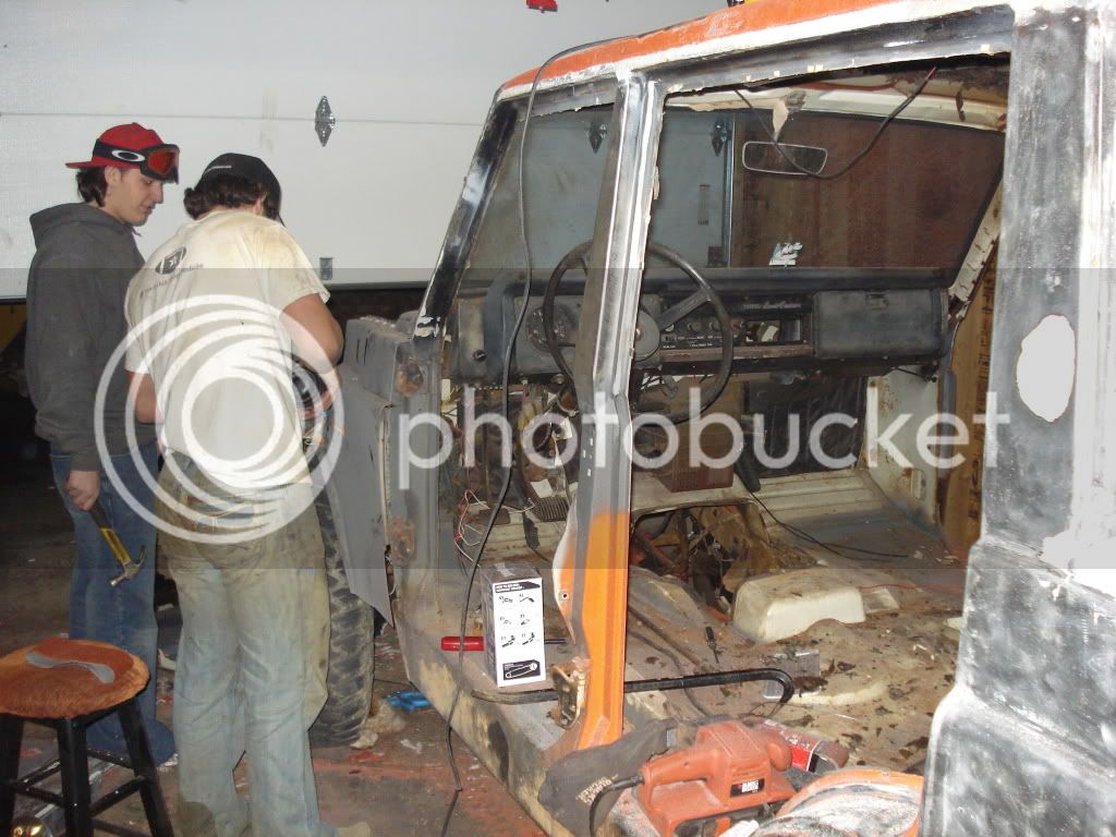

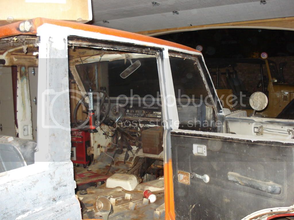

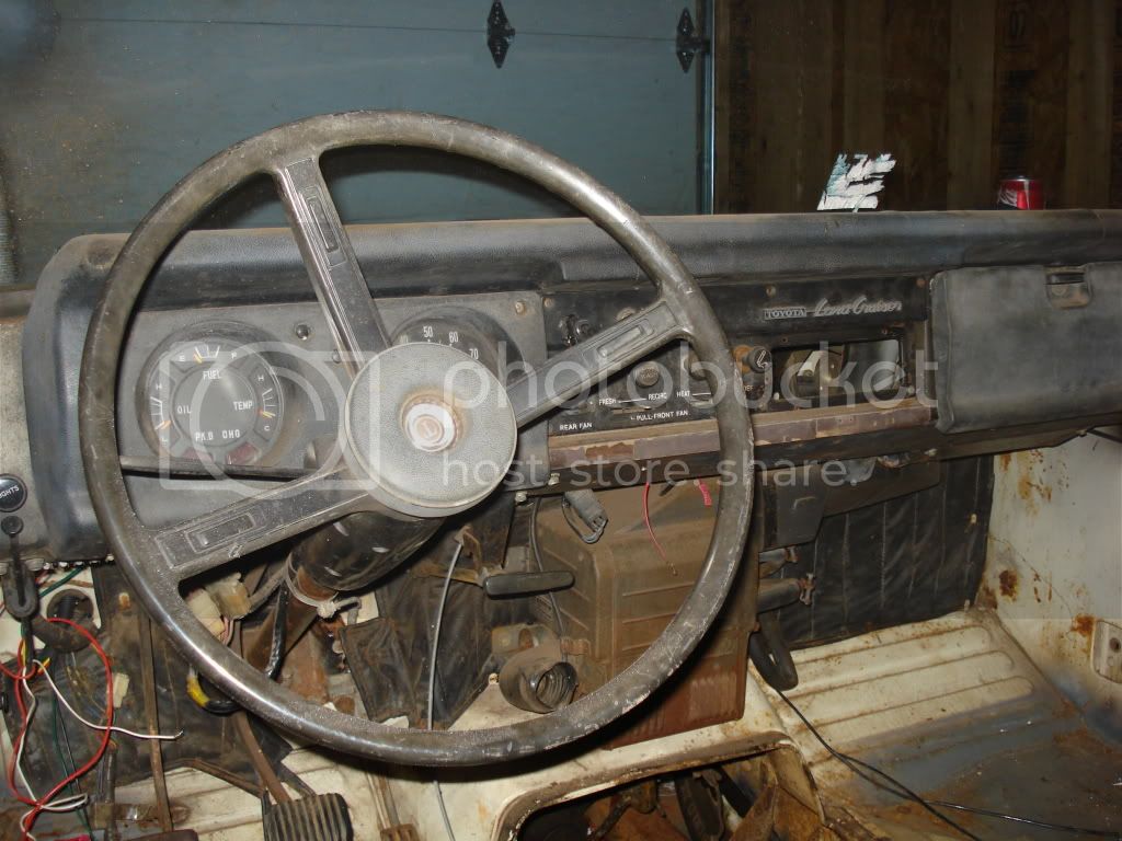

Heres some pics so far of the teardown
I'll have some more progress pics up later, for now we are just getting all of the hood s*** off.
Wow - so you bought that thing huh?
Don't rub against the paint - it will make ya bleed!

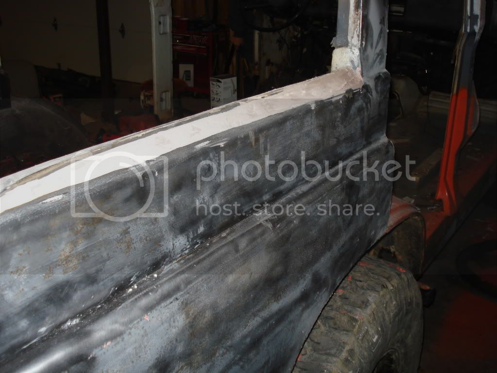

You might be able to pressure wash the bedliner off with a strong arse pressure washer. It has been done before on a 40 I know of.
Are you removing the internal cage too? IIRC the A or B pillar is really close to your noggin'.

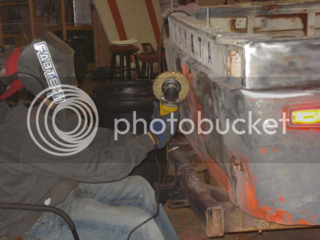

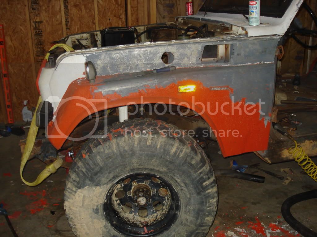

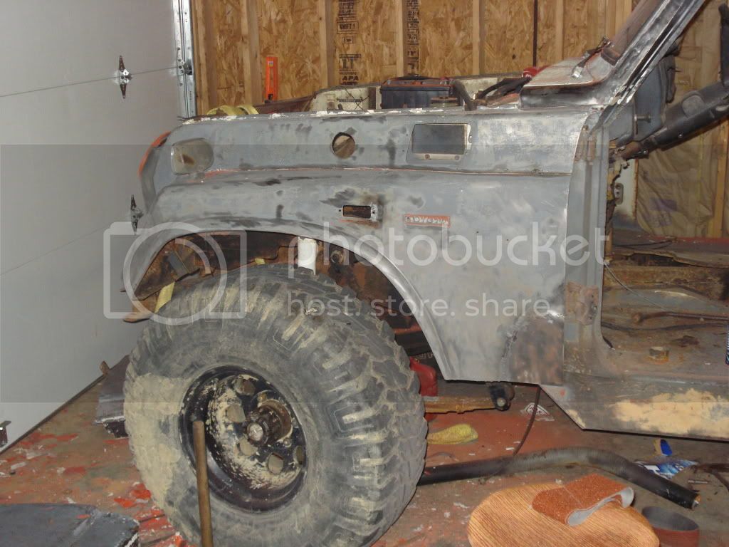

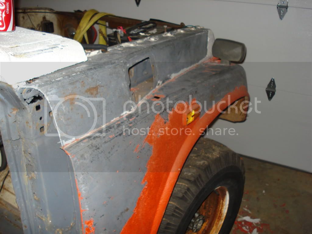

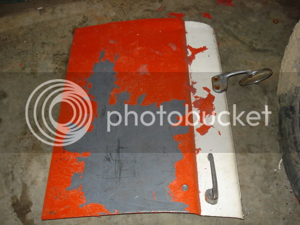

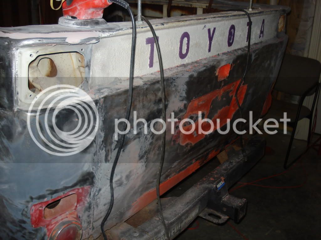

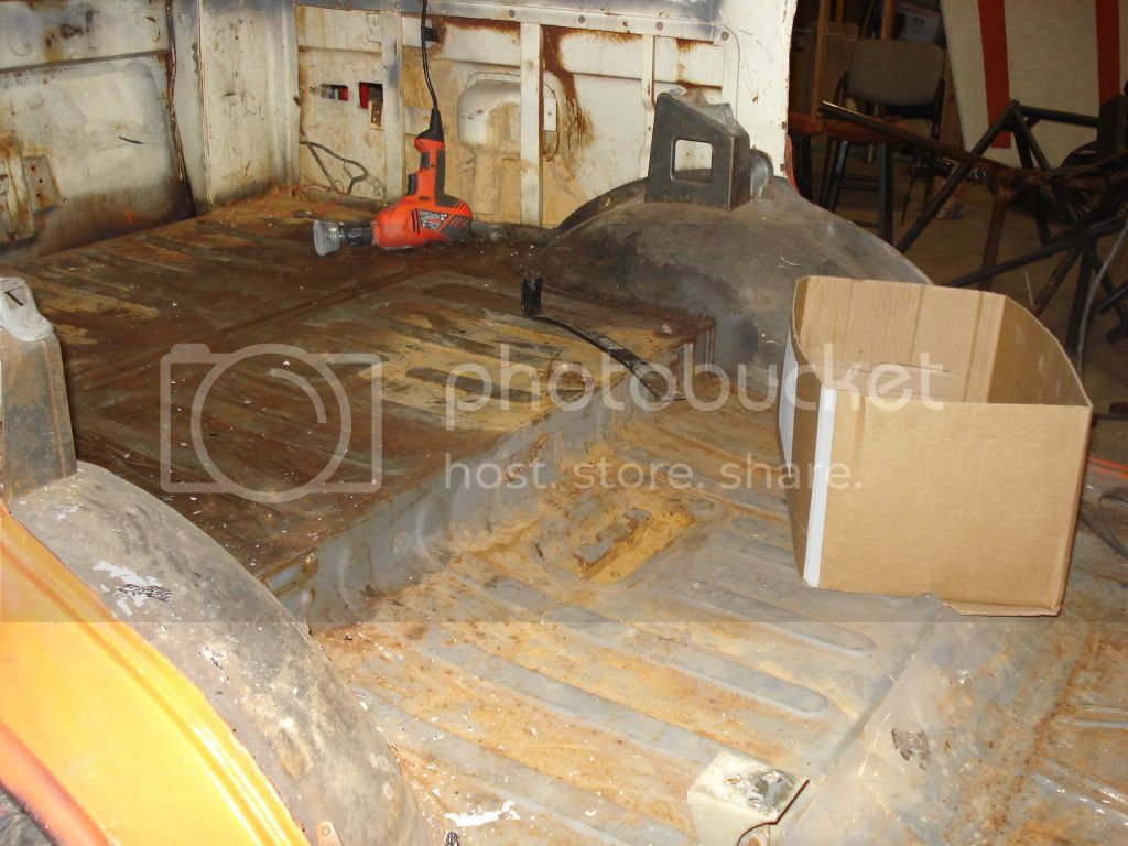

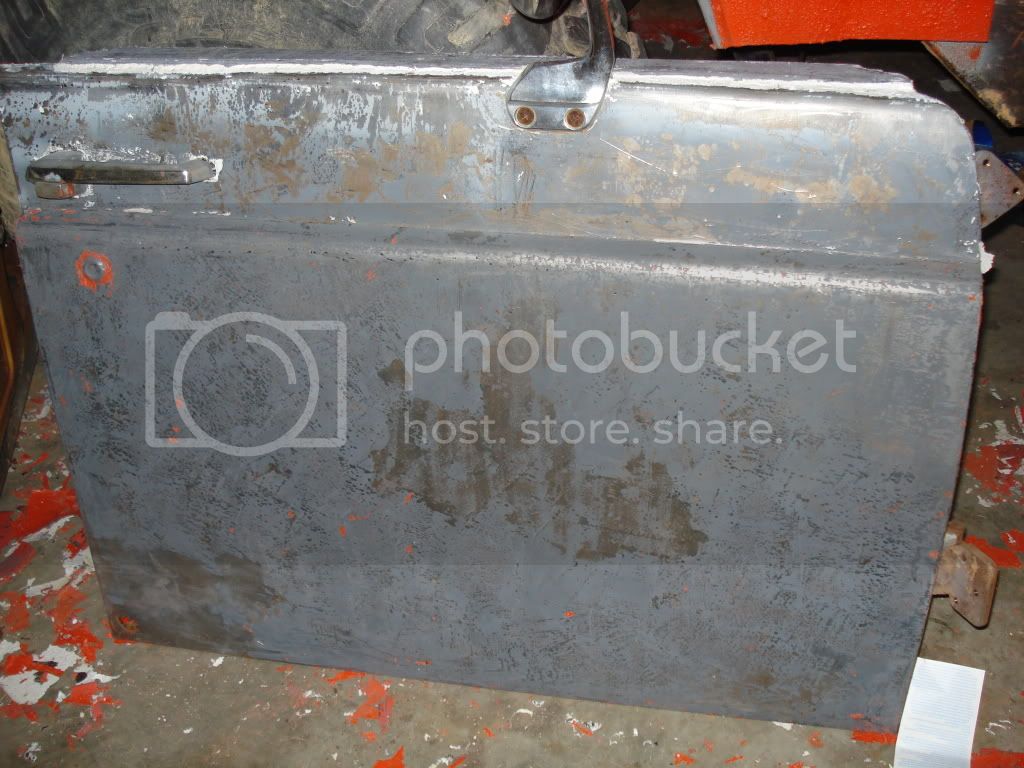

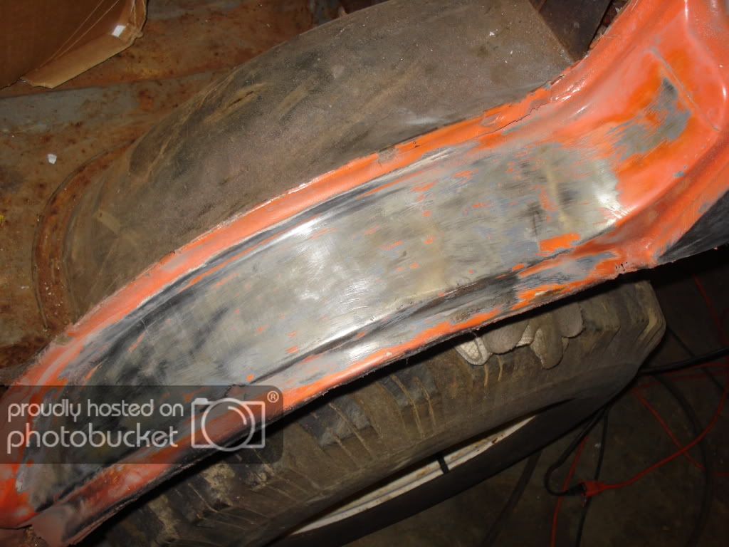

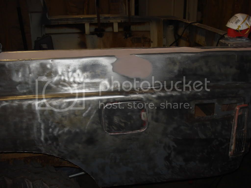

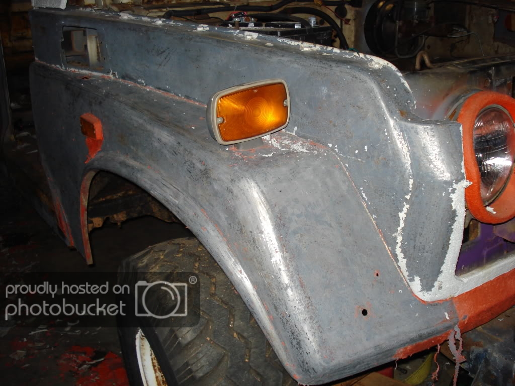

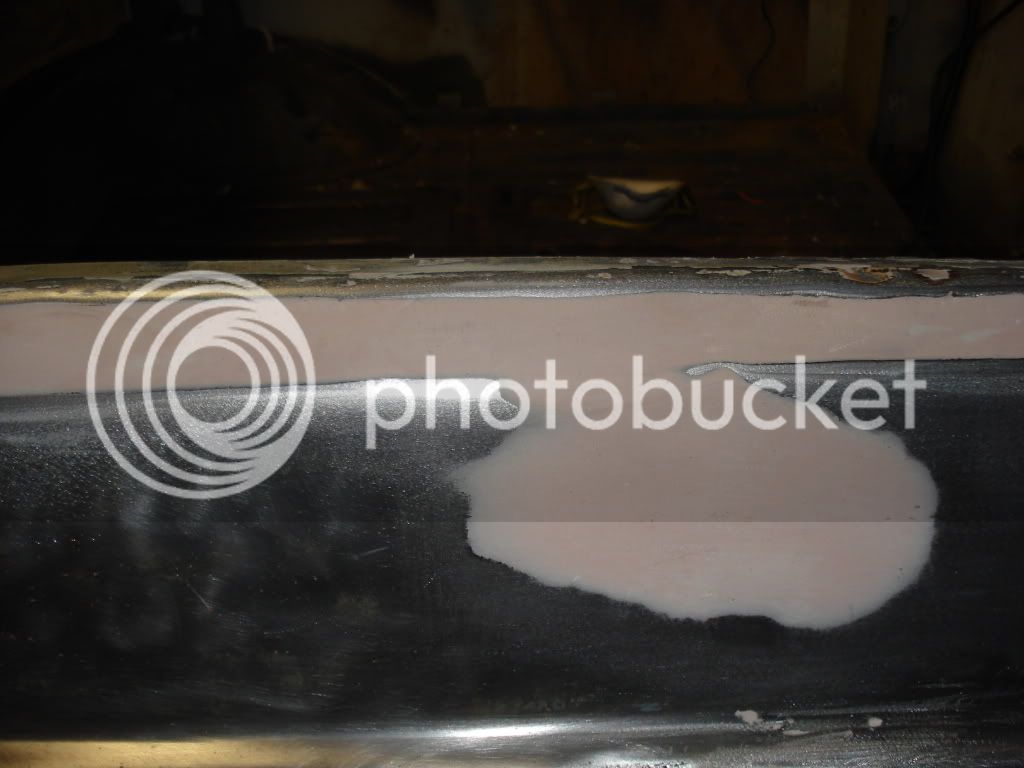

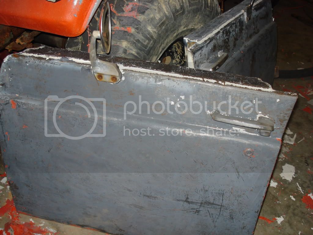

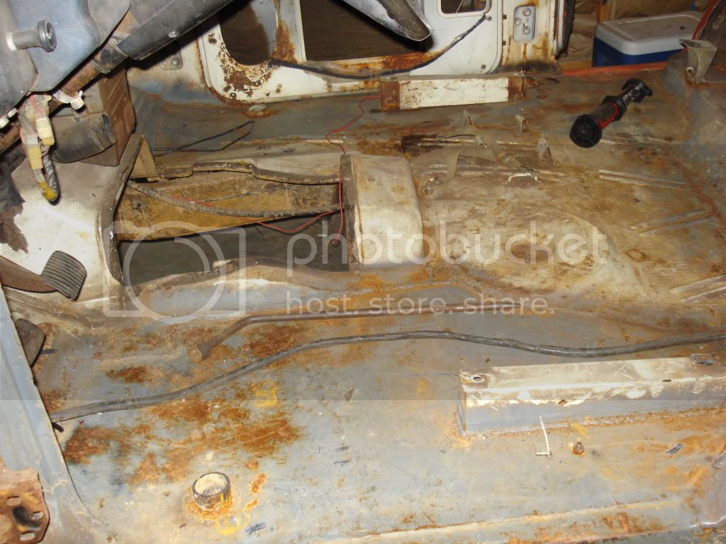

more pics of progress sorry if its boring

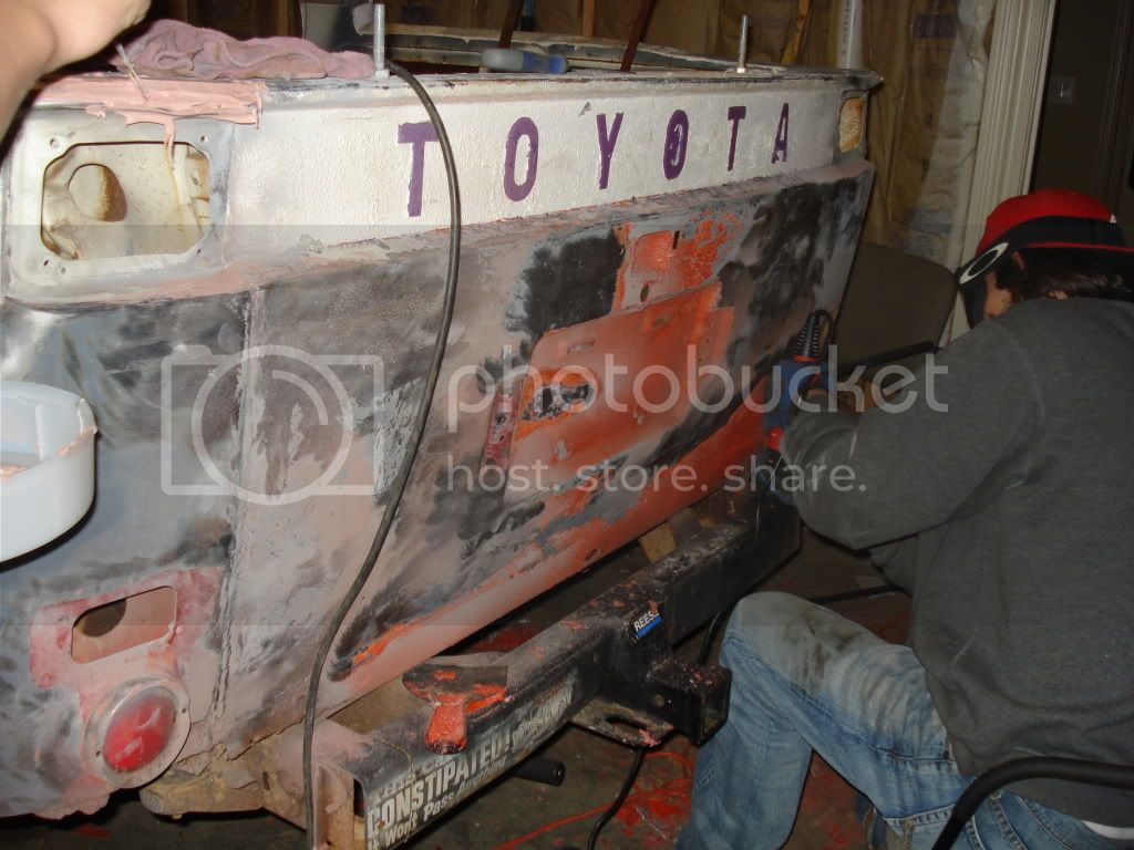

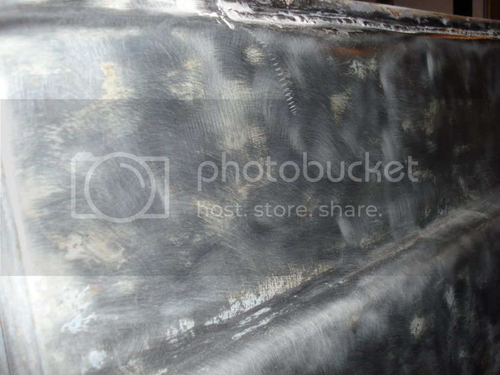

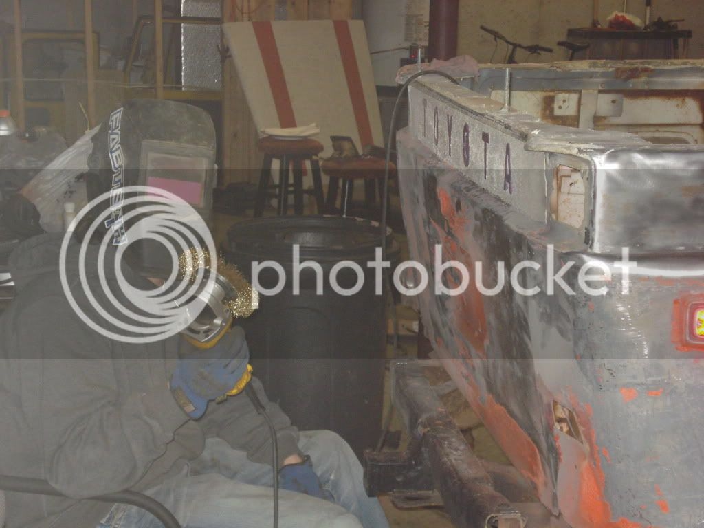

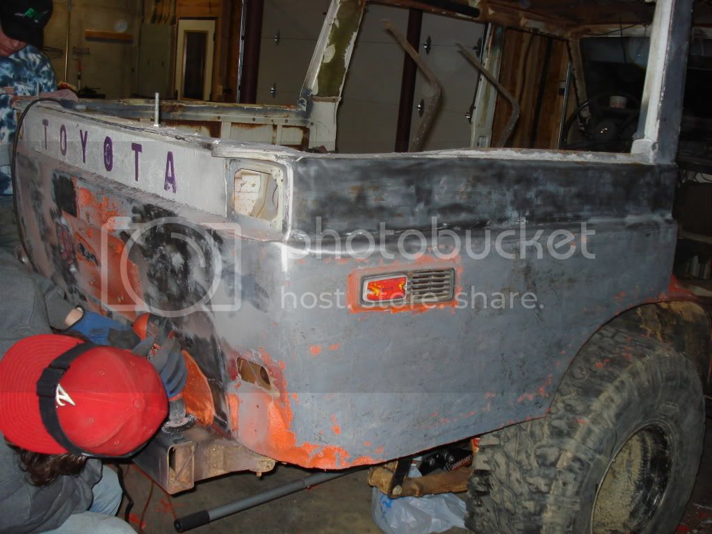

this pic shows how large of a wire wheel we had to use to get this s*** off, HOURS OF LABOR

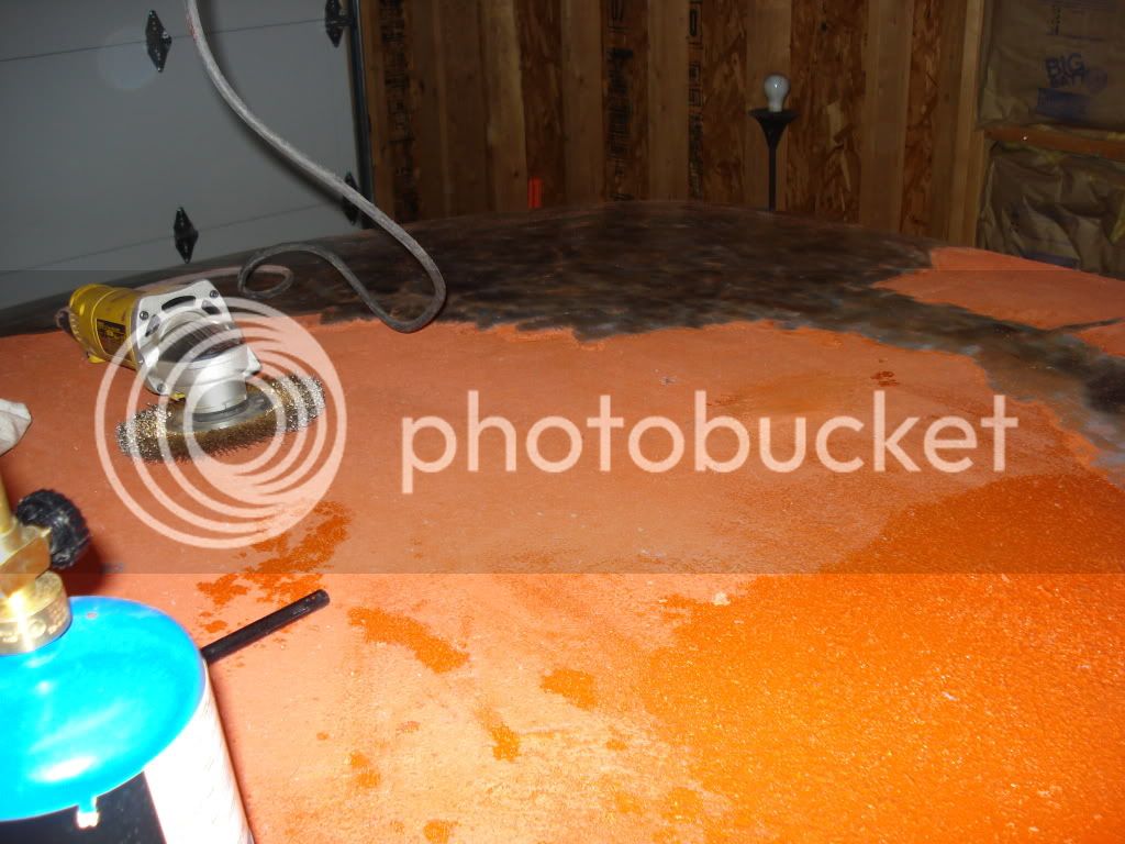

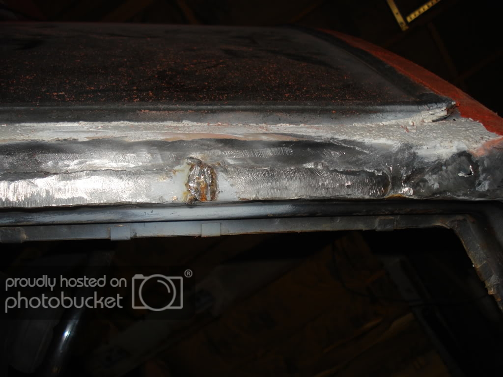

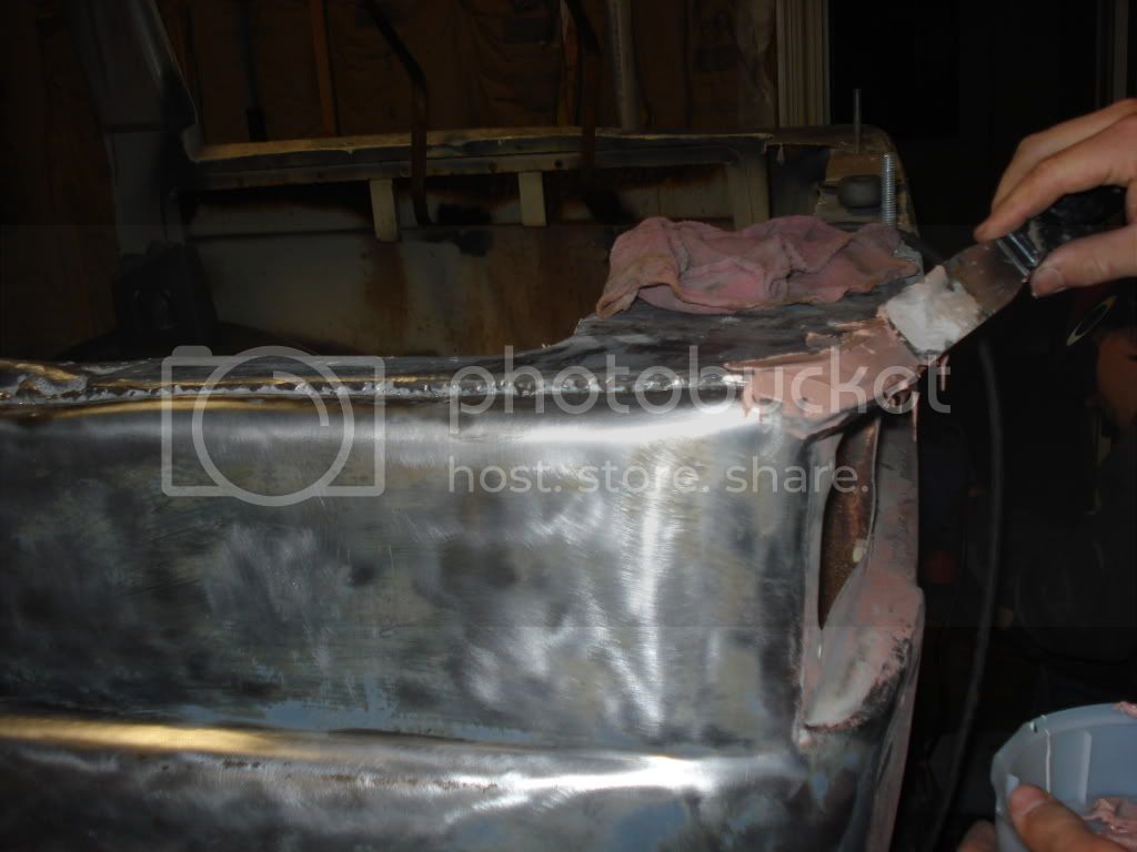

The roof has been the hardest part by far....

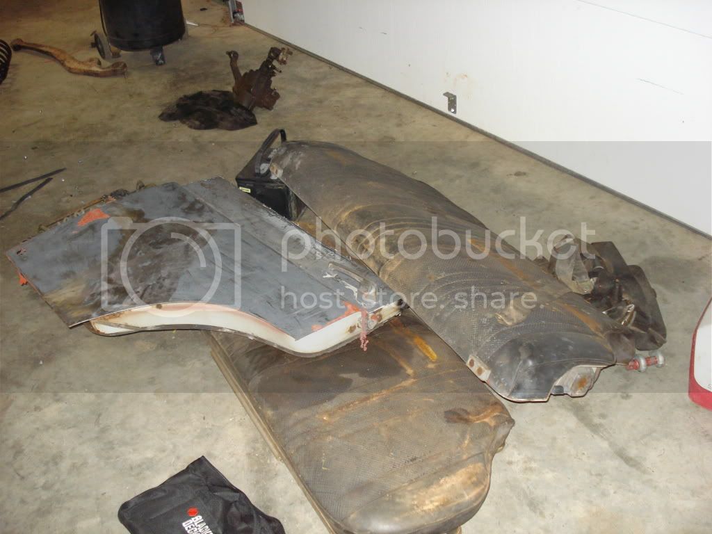

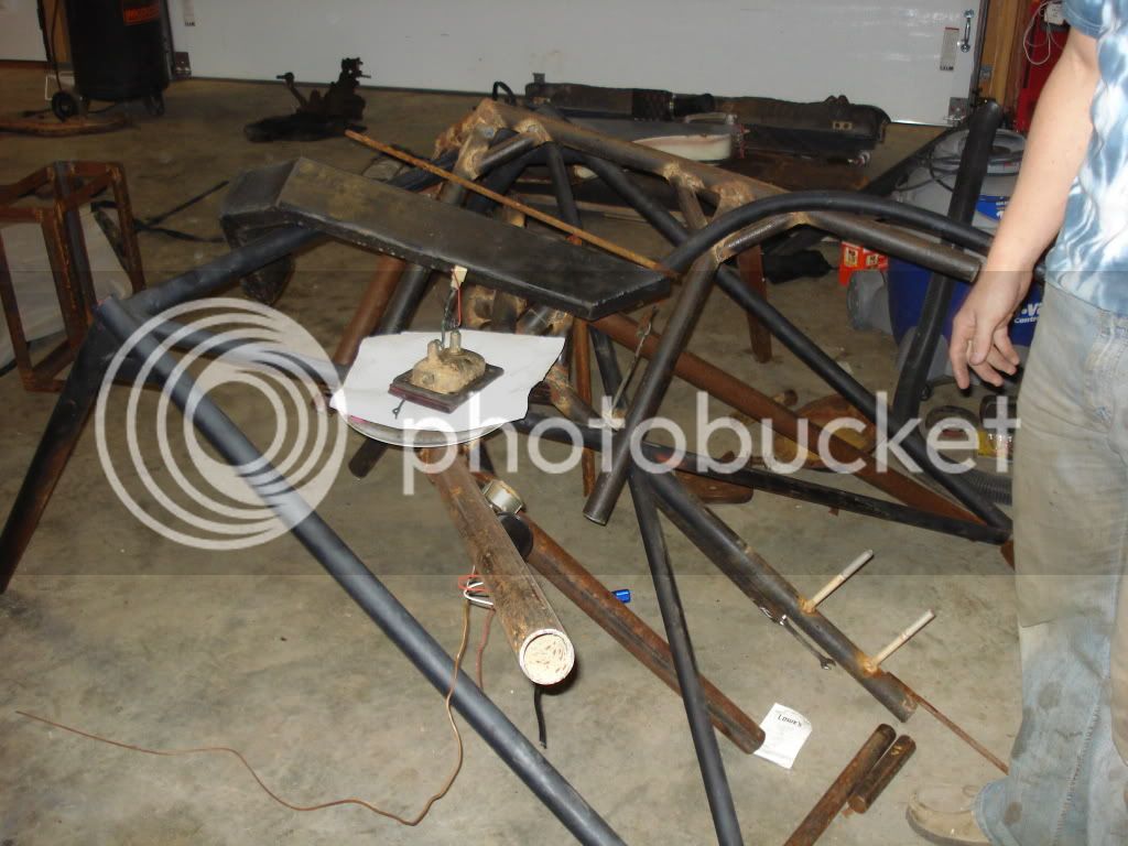

All of the scrap steel removed from the pig

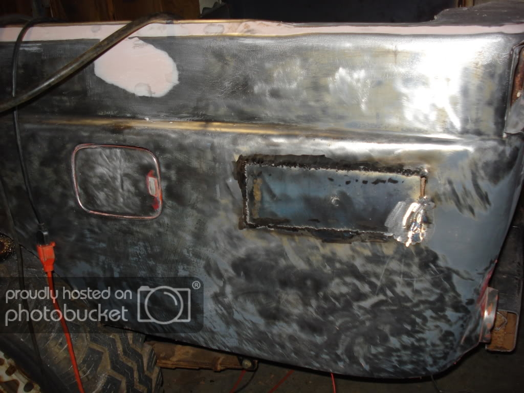

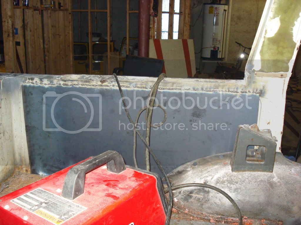

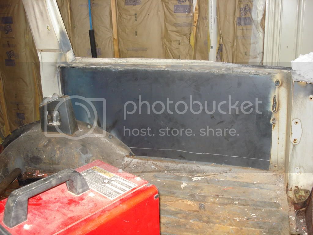

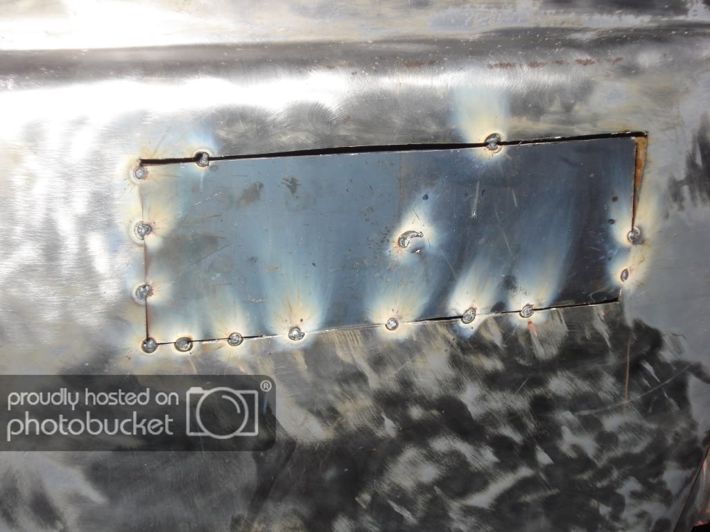

welded up those huge gaps in the sides of the bed.

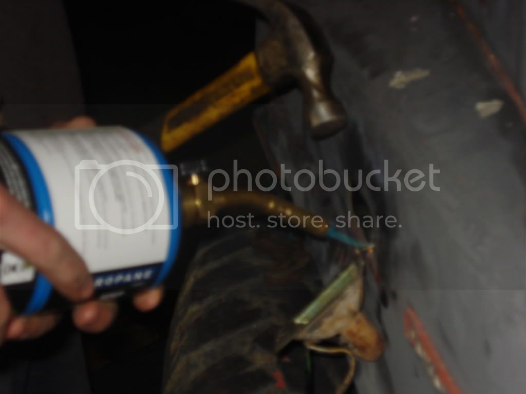

trying to have fun with removing a turn signal light after a long days of work

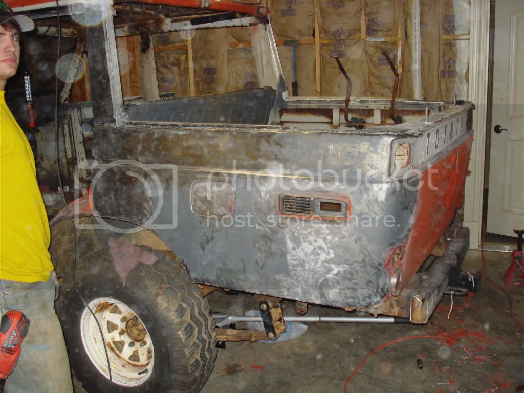

more riggin of the hood ass pig, idk what the po was tryin to do here
one man's masterpeice is another man's nighmare huh? i'm glad to see you saving that pig, i've seen so many threads about it in the past i feel like it's an old friend or something ..... so is this going to be a trail rig or what? have you considered bobbing the rear end to get rid of some of the overhang? would look cool if you cut it and re-attached the tailgate part i think
