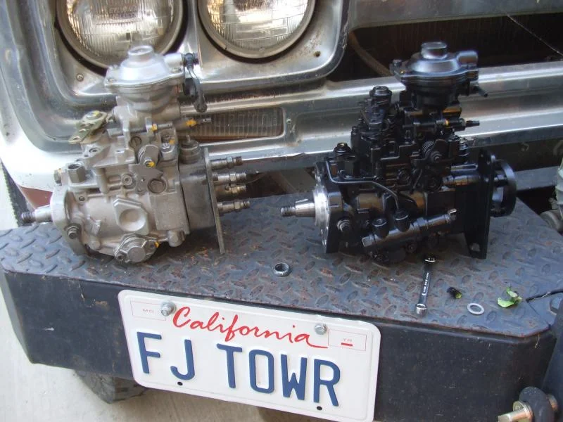

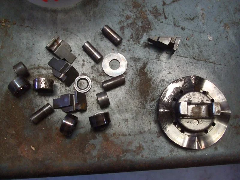

I have been fighting fuel pump issues since I attended the Alaska Cruiser Trek. They actually started the day before the Trek at a campsite. In the mean time, I found another pump and had it rebuilt. I pulled the original pump and installed the new pump. I was connecting the throttle cable and realized I had the wrong pump. It had absolutely No return springs. The Injection pump company sent me the wrong pump as well as the sent my pump to another customer.
So I had the original rebuilt.
I believe this may have been the core of more than a few of my problems.
Thanks Skip

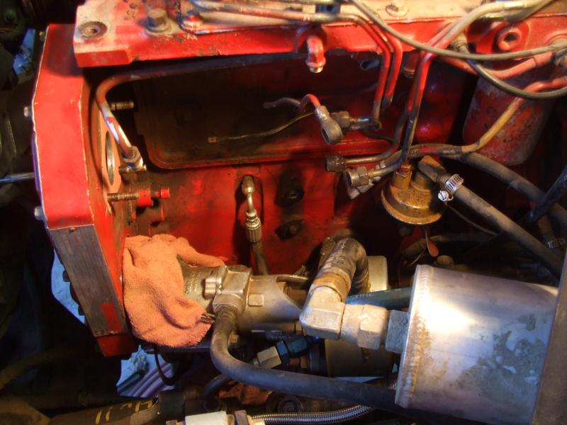

Eeeks, that first pump doesn't look too good. Was that the pump that was on your 4bt when you got it?
I think running the pump w/o the KSB is the way to go. The KSB will eat up the pump if it stays on according to one of the pump builders I talked to.
Thanks for posting this information. I know that rebuilding a pump and injectors can cost 800 to 1k for the pump and around $100 each for the injectors and doing it myself is not something I feel is prudent.. The 4bt's typically aren't discarded until they need work. It is important to budget this into a build as a possibility. The carrot of good fuel economy is nibbled away by the cost of repairs, adapters gears and time when considering the good and bad aspects of a diesel swap.
The original pump was suppose to have been rebuild when it was installed on the Cummins Re-Man engine. I'm guessing it was not.
The other pump had the single line KSB removed and it was completely rebuilt by rebuilder in Peoria. He got the 4BT pumps he rebuilt mixed up sent me back the wrong pump.
Fully loaded, I was getting around 17mpg with the rig with the old pump on it. I'm wondering what I will get now. It is running much better than it ever has.
What were the symptoms you were experiencing Dan? You were brave, making the trek when not feeling the rig was one hundred percent.
Glad to hear it feels better than ever, and hope your pump vender has made things right with the mix up and all.

Literally at camp in Tok the night before we left the rig started leaking fuel from the pump. I called around and found a Bosch "O" ring rebuild kit in Anchorage. One of the other trekers picked it up for me and brought it all the way to Tok. John B and I rebuild as much of the pump as we could without removing the pump. It leaked a very little bit during the trek.
When I got home the rig was on the back burner. I had been neglecting some chores while thashing to get the rig ready for the trek. I caught up on everything and then used the rig for towing the local ranchers out of thier mountain ranches for the entire winter season. Next spring it was when I pulled the pump.
As far as how it ran versus how it runs now, the best way to describe it is when you buy a used car better than your old one. The new-to-you car runs great adn when you replace the plugged Cat Converters it runs a whole lot better.
My symptoms were hard to start after it sits over night. It may require 2 attempts to get it started using 5 second cranking. In the world of diesels, that is hard starting.
