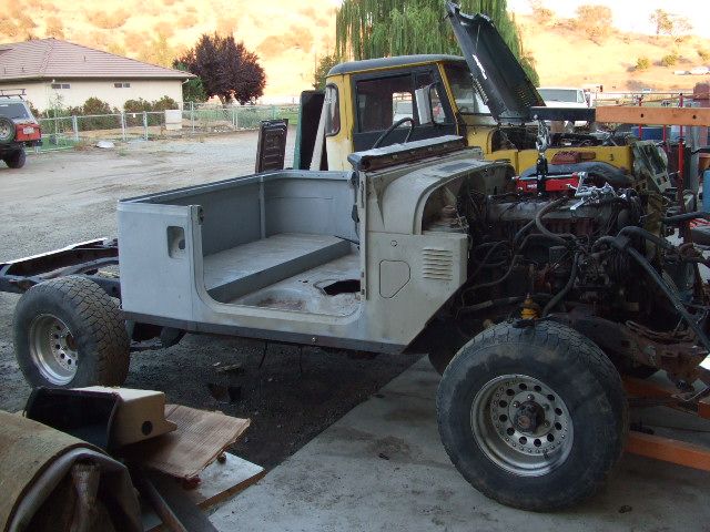

Had a really busy weekend.
I stripped and pulled the body off my 84 donor rig.

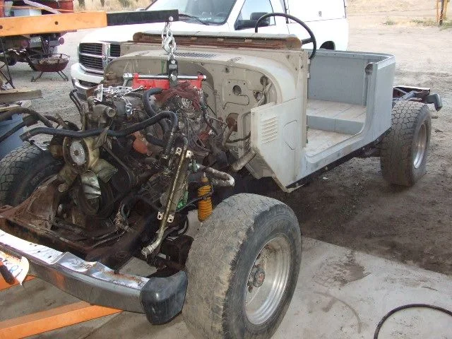

I steam cleaned the frame and power train. I cut off the body mounts that were not going to be used. I installed the H42 transmission and drive shafts, etc. The engine is about 80% installed. The tub is sitting within an inch of it's permanent location.
I also worked off quite a few things on my "Honey Do" list.
One last one.

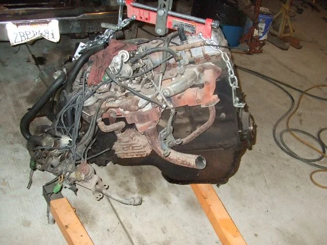

It was dark out last night and I could not get the engine to set in place properly.
Instead of muscling it I decided to quit on it. I'm glad I did. The input shaft for the tranny is cocked up and holding the bell housing.
There is no clutch assembly since this still in the mock up stage.

Since things were not lining up for the mock up, I pulled the engine tonight and installed a new LUX clutch and pressure plate.
My wife helped me reinstall the engine correctly.
Damn she is a sweetheart.
I kept laughing at her launguage.
"The shaft thingy is not in the middle if the hole with the finger thingies around it."
And
"The fork looking thingy is loose and poking out the side where I put my my feet, how do I tighten it up?"
For those of you that have ever installed a new clutch assy, you know exactly what I'm talking about.
