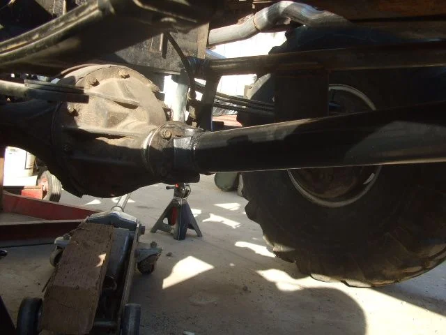

Here is his handy work.
I already had the perches cut off.
He removed the driveshaft, installed the new perches, added 2 Warn 8274's, one Bellview and one Warn/Bellview winch to achive the loaded weight. I think he even threw on the Warn 9000xi for good measure. Yes, they were just laying around my shop. :D
He dialed in the pinion angle with the simulated loaded weight and then welded the perches on. He then cut the driveshaft to the correct length on the lathe at his shop and rewelded it during his lunch.
After lunch he started on the traction/lader bar. He used my extra cross member and bolted it up. The big Hemi joint is up in there. I would have shackled it, but I'm not complaining.
interesting you didn't use a shakle at the top of your tracktion bar ... ( frame side )

Doesn't the front of the trac bar need to be able to move forward with a shackle? Or does the heim allow for enough movement?
Dan, go flex that out oand see what it does to your springs.
A hard mounted bar like that is going to bind up something fierce..
It is an easy enough fix. Should it be a long shackle or short shackle?
mostly what fits currently..
Ramp the truck as it stands, look at the springs
Then disconnect the rear bar and ramp the truck again.
get a good idea of how much movement the bar will see dring articualtion.
That will help ya get a good feel for how long the shackle needs to be.
