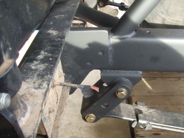

Here is the list I gave to FC Fabrication a few weeks before I dropped it off. In a time frame, this was jsut before I broke down in evenston, Wyoming and during the same time Woody and the gange were out wheeling all over the west coast. About a month ago.
Front Tube Fenders
Remove top of metal fender apron
Reinforce the Bib so it stays in place
Incorporate fiberglass hood into Tube fenders. Hold downs?
Mount “Pins” onto radiator. Maybe onto the bolt on cross over piece going over engine from shock mount/tube fender to shock mount/tube fender?
Front shocks
Mount how you see fit
Mount shocks
Front Springs
Install correct bushings and bolts in the rear area of the front springs. The ones in it are the ones Ruff Stuff/Georg sent me.
Front Bumper
Reinforce as you see fit.
Rear shocks
Install rear cross member for shocks
Install shocks
Install Bump Stops
Traction Bar
Reinforce on the Axle Tube
Install shackle in front of traction bar
Reinforce Traction Bar as you see fit.
Fuel Tank
Modify Booty-Fabbed front fuel tank mount as needed.
Flat Bed
Make and attach brackets similar to the ones used on the rear area of the cab.
If front brackets are incorporated into the front fuel tank hold down, I’m fine with that.
Here is what he did.
This is after he quit laughing and then spent two hours with a plasma cutter removing my "Mock Up" stuff.
Boxed the rear frame.
