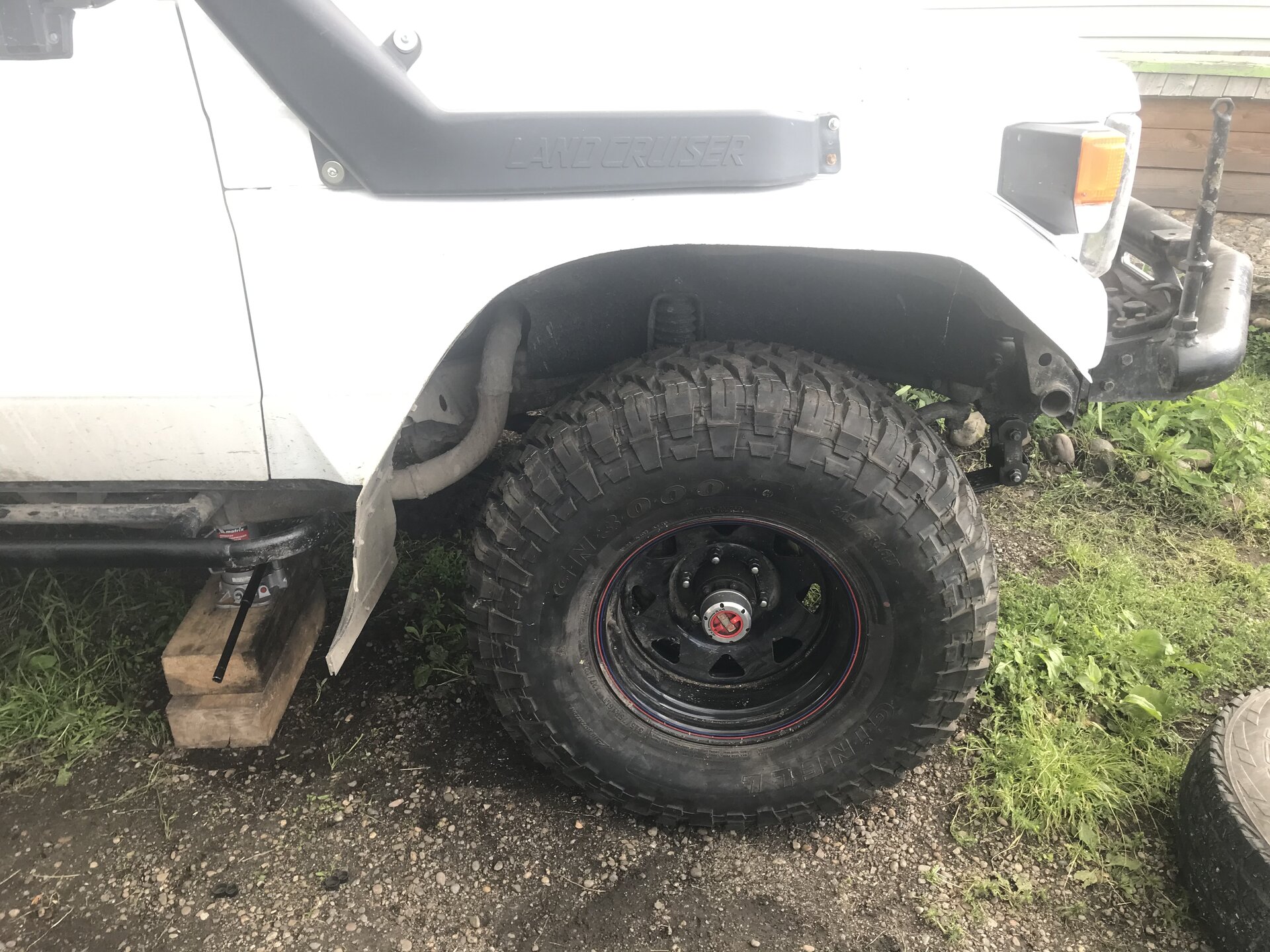

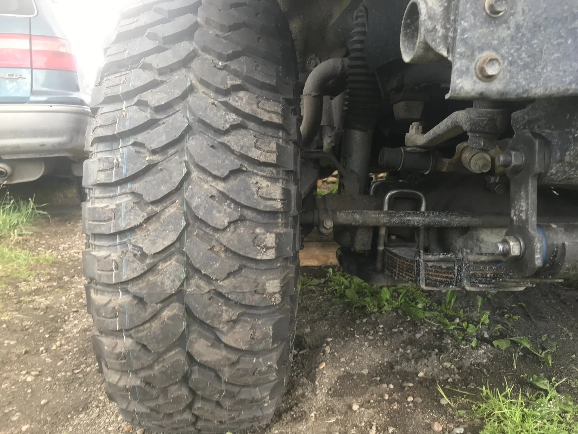

Want to share my setup for 35s BJ74
Fenders were trimmed quite a bit to accommodate 40s + front shackle reversal.
Later I decided to make car long distance friendly, put shackles in original position and put 35s.
35x12.5 wide, some Chinese brand
That’s how they look, Toyos 315 75 16 Open country mt
Worth to note that after I put shackles in original position, I’ve replaced 13BT, yep it might sound strange, but I wanted to experiment and went with naturally aspirated 15B.
Gears are stock 4.11, H55F.
Power wise engines are almost identical, 13BT being more punchy while 15B more linear.
If I put 4.56 gears, I think 15B will outperform 13BT, but that’s not the goal.
Hope this info helps who hesitate to cut fenders or move axle forward - you can do it all together, if you want.

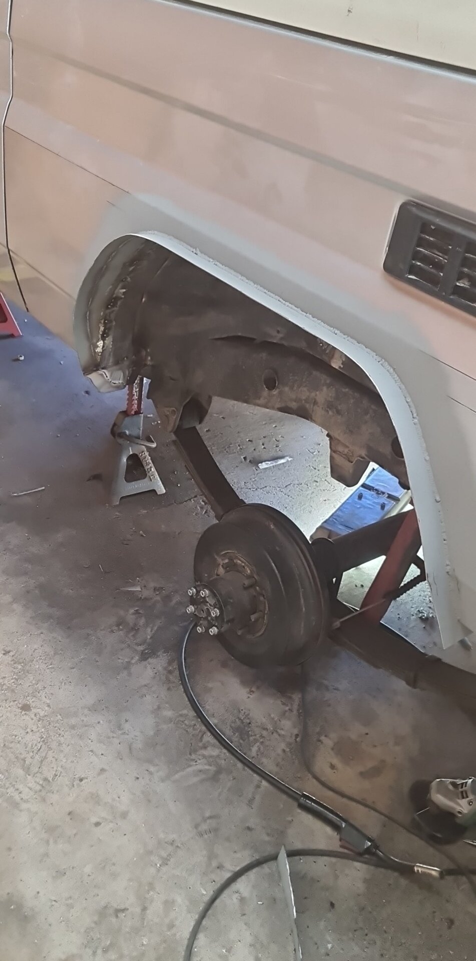

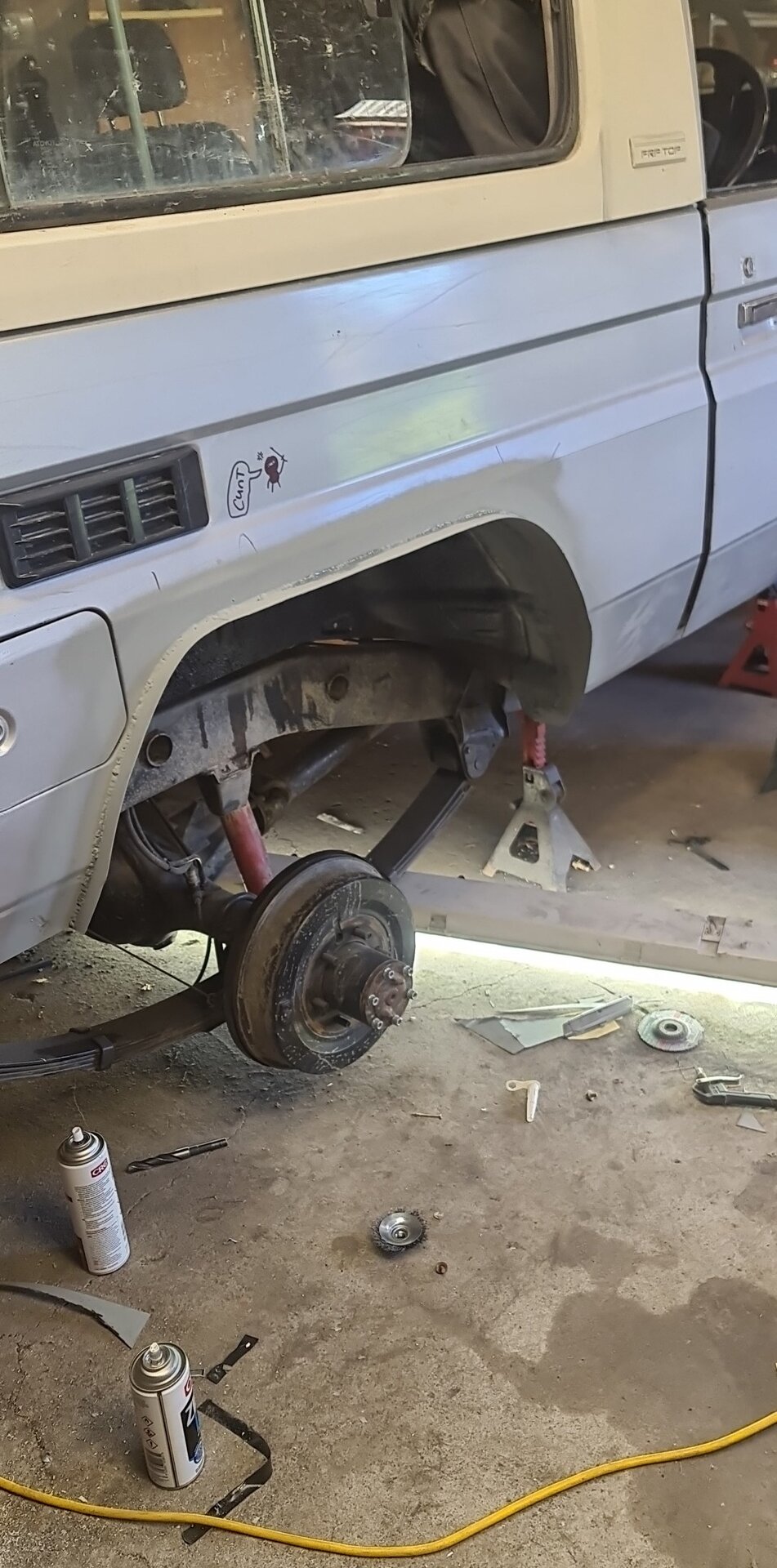

Has anyone trimmed the rear wheel well? Currently runnning 33s but plans for 35s or 37s, (probably +37s in the end as, why not)
I am fixing the rust and have to redo the rear wheel well and am considering trimming them now so i dont need to undo my work later.
Does anyone have a picture of their rear wheel wells trimmed or is it totally unnecessary.
Also, if moving the rear axle back an 1 inch, will it interfere with the gas tank?
i moved the rear axle back.... no issues on a bj70
and am on 35's and flares and no need to trim (maybe if you want to get rid of rust)
I chopped my rear guards out all the way flush with the inside tub and welded panel steel back in with a lip to mount rubber flares, clears 36x12.5 with no body lift 😁
