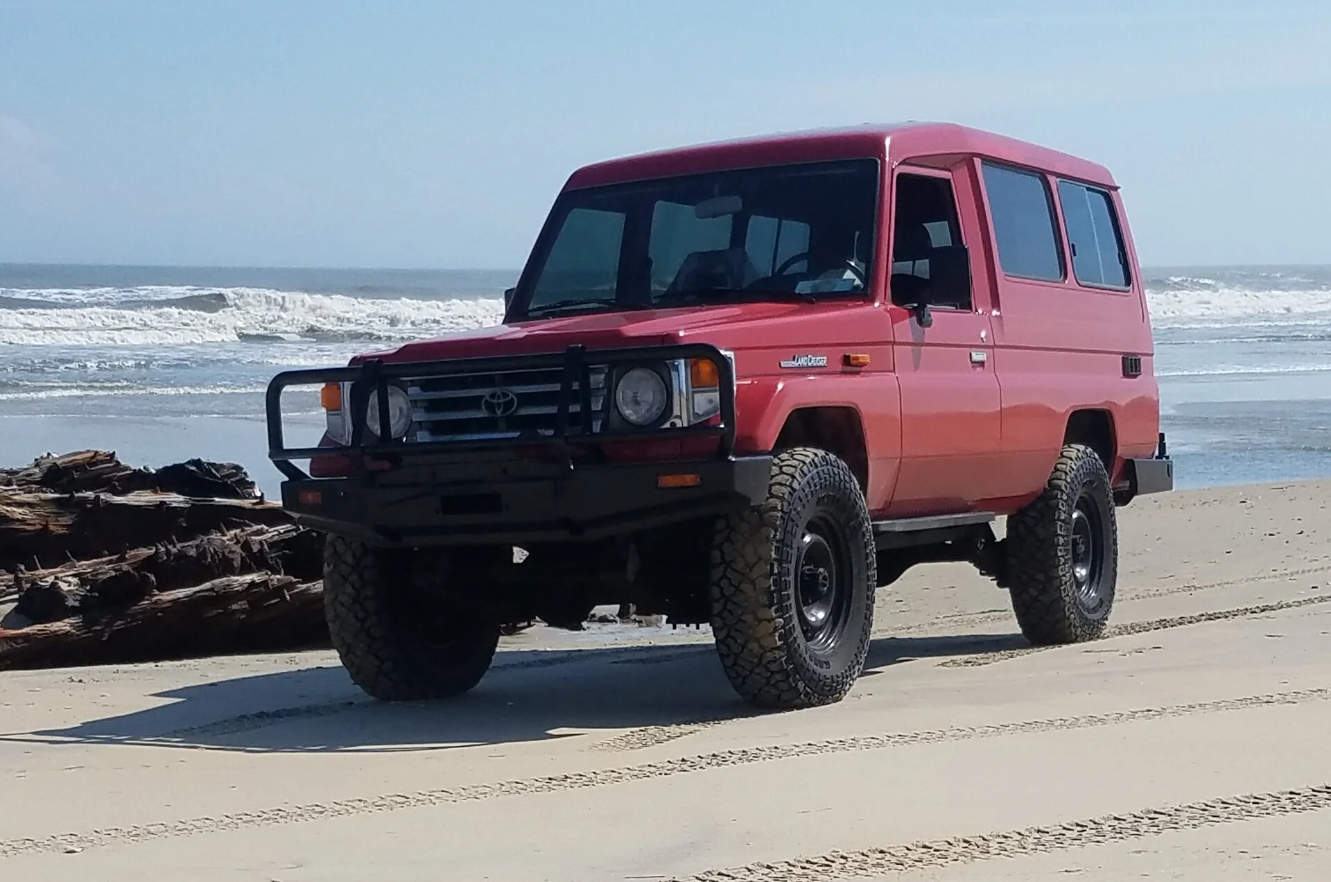

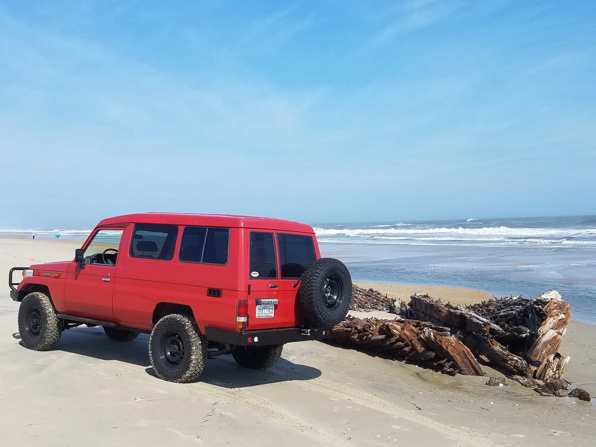

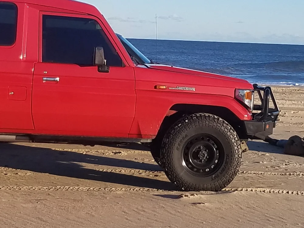

@likethewheel I have 17x7 steel rims (either 4Runner or FJ, but I can't remember, one is 7" the other is 7.5" wide) that have a back space of about 4.25", and 35x10.5 tires. I'm using 1" spacers but wish I had 1.25" ones. Also have OME greasable shackles and about a 2" lift. I've had to adjust the wheel stops out a bit to keep the tires from rubbing on the frame slightly at full lock. At some point I'm planning on getting 1.25 (or maybe even 1.5) spacers but it doesn't seem that important at this time. With 11.5" tires you might what to consider 1.5" spacers. Some photos of my current set up.

Thanks for the info and pics. Your truck looks great! That's the exact stance I'm looking for. How do you like those Kendas? Those weren't available when I bought the Nitto 35x11.5 tires I have otherwise I might've gone with those.
Thank you, it's definitely a work in progress. I like the Kenda's, they are quiet on the road and not so aggressive that they are a problem in soft sand. I was lucky and got them not long after they first came out; they were very affordable- about half the cost they are now. I have 4:1 tcase gears so need the 35s to help keep RPMs down at Hwy speeds. With the 35s, 10% underdrive from the tcase gears, and 4.11 diffs the 1hz turns about 2600 rpms at 70 mph.
