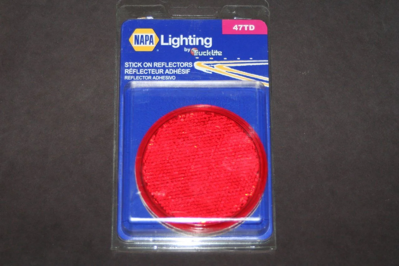

On the rear reflector, Pablo found a Napa reflector that fits perfect. The problem I have on those is the metal ring around it, rusts out and no replacement.

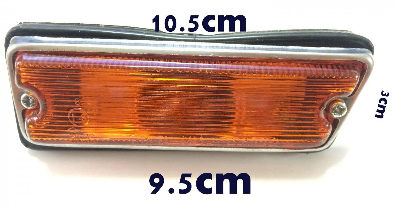

Has anyone tried to fit the corolla ke20 indicators as a replacement to the grille lights? They are about 1cm smaller than the FJ55. They are reasonably priced on evilbay
That looks to be a good alternative. The chrome band does match all the side marker lights as well.
Looks like they might be worth trying! Can you get your hands on a set?

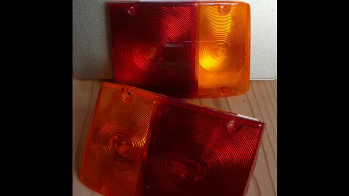

I've just ordered a set to trial out. However they are amber and the FJ55 in Australia had clear lens. The rear amber/red combination lens is that how they came out in the states?
I was wondering which online store I can purchase a pair of napa reflectors who will post to Australia?
Thanks PabloCruise. I flicked an email to Napa waiting to hear back. If I luck out I will let you know. I heard back from local lens reproduction company. I will be sending the rear clear rectangular back up light lens, below grille lights and my rare 1967 side markers to make reproductions. Prices seem reasonable If anyone is interested PM me.
