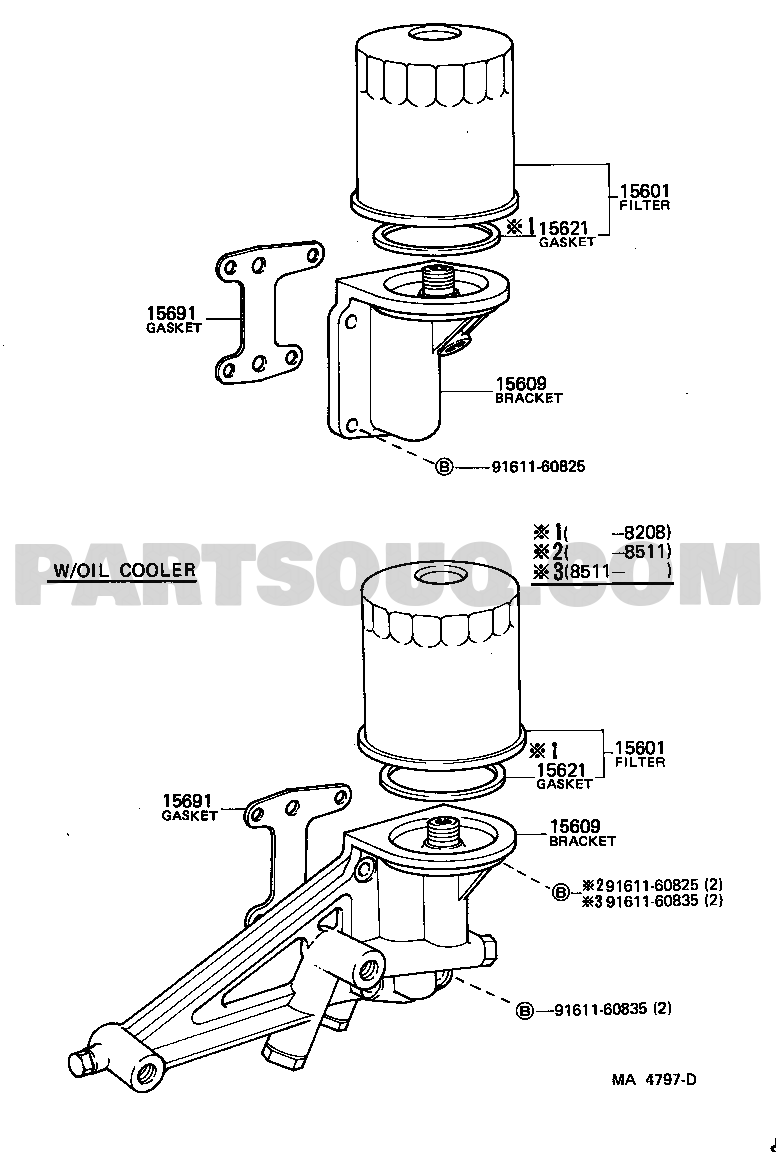

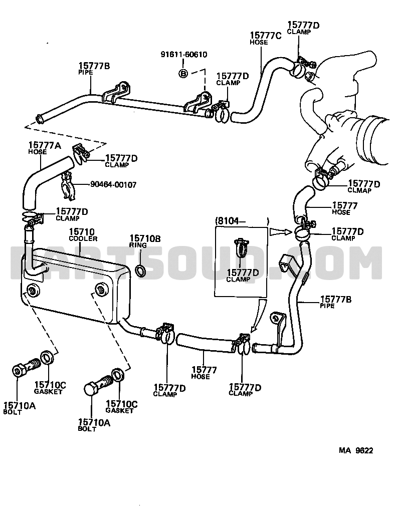

Your oil filter mount is going to be part of the oil cooler mount like the lower image above. Plan to replace the oil cooler bolt rings and gaskets at the same time you replace the oil mount gasket. Rings and gaskets are still available from Toyota. You'll need a LARGE socket for the bolts. I think they are 32 mm but double check this. Also, clean up the oil cooler when you have it off. I'd use a can or 2 of parts cleaner ie brake cleaner, consider repainting. Replace any old-rock hard heater hoses with new 5/8th inch heater hose. I wouldn't bother with Toyota hoses....they are way pricey and these don't have really hard bends so generic heater hose is fine.

Thanks for the pics! Have you checked if the side cover is leaking just above the oil filter housing? part 15621 is attached to the oil filter, so there is just one gasket there. what about the oil pressure sender where is screws into housing? Its probably something simple as leaks have a way of doing that. Man that stinks.....
