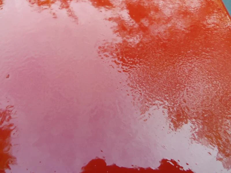

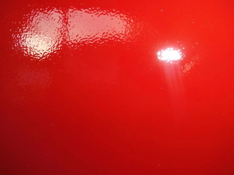

This is my first attempt at painting a vehicle and my question is when i make the first pass spraying the paint looks good and smooth no orange peel but when i make my 2nd pass about 15 min later i get lots of orange peel. What am i doing wrong? Am i too thick the first time or should i not make a second coat if the first looks good. Should my 2nd pass be right after the first and not 15 min later?

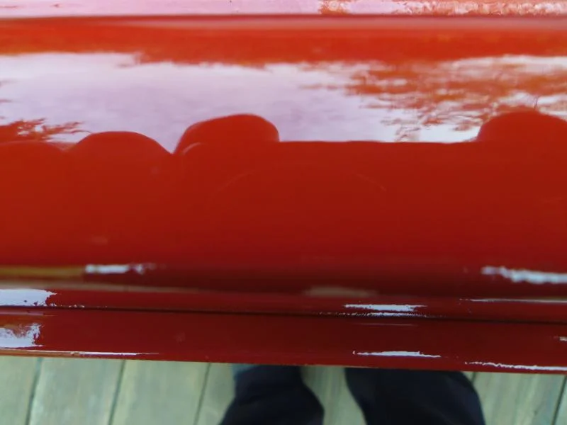

I am using a cheap hvlp gun with a 1.4 nozzle, painting is done outside flat then moved to the garage and hung vertical with heater on to dry. The instructions say 2-3 coats to hide,10-20 min to flash to recoat. 2 pics show some orange peel 3rd pic show how some areas are for me perfect .

Ok. I thought you were using a two stage system. I'm gonna take a guess and say either you are laying your second coat on too heavy, and the dryer might also be causing it to set up faster than just letting it air dry. The first coat went on good probably because it was a light coat which it should have been.
The pickle you are in is that wet sanding one stage paints can be a chore. How many coats did you put down? I'd be nervous to wet sand a single stage paint job with any less than four wet coats. I'm no expert with single stage paint, but I've done alot of urethane BC/CC paint jobs. A little extra material to cut can go a long way.

I did some more painting yesterday and twisted one of those little knobs to allow more paint and it made a big difference. Some of it looks so good i wonder if i should even touch it with the wet sandpaper allthough when i run my hand over it i can feel some rough spots that are probably dust or something.
