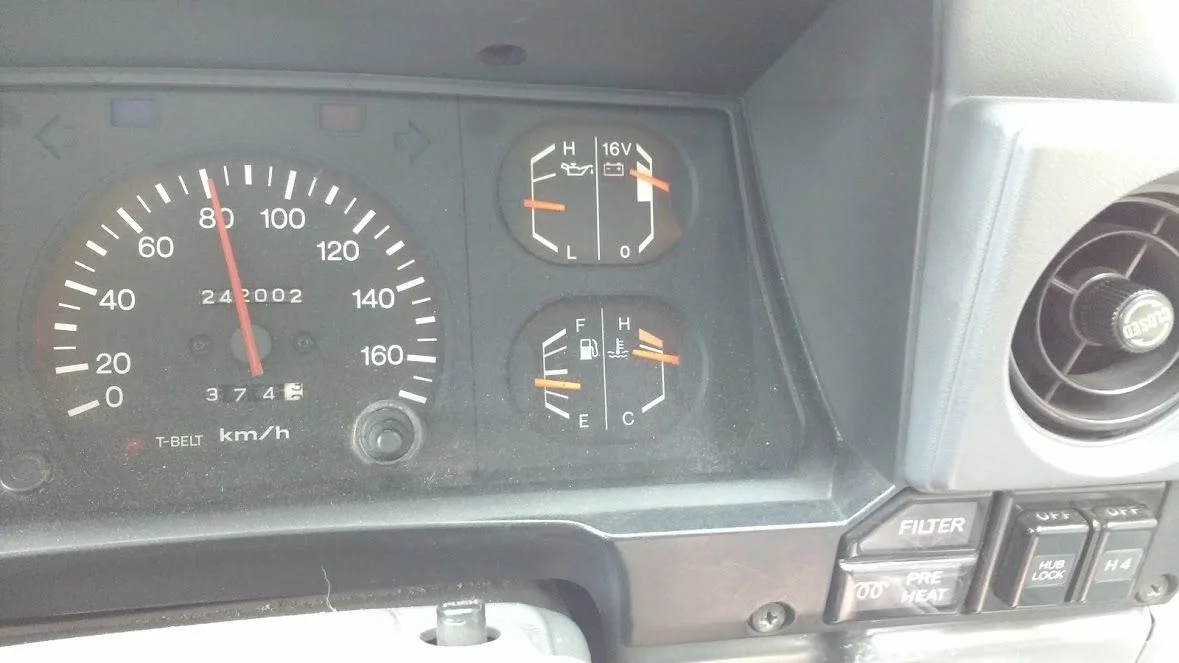

Looks like a clean LJ70 and the mileage could be correct looking at the seats and shifter knob , door panels have been replaced with later model ones.

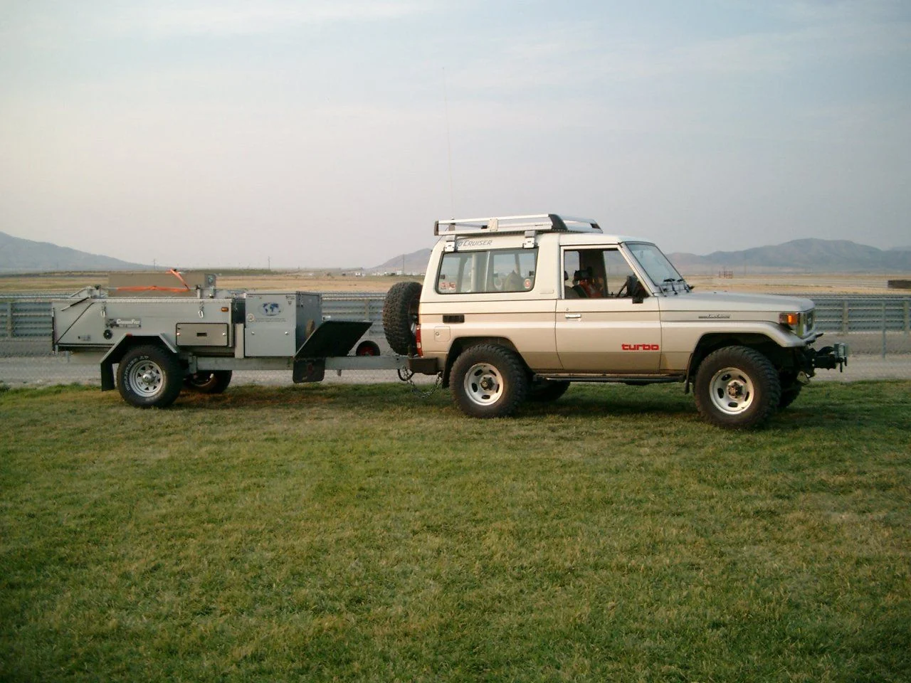

Found a couple of my old pictures towing with my LJ:
Typical speed up on highway high boost and egt (max load):
Cresting a long 8% grade. This is a typical temp at the top of that hill when towing. Engine has seen this about 12 times a year for the past 8 years. Amazingly I've had no cylinder head issues! I chalk it up to the Evans Coolant and intercooler/tuning.

Yes, it is a bit pricey. Especially without AC. Missing factory AC is a deal breaker for me, but that is a personal preference.
All five wheels are factory, upholstery looks in decent shape. Together with the steering wheel and shifting lever, it suggests mileage may be genuine.
Door cards are from a later model, standard grade truck.

Towing is as much about the driver as engine power. It would not be my choice of tow vehicle because of the short wheel base. I think this has been resprayed. The inner fenders are normally black and these are all white. Proceed carefully. Its not hard to replace the odometer with a low mileage part from a wreck.
