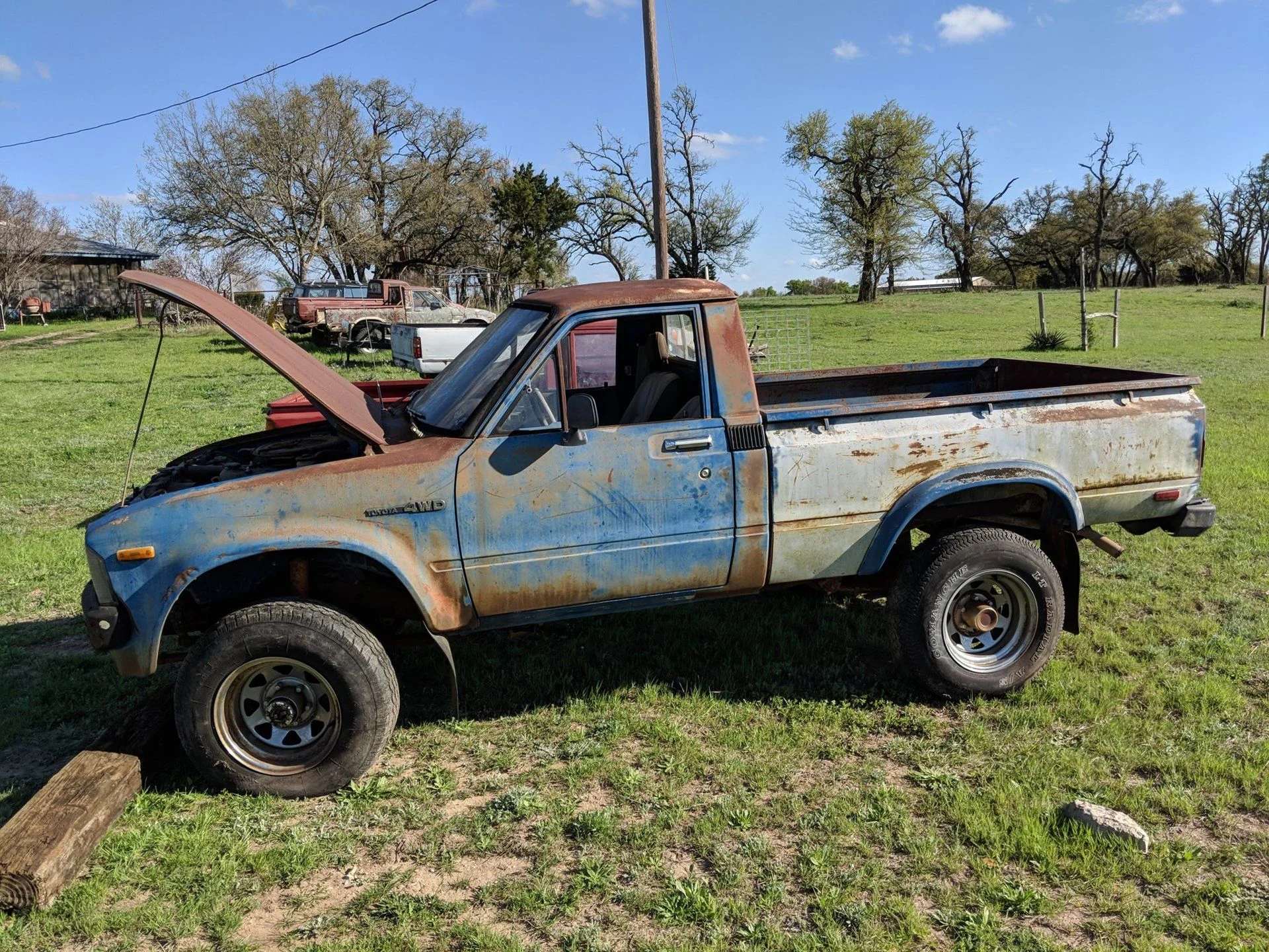

Pics?
This is what it looked like when i started it,
since then i've rustrefomerd it, primed it white and painted the bed and back Flourescent Green (at an exceptionally crappy level of skill).
I"m in the process of swapping the l43 for a w52 i had laying around, just about fabbed the xmember(4 1 cm holes left before i fit it.), got 2 bolts that were thewrong length, i need to swap and finish the driveshafts (drilled out at diff to fit new driveshafts)
At that point i can try starting it by pouring gas down the carb.. (the l43 was so badly
blown up, the starter didn't hit the flywheel to turn it over)
