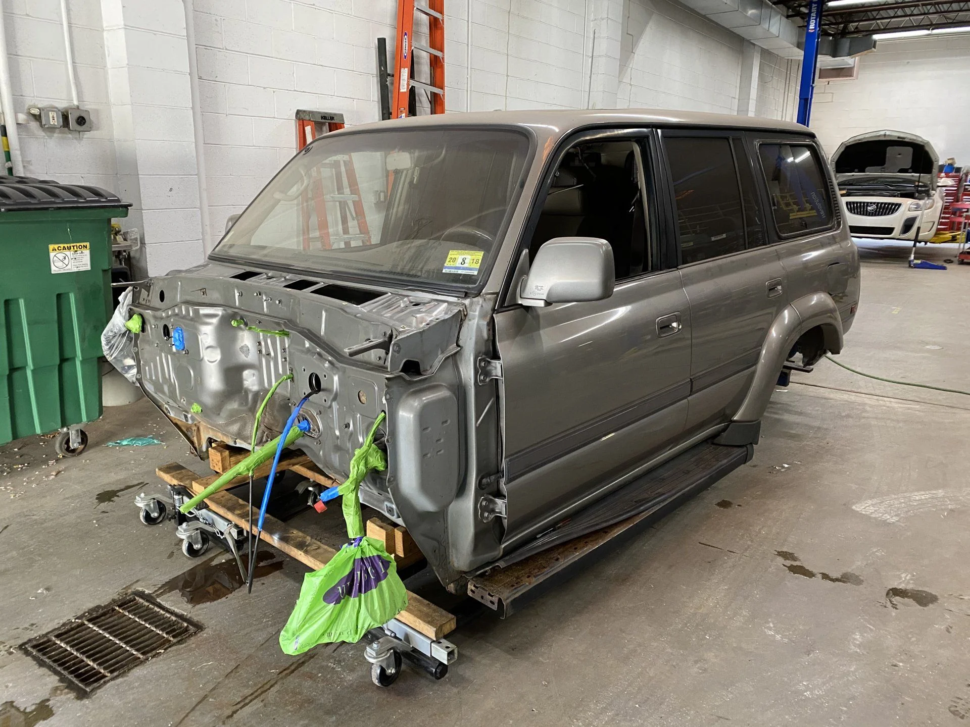

We have a fair amount of "frame off" experience with LLV's.
We've also done a few pickups outside of the LLV's.
Couple that with the slow time in general and we are trying to keep it all moving while we have the time and idle hands available.

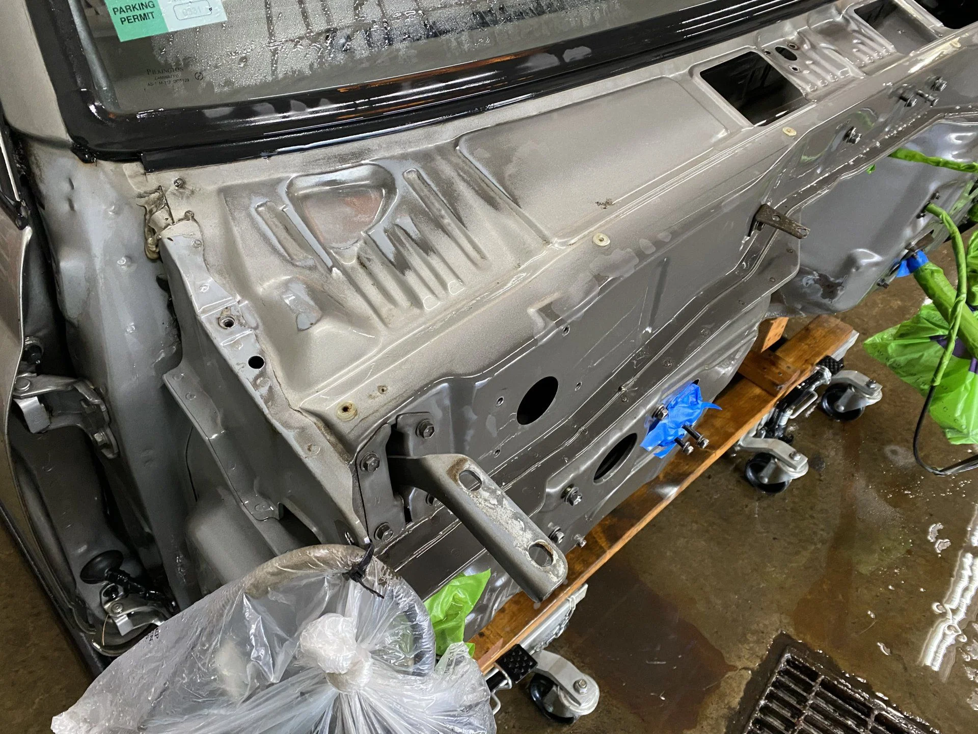

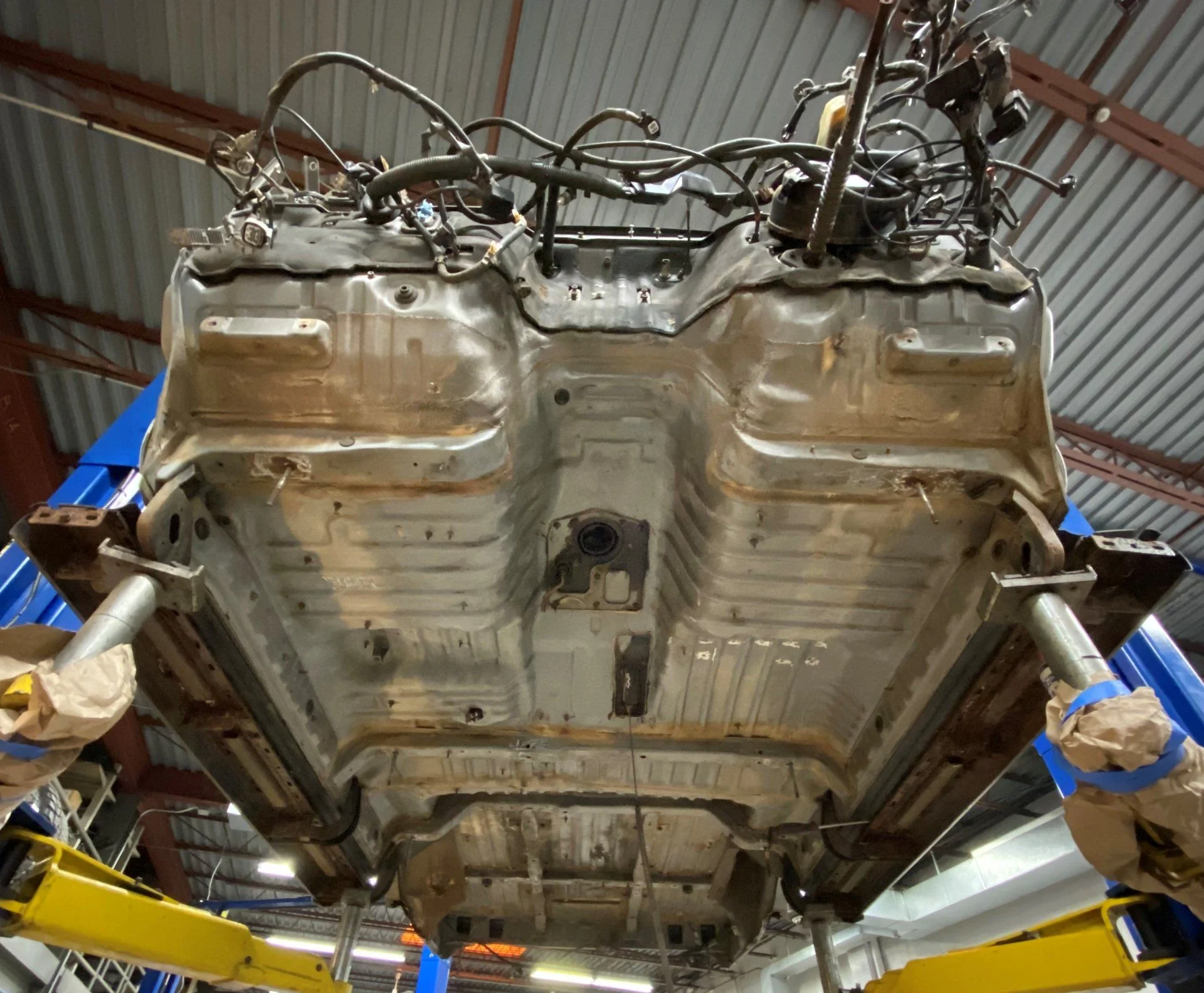

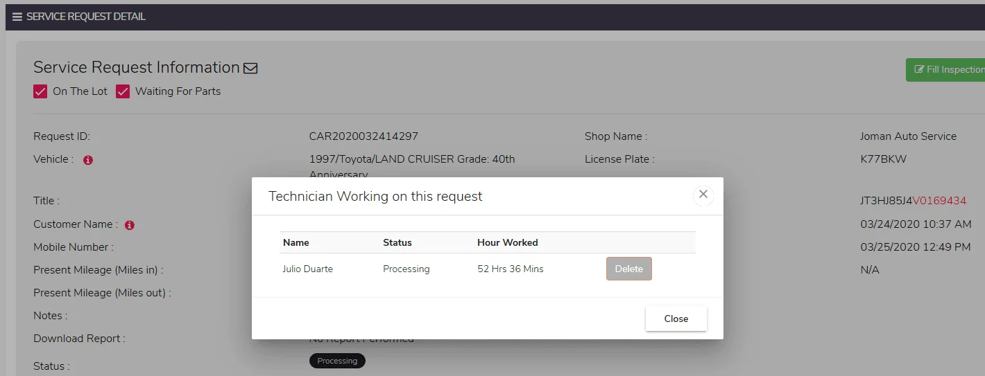

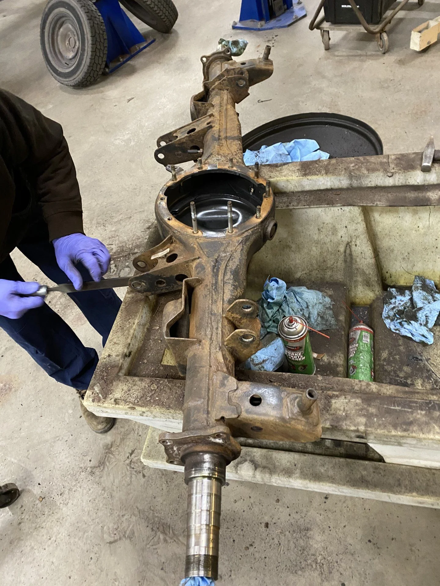

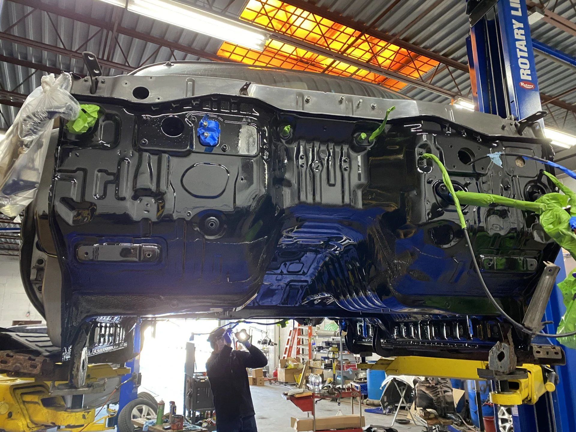

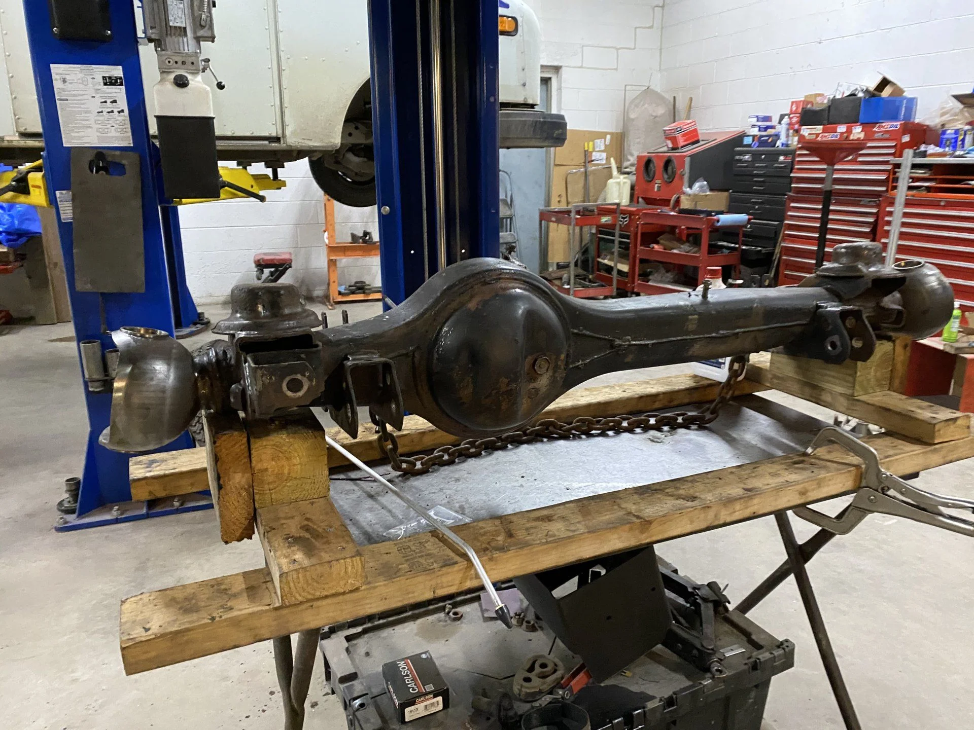

Speaking of... time check: 52 hours in.
OEM bushings, bolts and body mounts are all coming in this week.

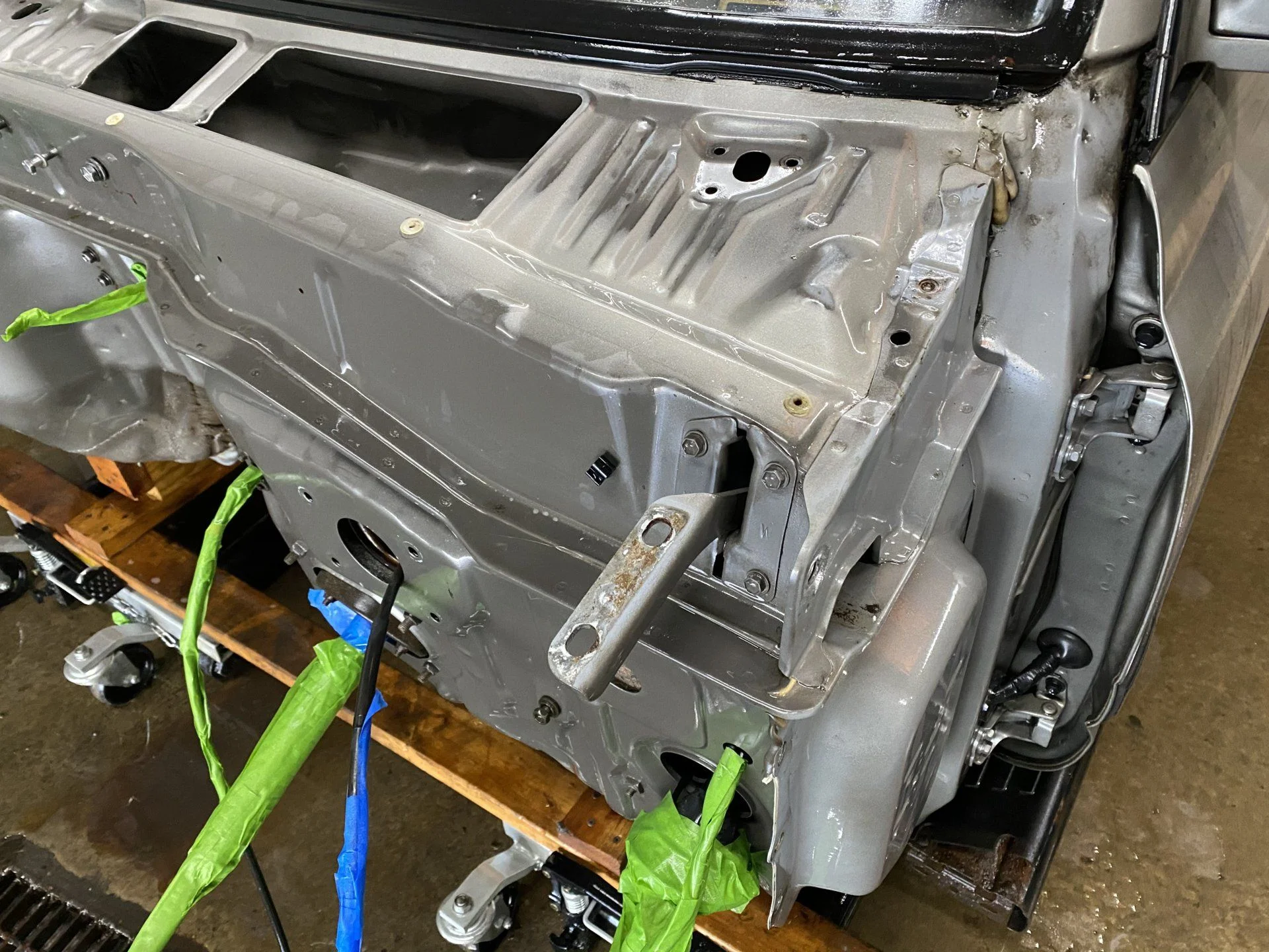

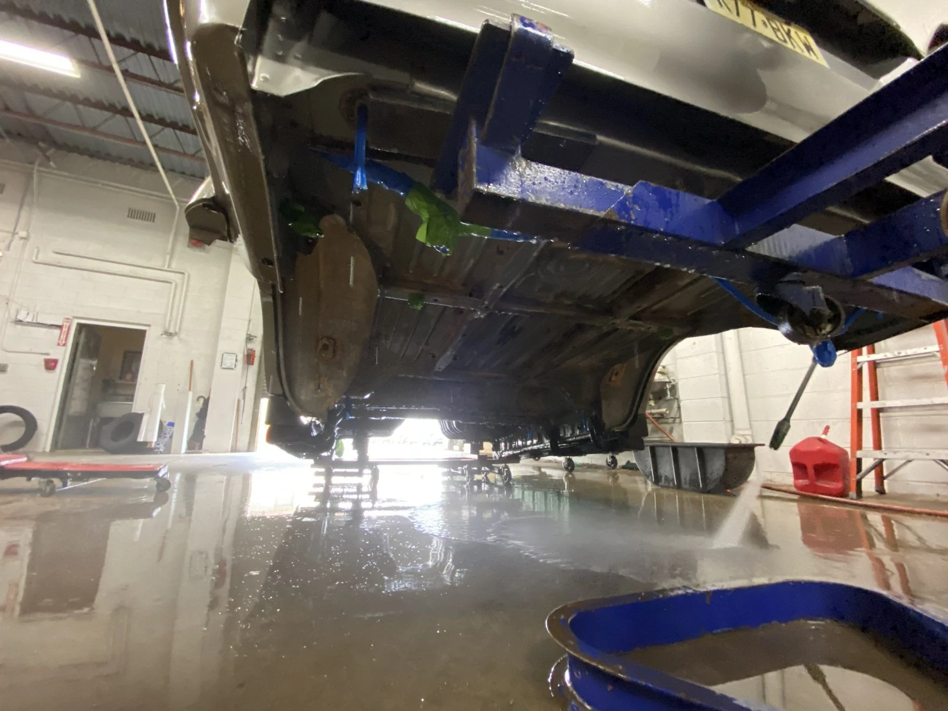

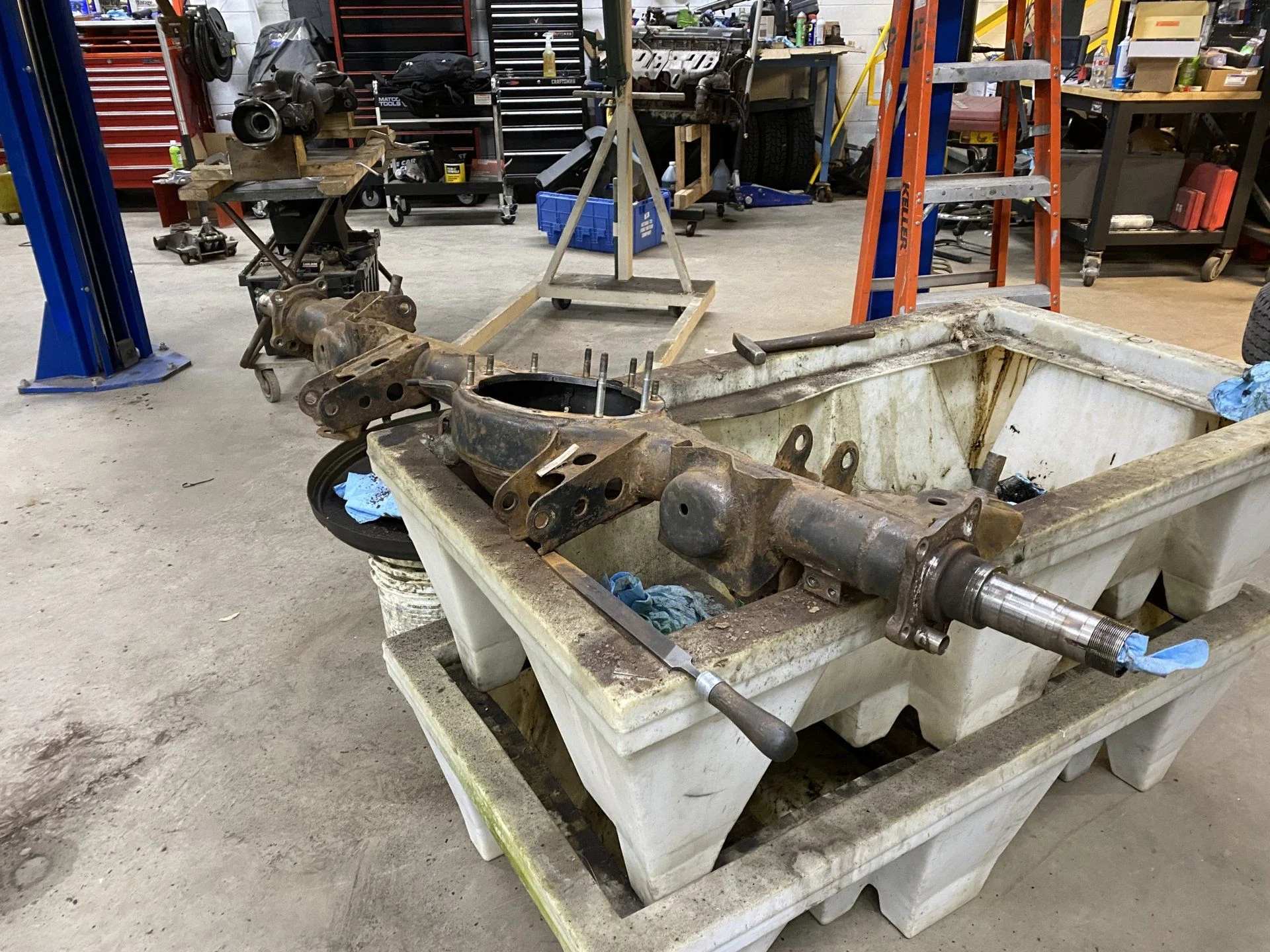

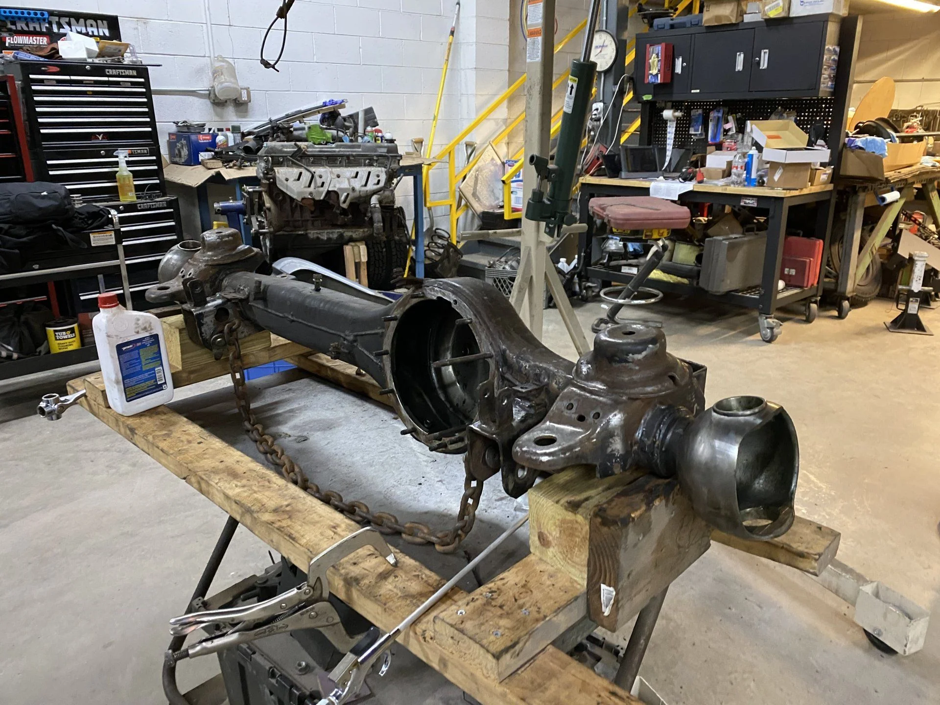

Preparing the differentials for protective coating and hopefully next week we will get working on the undercarriage of the truck.

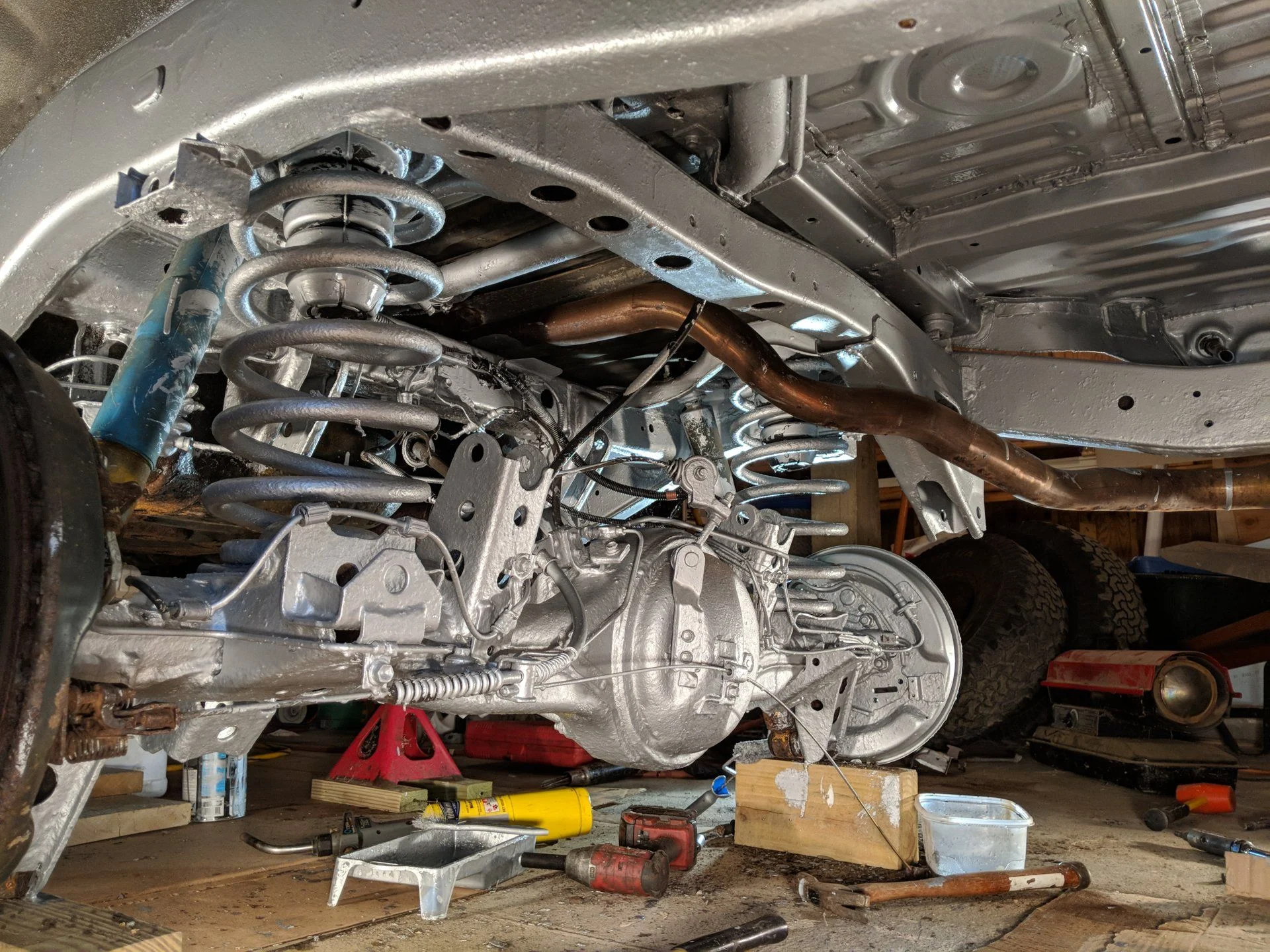

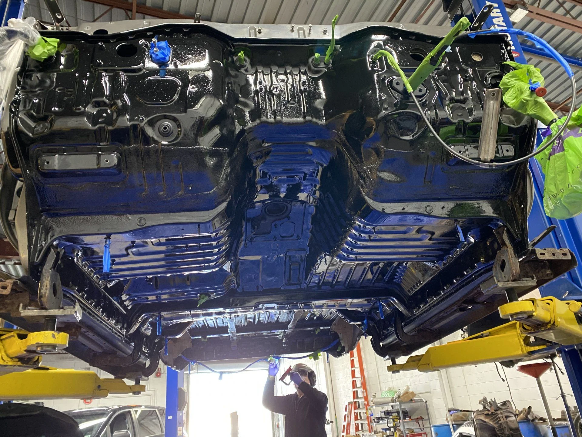

Looking good! I would hose down the inside of the rails and everything you can reach with some fluid film or wool was too.

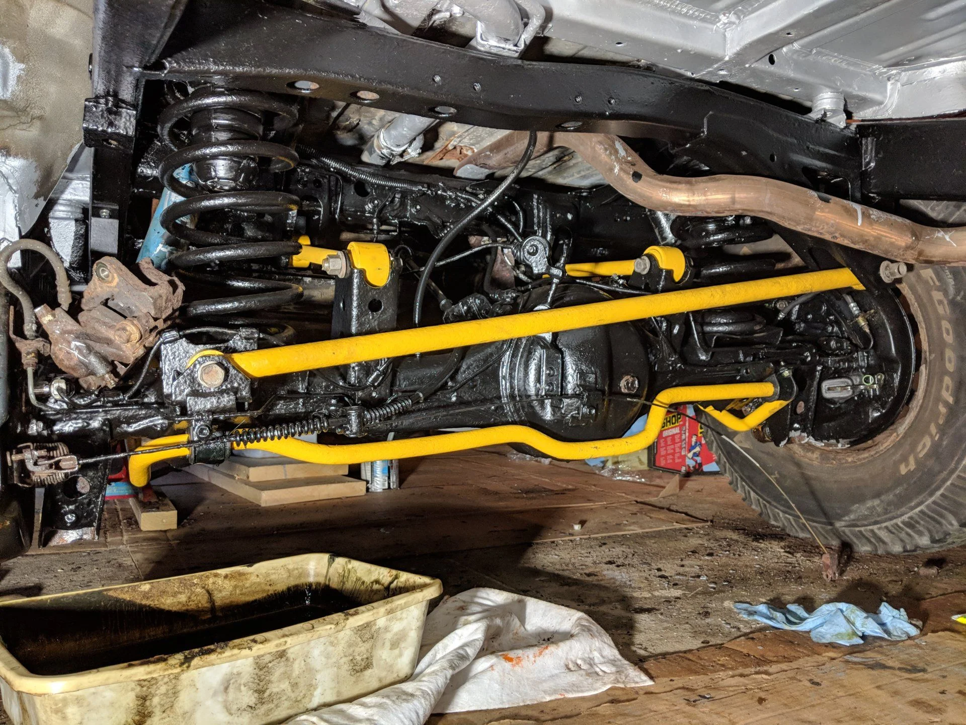

My 40th was worse on the frame and I really really wanted to take the body off but it was going to be too difficult in my crappy home garage so I am very jealous of your work. I went with POR silver for the base coat (it has the most fillers for rough surfaces) then black I wish I had gone with gloss not flat as I now believe it sheds mud, dirt etc better, I really struggled with the interior of the frame and very interested with what you did?
I ended up just fluid filming it but I wanted better, I liked Eastwood's Internal Frame Coating but thought it would take so many cans it would not be cost prohibitive.
anyway this is a great read and I appreciate the time you are taking to show us your project
I wish there was 30 more pages of this so I could binge read the entire build today!!
That’s still a really clean job considering you did it in that manner. Great work and love the way the color stands out.
I also debated the gloss vs chassis black. Weird part is that one section looks completely gloss near one of the shock towers. But I’m happy overall just getting it cleaned and protected.
I’ve ordered Fluid Film and Woolwax for anything that can’t be accessed. Going to do that as we start to put it together.
