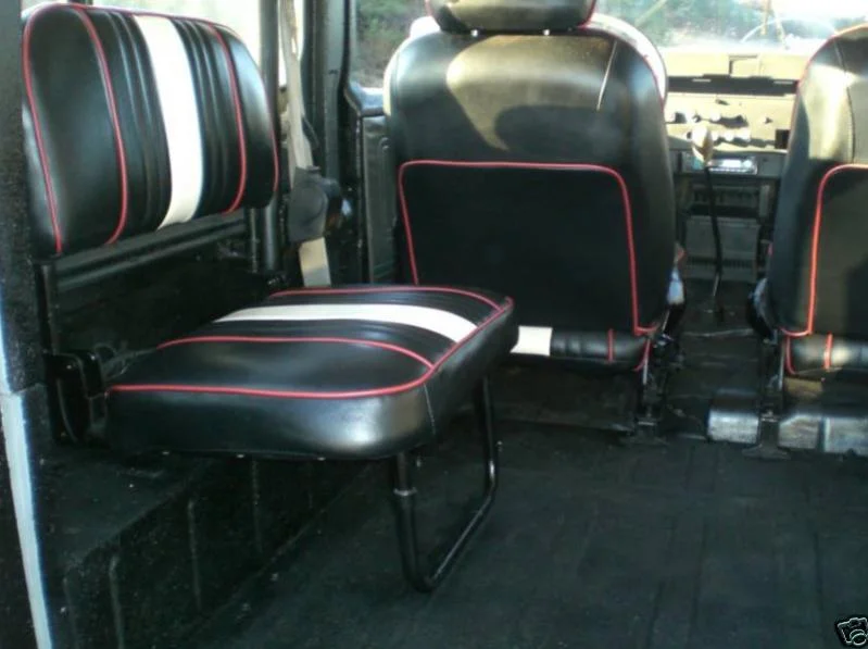

love the pink piping on the seats :flamingo:

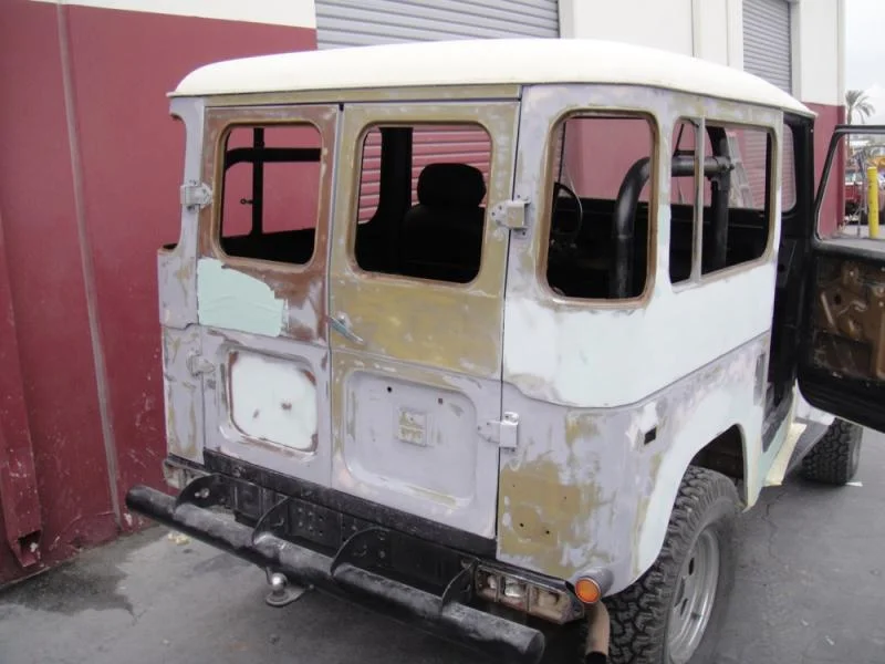

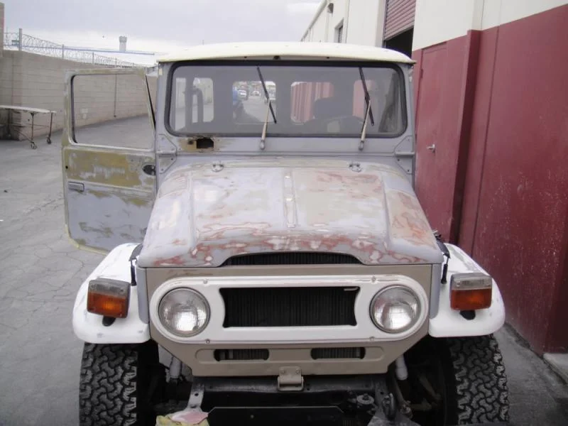

back after my holiday time back east. the body shop was able to get some some work done...

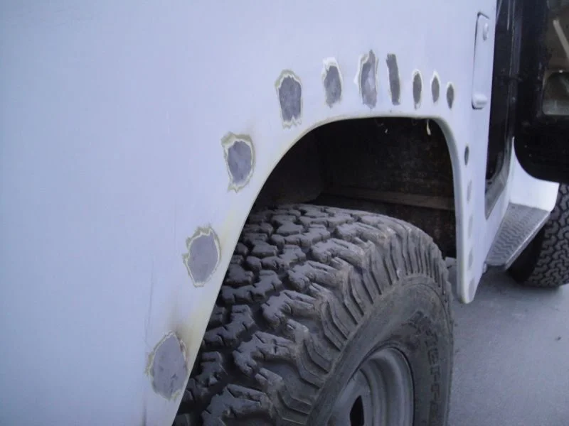

welded holes from fenders and extra holes in doors...
need to have some random holes welded up on the dash and then the awful homemade rhino lining can start to come off.

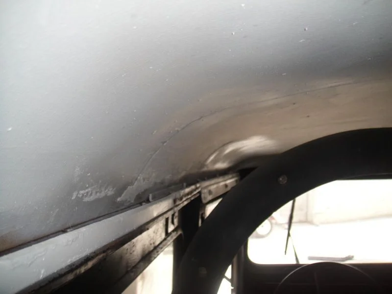

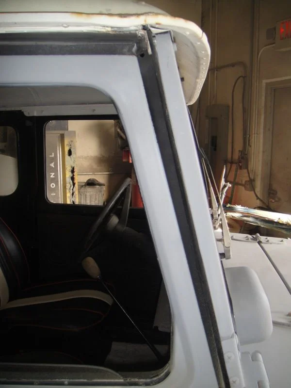

you might want to consider replacing the rain gutter rather than trying to patch it up
just do a frame off - its excellent therapy
i think ill take your advice tlc_4play...
after staring at it for a few hours, that is opening a giant can o'worms...

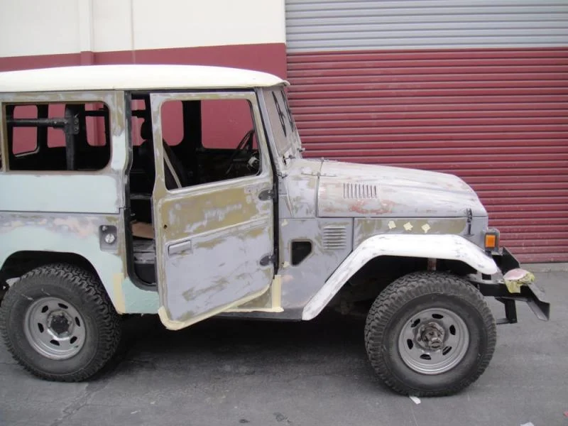

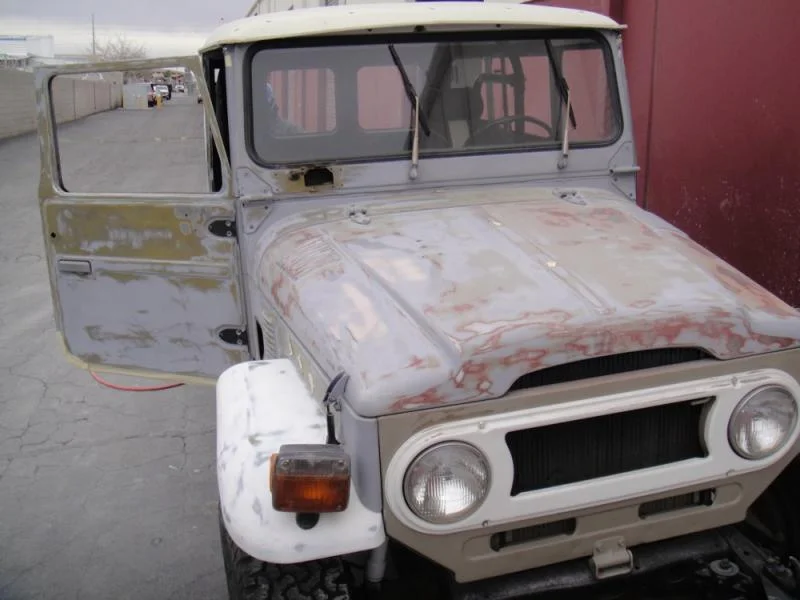

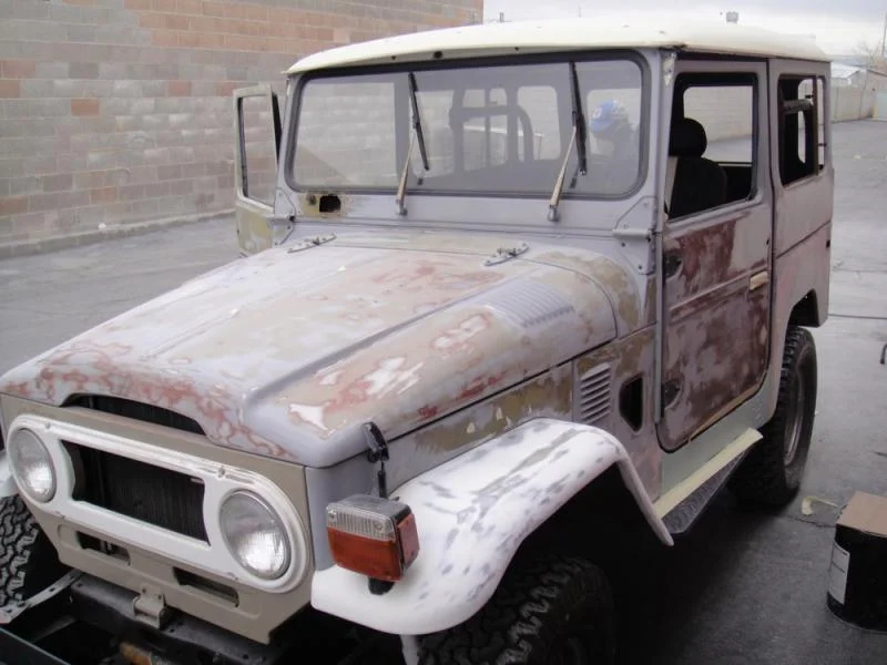

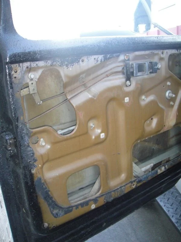

so after taking out much or the interior and a few more weeks the body shop has dug in. the initial job of welding up weird holes has mostly been done. sanding off primer to see what the metal looks like and... it looks great :)
a few pin holes in door frame. the PO installed some earlier model apron emblems that left some holes that will be filled. you can still see the original bolts that were broken off for the correct emblems. also covering up the factory installed radio antennae, i will be going with an XM setup.
also appears that a couple of doors came off a donor car, driver door, rear ambulance door. the hood is a question... it has the holes drilled in it for the hood ornament that i will also have filled.
next will be first primer, then disassemble for final sanding and primer. the interior will also be sanded down to bare metal.
