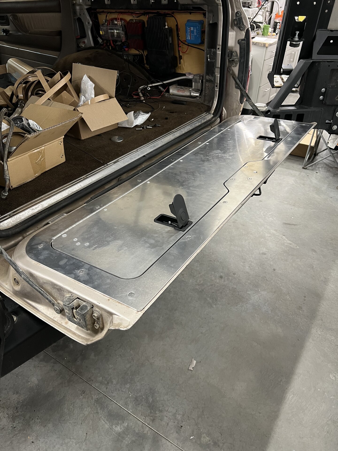

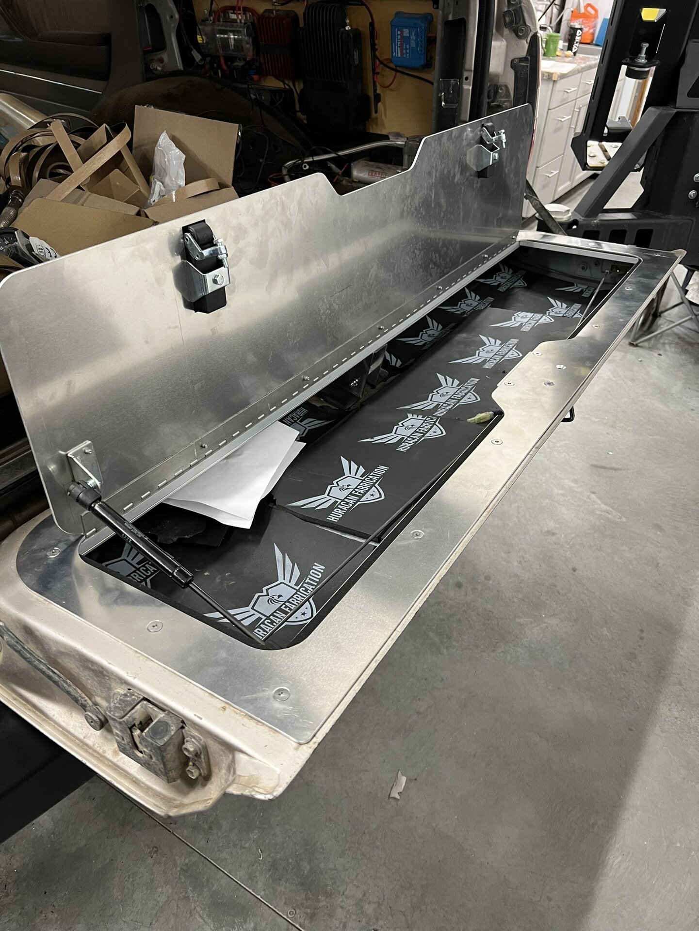

Finally got this sorted out and fully prototyped. Ordering up material for the first batch on Monday.
Added a brace hinge side in the middle that makes it rock solid/zero flex, along with a few other small changes for ease of manufacturing.
Will be sold in bare aluminum, with a carpet kit option and an interior padding option, or links to buy that stuff elsewhere. (You can see the old huracan fab foam inside tailgate)
Will be made from 3/16” aluminum. This will not be a cheap product, but it will be incredibly stout.
Any questions of “hOw MuCh” or “wHeN” will be met with a lingering pththbtbtbt style raspberry on the belly by your gross uncle.
It would’ve been super cool to have the ability for it to be keyed to match our center console, but that is not a possibility.

Cant wait!
Looks awesome
I so hoped they could be keyed alike. Thanks for trying 🍻
Very exciting! Will these holes (rivets?) be present in the final product or will they be hidden like was the case with the original back-bay customs storage panel?
Very exciting! Will these holes (rivets?) be present in the final product or will they be hidden like was the case with the original back-bay customs storage panel?View attachment 3226460
Those will be visible as we aren’t going to be doing any welding on it.

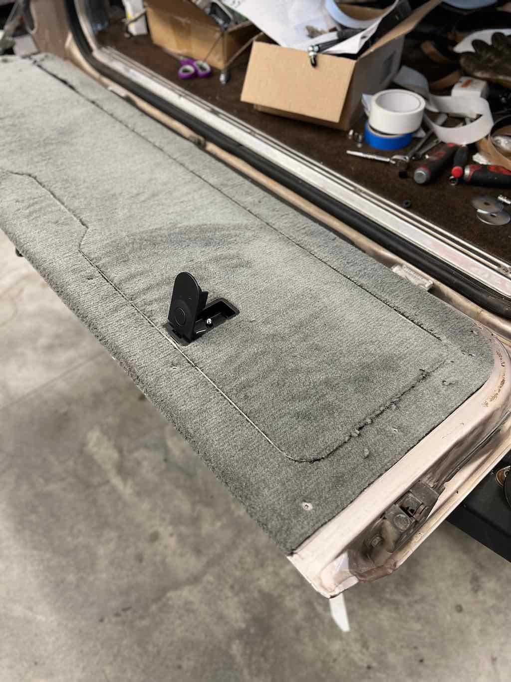

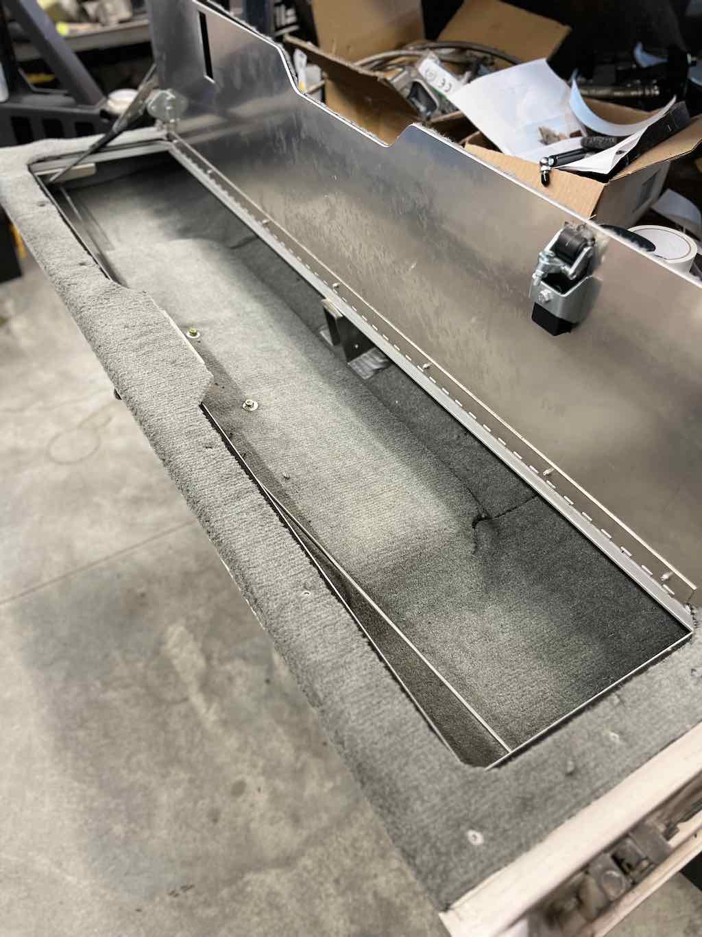

Getting carpet kit dialed now. Have a little tuning up to do on pattern, then off to have test pieces laser cut so the final product is nice and clean/edge sealed. Going to try two ways of dealing with bolt heads. You can see the ratty edges from knife cuts in the pics, the laser cutting should eliminate that.

will there be a non carpet option? Excited to see the final version/s - been holding off for the right one
