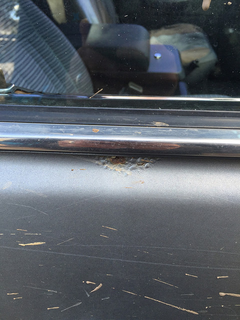

So first order of rust repair will be starting next week as I should officially be out of the boot starting Tuesday.
This spot has been around for about a year now and I want to get it taken care of as there is really nothing else wrong with the door rust wise.
Untitled by Greg Fisicaro, on Flickr
So the question is... how the hell do you get the outer window felt/wiper thing off without breaking anything? I will plan to order new window runs and felts when I get the chance but that is taking more of a back seat at the moment.

As for the door repair, you need to remove the glass, and of course the inner panel, then you can begin to tackle the glass wiper and felt. The chrome and rubber are held together by brittle plastic clips. I was able to break only one of the clips, and learned that wiggling / pulling up the rubber/felt and angling parallel to the glass slot, would remove the wiper, leaving the chrome in the door.
Then I used a long handled flat screwdriver to 'pry' the plastic clip free from the chrome strip...

And with regards to the glass/felt removal... How do you go about removing the glass? I remember trying to do it at one point on the drivers door when I was replacing the regulator but couldn't seem to figure it out... Do you have to rotate it and pull through the window opening or something?
Yes, you do have to rotate and remove upward thru the slot.
The fsm details this.

Thanks @micruz60 I had looked through the manuals once upon a time but did not remember finding anything on the sequence. I will have to take a stab at it when I get a chance. Looks like I will be ordering a new outer felt/run for the passenger as it seem like it is just easier to let it break, plus I want to get rid of the chrome.
Ah so, getting rid of the chrome, how will the exterior felt be secured?
Several pics here, not easy to explain... note that the slots in door skin do not align to slots in chrome strip.... Seems like the friction fit of the chrome piece onto doorskin is what keeps it there.
The rubber / felt strip has an integral metal stabilizer, which is easily bent, so careful with removal. the fsm shows removal with flat blade screwdriver...
hth

Looks like the "new" piece is solid felt/rubber all in one instead of multiple piece chrome and rubber wiper. Based on your pics it seems that if I remember the glass and get in there with a flat blade screwdriver and bend the metal tabs out all should pop off as one? Or am I imagining things?
There are no metal tabs.
The plastic clips have a ridge that secures the rubber/felt, and there is a small bump that snaps into the backside of the slot in the chrome piece. If the replacements are better designed (sounds like it), then you can prolly destroy the originals in removal?
Ah ok... so the plastic clip basically holds onto the rubber and then pops through the chrome strip and then the door to hold everything together. I think I get it. Yeah not going to touch until I get the new outside rubber felt/wiper. Then I don't have to worry about if I destroy the old ones.
You can delete the chrome strips, the rubber just sits lower then before. I'll upload a picture of mine in a second.
